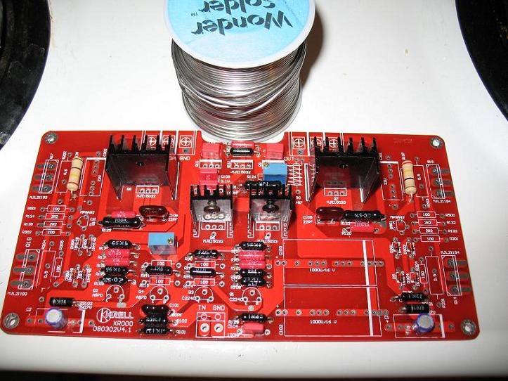

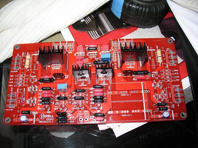

Hello
Slowly I'm getting ready with my new KSA-50 Clone .
I just don't find 2SA970BL all the rest of the parts I have .
Did someone try these board , I'd like it because separate power supply for the input , and for the output .
Of course for the output I'm not going to use 47V I think that is to high for 2pair power transistor .Max 40V that is more than enough .
For the input I will use regulated power supply .The reason I prefer these board because the separate power supply and the power transistors goes direct into the board .
I will see how will work out to me .
Some picture.
Greetings

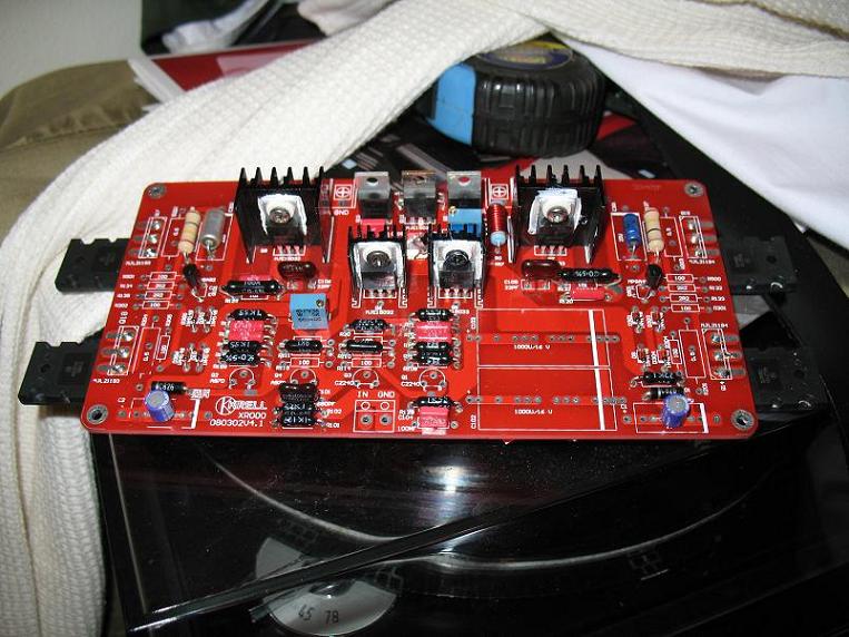

I did some further populating the PC boards .
I just wait from 1000uF Philips axial from UK and emitter resistors from Hong Kong .Unfortunately the normal 5W resistor it doesn't feet into the board .I will use the BOSOZ power supply to drive the font and for the high power I use normal power supply .
One more picture .
Greetings
