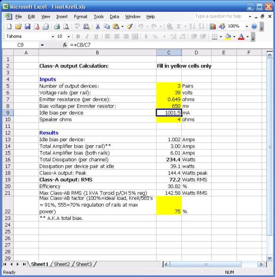

Hey all, quickie question...It appears to me that my Krell Clone has some "room" in the heatsink department. Three pairs of 2SA1943/2SC5200.
If I were to increase the bias to reach a heatsink temp of, say 55C, what would the safe limit be on the output devices, or any of the other components on the board?
I am currently measuring 40 - 45C on the sinks, and the dissipation per device at idle is just under 40 watts...am I near the safe limits on the output devices?
My stats are below...
Thanks!
Thanks!
39 watt dissipation per device is on the higher side.... but your sinks seem hefty enough.... 55c ambient is ok if it stays within 60c at close to full load... close monitoring is needed...
Are you driving 4 ohms?
I am running 4 ohm speakers...
I was wondering if it was worth while pushing the bias a little further as long as I had room in the heatsinks......
I have a few more 2SA1943/2SC5200, so I could add another pair to each side...I would have to look for the resistors tho....

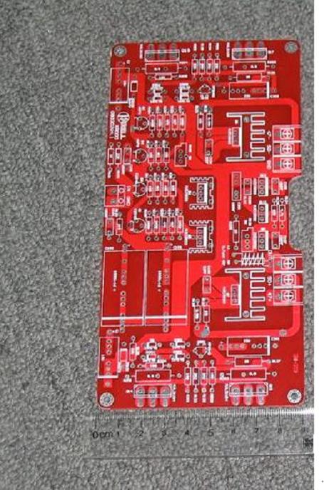

Hello
Eve I sold the amplifier stuffed PC board I decided I still build these amp .
I purchased a pair PC board form Ebay , I think they are great design .
Separate power supply for the input ,The power transistors will be mounted in the PC board directly .
I ordered the PC board , for the input I use regulated power supply .
It only uses two pair out put transistors like the original KSA -50 use the . Like BOSOZ power supp .+/-50V for the input .
I found some rugged transistors so I can bias in a full Class A .
For the main power transformer I use 2x30V AC transformer from Plitron .
Resistor I pick Dale like the original
The power trans use MJL4302A / MJL4281A . These transistors has a great hfE .
Any comment welcome .
I f some one has a Krell badge I would be interested on a par since I gave as a gift to the guy who purchased my stuffed Krell PC boards .
I post a picture from the PC board I will use .
I found is a great advantage id the power transistors goes direct to the PC boards , don't need to use wire to wire them up .
Greetings

Hello
I like these board better than from the group buy .
I already stated for me better if the power transistors goes direct to the PC board
The separate power supply to the fromt annd the back I think is a great idea .
Thirdly I already paid for the boards .
So I have to stick with them .
Greetings

john65b said:I am running 4 ohm speakers...
It might be a sonic trade-off..... from a reliability standpoint, adding another pair ought to do it.... but the more pairs you have the more they need matching...
Technically both are feasible, it would depend if you can make out the sound of the extra biasing/heat... personal choice.
Some of the nicest sounding amps have 1 pair in the output.... said to reduce smear 🙂
Hmm...maybe best to leave it be and just build another. I have a couple more board pairs and most all parts...including chassis...
I read that NP likes to keep his output devices below 20 -30 watts for reliability reasons...
True, But Pass is selling amps that he will repair at his expense for 20+ years.
He's often said that for DIY use you can push it a bit harder if you are willing to live with potentially shorter parts life. He's also using mosfets that hard, bipolars may not be so forgiving at elevated die temperatures. Will this be a 20 year amp or replaced in the next few?
Run through the die temp calculation and see how much room you have. Most outputs can handle 150 C die temps, For commercial products NP keeps it down to 100 C. Remember that SOA is reduced at elevated temperatures. Aluminum oxide or Kapton isolators have lower thermal resistance than mca or silpads so you can run more power on the same heat sinks with them.
aluminium oxide is about 50 to 100 times thicker than any of the other isolators.
Try to find 0.001 to 0.0015inch thick Kapton tape and preferably with glue <0.002inch.
