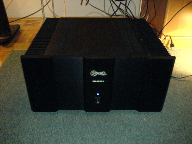

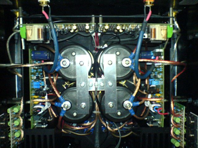

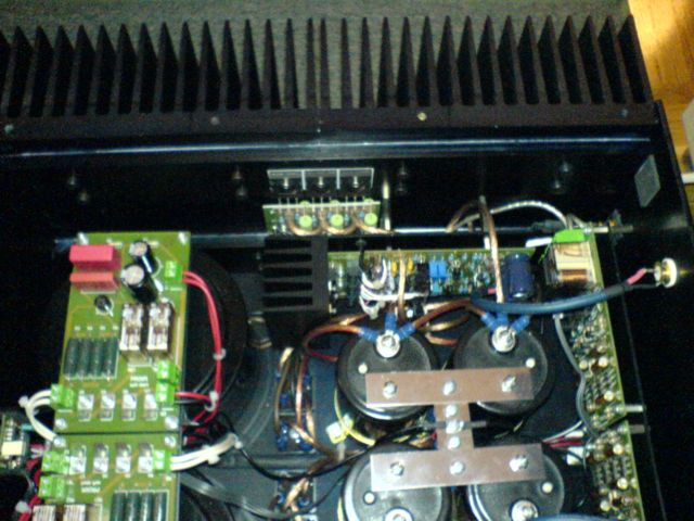

I picked up this chassis a few months ago...pretty banged up, but was relatively cheap. Chassis came only with Power Supply Board/Caps.
Power Supply - four 68,000uF @ 100VDC Philips caps with four 35A Rectifiers...Have no need for the Power Supply, as my rails are just under 40VDC..(for sale if anyone is interested)
Here for more info on the Power Supply...

Anyway, still haven't decided what I will do to the chassis. Powder coat? Sandblast entire chassis? She is pretty banged up...TONS on room inside. As far as heatsinking capability, if good for a KSA300, maybe .05 C/W??
TOP VIEW
SIDE VIEW - note the scratches...
BACK VIEW - I have the other Binding Post - just not on the chassis
FRONT VIEW - The Starter board (?) was not included - just have a clear window...
CURRENT KSA-50 CHASSIS - thanks again Stuart!
The amp is on a rolling flower pot holder from Menards I bought for $6. Works great for moving around amps.

what is KSA300?
This Krell chassis will not do more than KSA100 dissipation (100W + 100W in ClassA). It might even get too hot for that.
The sinks on the KSA300 are at least double the length of a KSA100. If you look at a top view of a KSA100 you will see what I mean.
