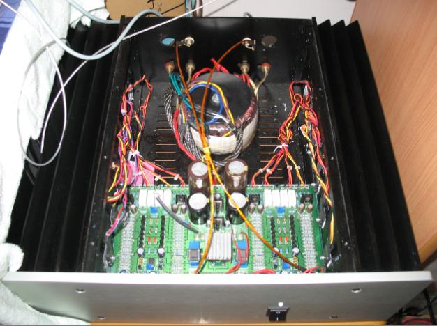

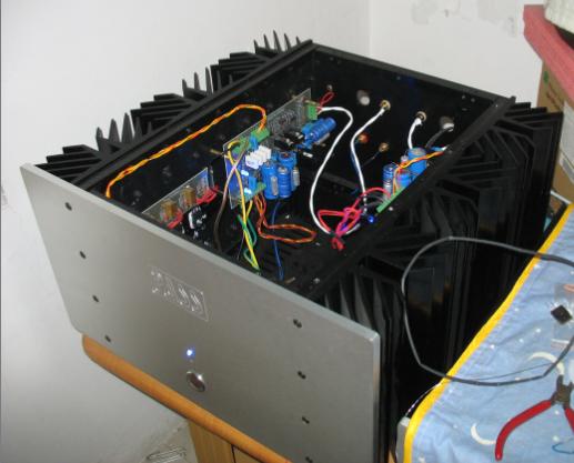

My heat sink enough to ksa50?
First Thanks evrybody helping me!
And I want to confirm that my heat sink enough to ksa52 or not?
The heat sink show following picture:
image 1 is 45kg ,i using for PASS ALEHP5(550mA per driver *3drivers)
image 2 is 15kg, i using for a small class A amp. 500mA*2drivers.
which would enough better to use for ksa50?
I have another idea that use fan to heat output, it can make heat sink smaller?😀 ,this better idea?

Aleph 5...
To add to Andrews comments:
If the Amp you show in the first picture really is an Aleph5 clone, ie 2 x 60w RMS, then the heatsinks, transformer, rectifier and caps are a good fit for a KSA50.
I've built and swapped between a pair of otherwise very similar amps. They have quite different voices, and depending on your speakers etc, if you like one you may not like the other.
symmetrical output? Not 100% sure I know what you mean. By default it is not a bridged amp. The output of the KSA50 comprises 2 or more complementary pairs of BJTs ie PNP/NPN. I'm sure the circuit could be modified to be quasi- complementary, but AFAIK no-one has tried it.
HTH

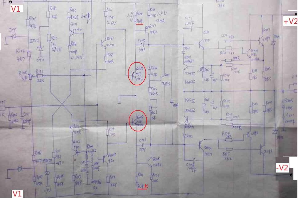

The MJE15032/33 can instead of MPSA42/92?
I see some SCH of chinese useing that i show bellow the image 1.
The MJE15032/15033 instead of MPSA42/92(Q103/104),and without change any value of resistance.
You have somebody try to it, it is true? It is feasible??
Because I easy to buy MJE15032/15033,but difficulty to buy MPSA42/92,
1. So if MJE15032/33 can instead of MPSA42/92, I want to use the MJE15032/33.
(But I don't know it is instead of MPSA42/92 feasible???)
. Follow the image 1:
I label the supply voltage on the image 1 ,(the voltage of pre_amplifier and the voltage of power_amplifier )
2. How many volts of that two supply voltage,(i see somebody use +/-48v,)
3. The two voltage supply alone or supply togerther??

Zen,
download the datasheets for these transistors.
Don't bother reading them just look at the picture of the devices.
Are they different?
Could they be equivalent?
Any five year could answer this!

Zeng,
a Beta-enhanced-Vas is nice, but done with two 50W MJE devices is as unwise as it gets.
If you need anything for the KSA50 you can't get overthere, just mail me and i'll send some junk to China.
