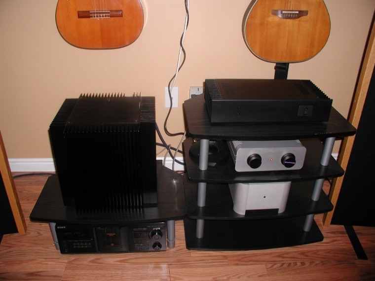

So now that I have the DC offset fixed and grounding scheme all squared away, I finally had some time to do some critical listening.
I find it hard to believe this is only a 50 - 70 wpc amp. Seems to have more punch at loud volumes than my UCD400 does. Must be that monster 1350VA transformer?
Anyway, hard to objectify the sound , but sounds very clear, fast, and snappy. Quite impressed. Best I have heard on my Maggies.
I have more output devices and was thinking of adding another pair of 2SA1943/2SC5200 to the 3 pair setup I have to increase output power another 20wpc (I have plenty of heatsink and VA, so I was going to keep bias up to existing 630mv), but don't know if I should really bother...
A pic of the Krell is below - the big heasink box on left -
The preamp on the mid-right is my 5687 tube Audio Note M7 (PCB off ebay) I built that sounds very nice...LED Bias, tons of mods to get her quiet (DC on filaments, CLCR power supply filter), but very happy with it now...
The amp on the top right is a UCD400AD and the silver amp on the lower shelf is another UCD400AD (my old reference amp in a Hexateq chassis). I was thinking of BI-amping the maggies with the two UCD amps - I might just sell them off now....

Well done, I'm glad you like it. Got rid of the hum problem?
Hum is gone. Very clean sounding now.
Didn't quite sound right when I had the Signal Ground tripped up - knew something wasn't quite right...too bad it took me a week to figure it out

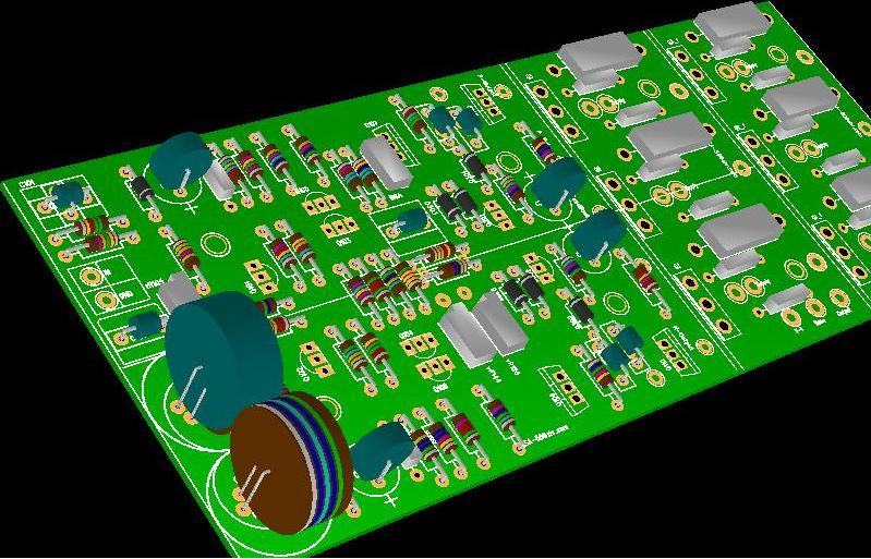

Let me see if I can help
so how you want to go about KSA 50 ?
do you need ready PCB, or need help in making PCB yourself.
Do you have Gerber or schematics ?
-suds
-suds
