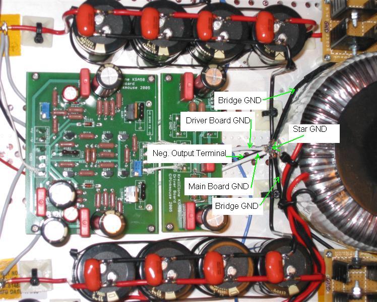

Perhaps this is a very basic question, but I was wondering where I should connect the input ground; should it be on the main board, or should it go straight to the star ground?
Thanks.
Paul

Hi Joey,
there's a pin location labelled right next to the signal input (below 1 of input1).
There are two other adjacent ground pins.
The next one (below N of input1) goes to central star ground and the third one (way out to the left), next to -V, goes to power ground.
Hope this is clearly explained.
Edit:- I never asked which board you have, I am referring above to the later Pinkmouse 2005 PCB

Hi Andrew,
I am using the Pinkmouse boards.
I attached a picture with the way I set the grounds, but it seems that I am completely confused, since I only have a star ground for everything. Should the power ground (the one from the 2 bridges?) be separate from the star ground?
Thanks.
Paul

Hi Joey
Well, in principle that looks fine, but could you post a photo just to confirm exactly how you are fixing them? Small errors in arrangement can make a big difference.

caps...
The prevailing wisdom seems to be that the terminals from the caps should be joined to each other with something substantial and a feed taken from the centre of that to the starground.
Basically because it was easy, I used a large aluminum plate that had a cap terminal at each corner and a bolt in the centre of on edge as the star ground. As a useful side effect it also acted as a heatsink for the rectifiers.
Stuart
Stuart
Hi Pinkmouse,
I attached a photo of the ground connections. All the grounds are soldered onto a copper wire that runs from the negative rail caps all the way to the positive rail caps, and has a sort of little loop right in the middle where all the GNDs are connected.
I had thought of what you suggest Stuart, but the caps I am using have tabs, so it would have been hard to solder them well onto a metal plate. The choices were to either use a homemade PCB, or use wire.
Paul
Paul
How about taking a feed from the middle of the 3rd and 4th Caps to the star ground instead of taking it from the ends on the bank (i.e. first cap)
Hi Joey
Well, I would plug it in, fire it up, and see if you have anything to worry about first!
If you do, this is what I would do:
Drill a hole in the bottom of the chassis where your star ground is now. Crimp on eyelet connectors on to all your wires. Stick an M4, (or whatever your local equivalent) machine screw through and using locking nuts and star washers attach your mains input ground to it. Once tight, put some nut locking compound on so it never moves again. Put your connections on in this order, with star washers in between, PSU grounds, bridge grounds, speaker grounds, driver board ground, main board power ground, main board signal ground.
Does that make sense?
