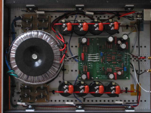

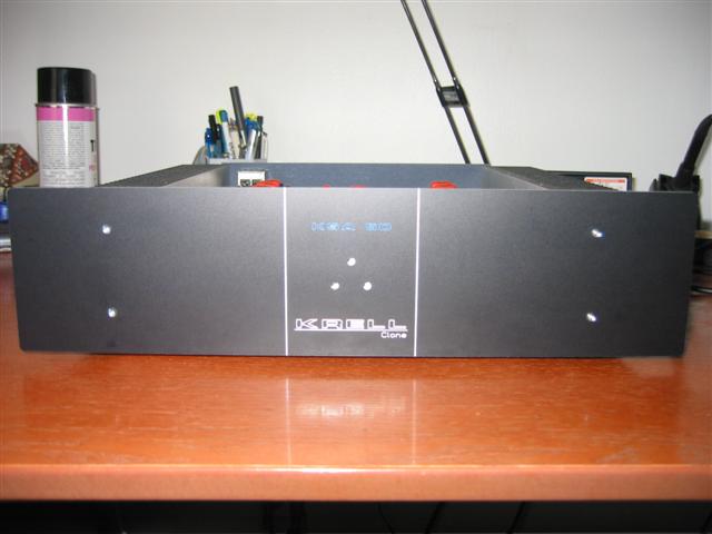

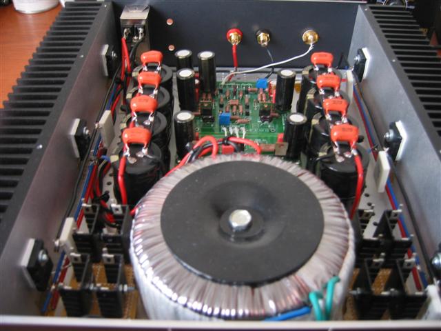

I have finished (well, almost) one of my 2 KSA-50 monoblocks. I didn't plug it in, since I am still missing the driver board heatsink, and I am not sure if the signal ground should go to the amplifier board, or straight to the star ground.
Here are some pics of the KSA-50:
Paul
Paul

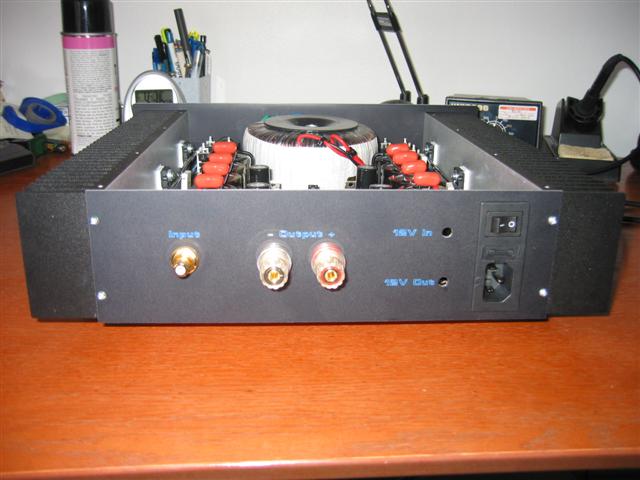

And finally, this is the back, also done by Front Panel Express. The two empty holes are meant for 1/8 jacks for a trigger input and an output, but that will only be done after I get it powered up.
If anyone sees anything that looks wrong, please let me know.
Thanks.
Paul
Thanks.
Paul
Great work Paul! Why not just mount your drivers and bias sense to the bottom of the chassis?? The chassis is PLENTY of heat sinking for them. Solder them to the driver board so they come down from the bottom of the PCB and towards the edge of the PCB. This way you have access to the mounting holes in the devices.
Mark
Mark

Thanks Mark.
The drivers mounting you suggest is a good idea, I just wasn't sure if I would have enough heat dissipation. I'll take the driver board out tonight, and mount them the way you suggest.
That should also avoid the headache of adding another heatsink in that tiny space 🙂
Paul
Paul

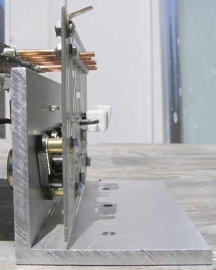

MJ15003/4-To 3 mounting idea:
Hi folks
I thought it could be interesting to some of you to share an idea for how to mount To-3 devices on heat sink for to not get a to small internal space inside amp. for transformer, caps and driver boards.
I should appreciate any comments what so ever to this issue.
Regards 😎
Hi folks
Regards 😎

Hi Flod,
try a 50 by 50 by 6mm aluminium angle.
Mount one face with bolts and heatsink compound to the heatsink. The other face can be fixed as your pdf showed to the PCB and To3 inserted from the other side.
