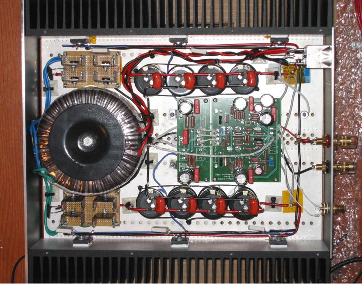

I have fully finished one of the monoblocks, and fired it up (wearing protective gear of course 😀 ). I followed the steps for biasing on the wiki, after I made sure everything was in order, and everything worked perfectly.
As for the grounding, I took Pinkmouse's advice to first fire up the amp and see if anything is amiss with the grounding. With the input shorted, there was no noise or hum whatsoever coming from the test speaker, so I am assuming that everything is ok with the grounds. I greatly appreciate all of your help, and for my next 2 KSA-50, I will definitely apply the better grounding scheme you guys suggested.
Now, time to finish the second monoblock so I can finally hear them sing.

Yup, those are Conrad heat sinks (MF35-75).
For the case, I drilled the heat sinks, tapped the holes, and then the front. back, top and bottom are screwed to the heat sink's base. The top and bottom are aluminum pieces from old telecom base-stations panels, and the front and back panels were done by Front Panel Express.
Paul

Hi Joey,
the nfb is connected between the driver board and the voltamp board.
Instead take the nfb from the output rail to the voltamp board and remove the FB link.
Referring again to your pic, I cannot see a link from the output side of the driver board FB to the output rail. Is it hidden or omitted or am I blind?
So, you need two FB links from the output rail, one to the driver board and a second one to the voltamp board.
Those conrads look adequate, can you confirm output Iq and sink temperature?
You're pretty tidy with the wiring and neat layout. Can I assume you deliberately chose to separate the mains incomer from the input RCA? is that coax or plain on the RCA? Could you measure the mVac at the output with the input shorted and open circuit?

Hi Andrew,
The link between the output rail and driver board FB passes under the PCBs, but you can see it emerging right at the positive output terminal (it's the little red wire). So I have a little wire link between the main board and driver board, and then another link to the output from the driver board.
With and Iq of about 588mA per device, the heat sinks seem ok; with the amp running for about 20 minutes without any input, I am able to touch both heat sinks without any pain, but it's not far from it, so I'm estimating the temp to about 45-50C. I'll try to get a more accurate value tonight.
Thanks. Yes, I tried to keep the incoming AC far from the input. From the RCA connector to the main board input, there are two plain silver wires.
As for the mVac at the output, with the input shorted, I get 0.4 mVac, and with it open, I get 2 mVac. When I checked the Vdc, I got 8 mVdc with it shorted, and 207 mVdc with it open. Is that normal?

Thanks Joey,
that 207mVdc output offset when input is open may be a problem when using a DC blocked output from a pre-amp.
The KSA will see an open circuit due to the cap at the output and leave you with that offset.
Do any others have similar readings?
It may be that once you have the system connected up that you zero out the offset with the pre-amp connected.
That 0.4mV is -94db relative to full power. I was hoping it would be better. Is this normal?

Paul, twist both input wires together ( at full fart ) .... 😎 - now is area of input loop too large and it capture hum...
