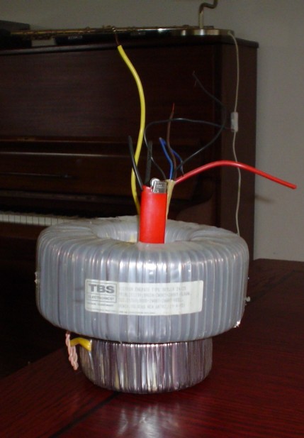

Mark A. Gulbrandsen said:It turns out that this transformer is a 1.240 kva unit...
Mark
Don't I feel real stupid....! I already had a couple of 1kva's lying around...
Mark is your 1250va based on the schematic's 80C rise at that level?
Yes, I believe that is correct since you need to go by the rating at the specified rise temp.

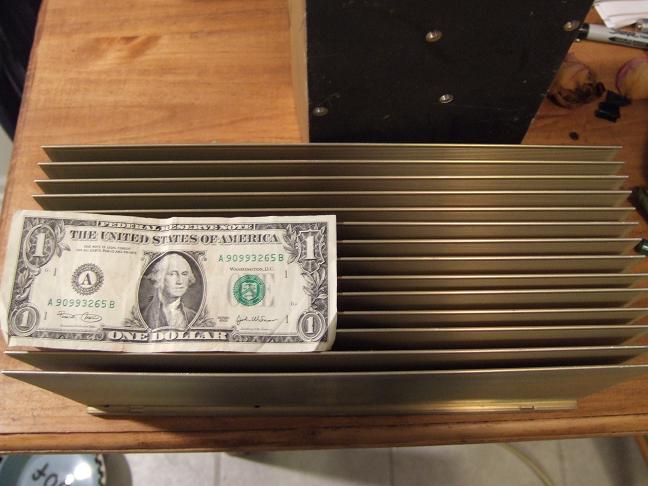

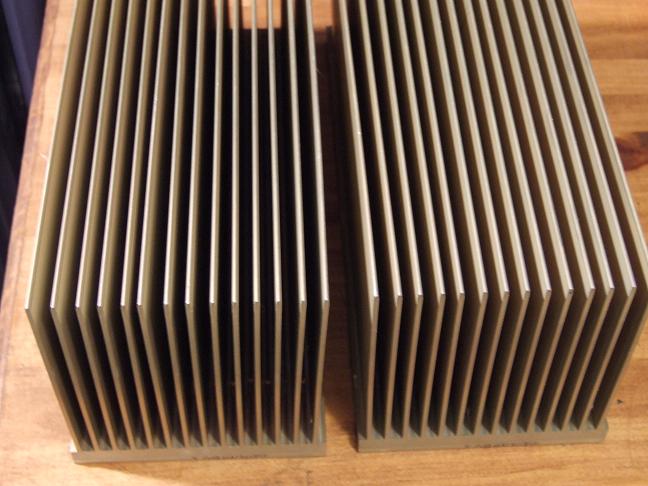

The sinks are 12x5x5 ribbed fins. I have the heatsink calc spreadsheet, it doesn't account for ribs or for fin shape. I believe the assumption of the calculations are that the fins have a triangular profile - which my logic leads me to believe would disperse heat a bit more evenly than the "flat" fins that I have. Lots of math to take in to account- I may just hook it up and monitor temperature as I raise bias to determine if they can take the heat.
~Brad

here's a pic of one of four 1.8KVA toroids i collected for a Pass clone. Dual secondaries, 36Vac, 25 amps. Made for ship to shore powersupplies, overhere anything above 1 KVA is custom order and pricy.
www.Victronenergy.com
Also managed to collect 4 of their 3.6KVA 115 to 230 toroid isolation transformers when the Pass Monster thread started. Still need to figure out what i'll do with the 4 chassis, they are huge. Older series, weigh 120lbs each, cost me $200 for all 4. I just love hauling junk with my Chevy.
www.victronenergy.com/upload/documents/Datasheet-UK-Isolationtransformer.pdf

Hi Googler,
You mentioned cutting the sinks in half to give 6*5*5.
If you stack them side by side giving 6*10*5 they will dissapate about 40% more heat than uncut.
10inch on opposite sides of a case should leave room to build your 2channel inside.
Someone was asking about transistor placement for best efficiency.
If one only, place it in the middle but drop it down slightly below centre line. i.e. about 40 to 45% up from the bottom.
If placing two or more side by side then again 40% up from bottom but the spacing should try to ensure that the side to side gaps to edge and to the midpoint between TRs should be equal i.e. for 3TRs 17% from edge then 33% to next & 33% to third and finally 17% to edge.
If placing two or more rows stacked above each other, then the spacing becomes a little more complicated.
Basically the problem you are trying to overcome is that warm air passing up through the lower part of the sink does not cool the upper part of the sink as well. So this forces the upper sink to run hotter than the lower. To compensate for this the upper row of TRs need extra area compared to the lower rows.
I suggest you try for 20% to 25% up for lowest row, 40% up for middle row and 65% for third row

Hi Googler,
I would suggest that you assume it to be geometric centre. But almost as accurate (sufficiently accurate) would be the tapped fixing hole locations. Just scribe out your layout, drill, tap and then fix in position.
Reminder:- the baseplate thickness fixes the maximum spread of heat along the sink. Efficient spread <=10 times thickness. Similarly for fin thickness :- fin height (at right angles to plane of base plate) <=10 times fin root thickness and fin taper should be less than 3 to 1. So your 4.5inch high fins should be 0.45 thick at the root or you lose some efficiency. I don't know how much (you were about to ask weren't you?).

I will have to measure the base plate thickness tonight when I get home. If it is less than .45inches, would I be better off using more transistors to distribute heat accross the base?
This also brings up another question - Does increasing the number of output transistors require changing the emiiter resistor values?
Thanks,
Brad
