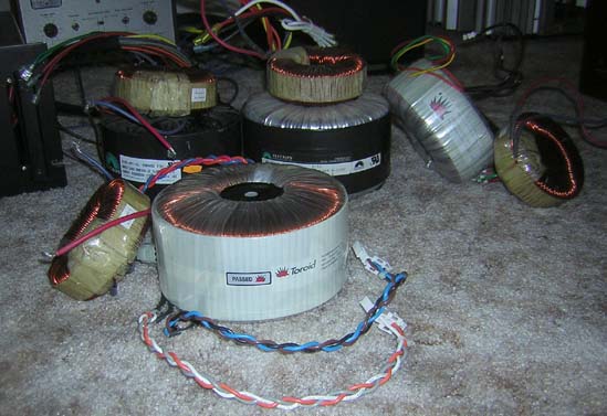

On the picture it looks like a nice quality toroid, the windings look neat and tight. Great deal, i'm not gonna tell what such a donut costs overhere, or you'll be posting 2 KVA toroid pictures for a decade.

That thingie is made by former norwegian/swedish co. Transduktor/Ulveco, now Toroid!
The hedgehog logo is still the same as 25 years ago!

Got 2x550VA myself, quality stuff those Transduktors!That thingie is made by former norwegian/swedish co. Transduktor/Ulveco, now Toroid!

So I got this 2 KVA toroid sitting here and no idea what the color code on the leads means. I certainly DON"T want to damage this baby!
This is obviously a dual primary/dual secondary transformer. One set of leads is black, brown, and blue. Another set is white,gray, and orange. I assume these are the primary leads as they are also smaller guage wire. The other two pairs of leads are color coded both the same.... red,orange, and blue and are easily twice the guage of wire.
Can I assume the below statement....?
That the primary 120 volt leads are the black and brown and orange and white? The 100 volt taps are the blue and gray?
That the center tap on the secondaries are the blue leads and that the red and orange are the secondary windings on each side of the center tap(blue wire?)?

Mark A. Gulbrandsen said:So I got this 2 KVA toroid sitting here and no idea what the color code on the leads means. I certainly DON"T want to damage this baby!

orange and brown were 107 volt colors back when I was an electrician...
My guess is:
white and black are 117V
orange and brown are 100V
and blue / gray 220V
HOWEVER:
white(Neutal) and black(hot) are current US standards for 117V Blue(neutral) and Brown(hot) are current UK standards fo 220V
So your guess is as good as mine. You can use an Ohm meter to find the matching ends and then the highest resistance coil should be the highest voltage.. BIG assumption there... 🙂

It turns out that this transformer is a 1.240 kva unit... still much larger than the seperate 400 va units that were used in the original KSA-50's but not 2KVA as advertised.
Got mine in and running just fine with the help of that spec sheet from Googler. Sound quality to me is much better than it was with the 400 VA units... especially the bottom end. I ended up with +/- 38 volts under load... I ran each primary's hot lead through a CL-60 inrush limiter to keep the fuses behaving. With out the CL-60's the voltage would probably be about +/-39 volts DC.
