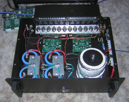

On a different note here is a photo of the insides of my finished KSA-50 Klone..... Some may cringe at the common TO-3 mounting rail..... but so far so good. Thermal tracking with the dual fans running is actually quite good.
Mark
Mark
Mark,
very clever to place the vented duct behind the chassis. This corner still is a great source for ideas.
I cringe at the sight of a finished chassis.
😱 That looks much more than a 50 watter!

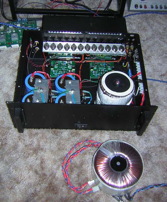

Mark A. Gulbrandsen said:The stacked 400 VA trannies will be replaced by this massive(surplus) Bel-Canto 2KVA tranny...hopefully this week.
Mark
I got my 2kva tranny in as well. Are you planning on leaving the the stock connectors on yours?
I haven't decided whether to buy the female connectors to plug in or snip off the stock ones and solder directly.
Is that power switch on the front functional?
Bad Boy! Never send that link to a Toroid Junkie....
Hey Jacco, Look what I am getting.
😀 TY Googly!
😀 TY Googly!
I will cut mine off and use my typical Crimp on female spade lugs, (I also solder them as well) that slide directly onto the tabs of the bridge rectifier. I use a central grounding point between the two main caps as my star ground point and the center taps are placed there. Its a VERY nuce toroid... easily a $300.00 tranny. I think they were made by Toroid Corp Of Maryland.
