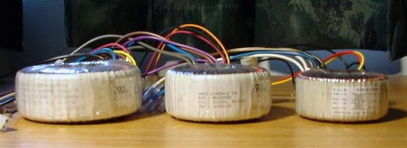

Zang's reg boards and this toroid from Steve @ apex.jr:
Avel-Lindberg Inc
Input: 2 X 120Vac 50-60Hz 3 1/4" Dia X 1 1/2" Tall
Output: 2 X 25V @ 2 Amps 100Va $17.95ea
Middle in the picture.. Although I have all 3... I might use the large....
Avel-Lindberg Inc

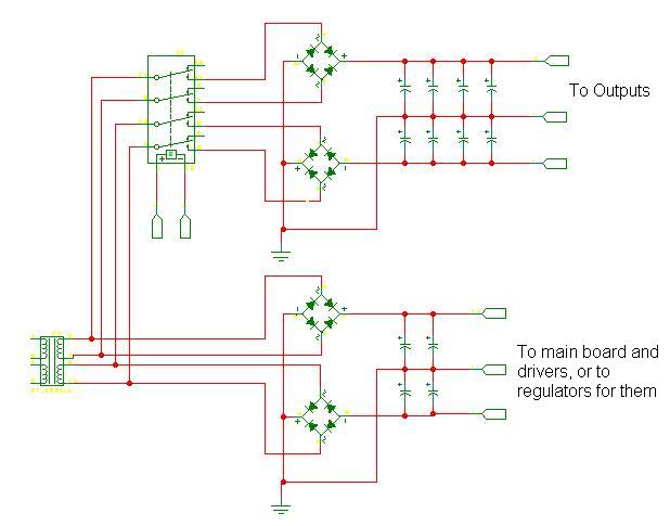

I have attached a schema of what I would like to do for the PSU (mainly what Pinkmouse suggested on page 434). From what I understood, I won't get the benefit of a greater headroom since the voltage is the same for drivers and outputs, but it would enable me to have the "always on" front end without the outputs, and I would also be able to add regulated voltage to the front end which does sound beneficial. My question is, would this work if the relay was to be powered only when the amp would be in use?
And thank you for pointing me to the discussion GeWa. Have you applied the idea in your amp?
Paul

JoeyDD said:would this work if the relay was to be powered only when the amp would be in use?
How long would you like this to work ?
Such a relay should be pretty fancy, is my guess.
For some time, but it can be 4 single relays, or a switch instead of that quad. Would there be any long term problems?
Paul
A relay on the primaries or the secondaries of a transformer makes quite a difference.
If the bias setting of the amplifier remains unchanged there would be very high currents going through the relay contacts because the capacitors will be totally empty.
Bare in mind that with a single PS the front end of the amplifier acts as a soft starter.
With the front end working 100%, the output devices will be fully open when you hit the relay switch.
You would need some kind of softstart circuit for the output stage, and heavy duty relays.
