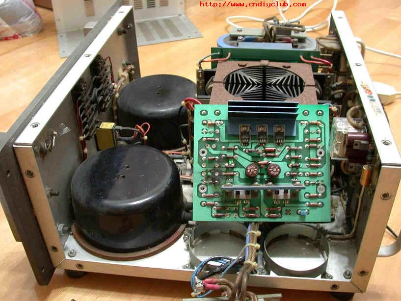

Krell KSA 50 PCB

ksa50 MKII pcb
look

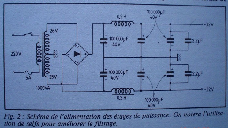

I tend to agree with Bratislav that there is less to be gained by separating powersupplies and/or using regulation on a class A amplifier with a high bias and a very sturdy powersupply that is able to keep voltage ripple low.
AmpGuru is also right in the Ball-park that designs needing to rely on heavy powersupplies for PSRR reasons are poorish designed.
If the lord humungous amplifier Bratislav posted keeps ripple low without a entry signal, fully driven the powersupply has an easier job.
But i don't think most of the Krell builders here are building derated KSA200s. A number of them do not intend to run their KSA50 in full bias, and the original KSA50 wasn't.

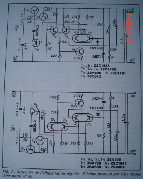

My bias target is 7 amps, even with a CLC the voltage ripple will not be pretty. The ripple on the output stage is not a concern, by using separate powersupplies the front end will be totally independant of the bias level.
With exception of a few like Jacques Mahul's, the gorgeous loudspeaker systems i've seen and heard over the last decennia need to rely on very chunky amplifiers.
It's a shame the French L'Audiophile(Jean Hiraga) magazine was never published in English. That published the first regulator circuits in the late 70s, the regulator of the Japanese gentleman Akihito Kaneda was the official first i believe. The magazine published a lot of class A designs, some 15 years ago even fully regulated ones( By the mystery designer Hephaistos).
All those designs used CLC, CRC, huge transformer and capacitor banks from the start.

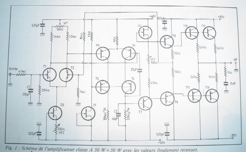

Here's looking at you kid, 50 watts class A, separate powersupplies with front end regulation (1988):
