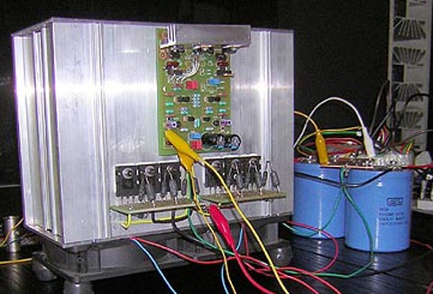

Leave plenty of room in the enclosure for future upgrades, and the parts cost for 1 channel WITHOUT the final output devices is around 40 bucks. That is with Dale resistors and low inductance / ESR electrolytic caps, Wima, AVX(?) and Silver Mica caps.
1. Tranformer ~ $60-80 online bargain shopping
2. Heat sinks and case ~ $10-1,000 depending on your WAF requirements
3. 2 PCB's and parts ~ $75-100
4. Wire, RCA's, binding posts, IEC A/C input, Fuse holder, pwr switch and such ~ $15-20 bucks from Steve @ APEX.jr (Plug for a good supplier, NO affiliation, just habitual customer) If I were a junkie he'd be my pusher.
5. TIME! That is the biggest cost for "most" builders.
Audiophile approved parts. Dan would be proud. 🙄
I would like to build one up to "reference" standards and compare it directly to the original.
Use 2 - 12 volt DC ball bearing fans and run them at about 4 to 6 volts. Place two flat back heat sinks with at least 2" fins.... fin to fin and blow up through them. 2 fans running that slow still move alot of air and they are really quiet.
Now I have taken all this apart and am placing three output devices per sink (one pair of sinks per monoblock) to see if I can keep dissipation under control WITHOUT any fans...... I need to space the output devices alot further apart than they are on Jan's boards to get this to work though......

Mark, thanks for stepping in here so I know who "Mark" is...but after a little more reading, I think the future UCD700 modules might be a little more up my alley as the Dynaudio's tend to be a little power hungry. One of my first concerns was low-efficiency of such a design such as the Krell-kopy 🙂p) and the corresponding low power output.
Thanks again, but it looks like Hypex for me...that or I just buy a damn Proceed and quit all this speculating. 😛
Actually the KSA-50's drive my Dynaudio Audience 9's to window rattling levels. The 9's are 89db@1 watt...... Not real efficient!!
Don't forget the KSA-50 does 50 watts RMS into 8 ohms pure class A then goes Class AB to about 75 watts which is the clip point of the stock unit... so its not such a small amp after all. Double those specs into 4 ohms with an adaquate power supply.

Hi guys,
I was thinking about the soft-start/thermistor for the power supply, when I realized that I somehow ordered the wrong thermistors; I ordered CL-30 instead of CL-60. From what I understand, the difference will be that at startup, I will have 2.5 ohms instead of 10 ohms after the bridge, and after startup, I will have a higher resistance for the CL-30 compared to the CL-60, due to the CL-30's higher max current, therefore getting a smaller increase in the voltage drop across it. Is my understanding correct? Would there be any problem using the CL-30?
And while I'm on the PSU topic, I seem to remember that someone came up with an idea (I'm not sure who, and for that I apologize, but I couldn't find it again in this thread) to always keep the power on for the main board and drivers, but only apply power to the outputs when the amp is in use (through a switch or a triggered relay). I don't remember if there was any final "verdict" on this idea, hence my question now: would something like that work? It would allow keeping the amp on a sort of stand-by where the outputs wouldn't consume anything.
Paul
Paul,
that would be me.
It works, there have even been commercial amplifiers with that option + option to switch to different bias settings.
The advantage of keeping the front end always online is the greatly reduced warm-up time as it's the little guys that need most time to reach equilibrium.
Compared to amplifiers running on a low bias setting this approach extends the lifespan of the big capacitors, the ones which are costly to replace.
And overall life expectancy of the front end is longer, with exception of the small capacitors.
Requirement however, is having separate powersupplies.
Currents in the front end are in the mA range, and losses in small transformers are low, the cost of running the front end always online would even keep AmpGuru off your back.
On three class A amplifier homebuilds i've done the added switch thing, all three mosfet designs so the separate powersupplies were already there.
Another advantage is the possibility of switching loudspeaker cables with the main amplifier still on, other commercial designs had a mute switch for switching off output relays.
And sometimes it is handy for measuring.

I've just done the scope stuff on the front end boards, and heard one front and driver board through a headphone, so far so good.
