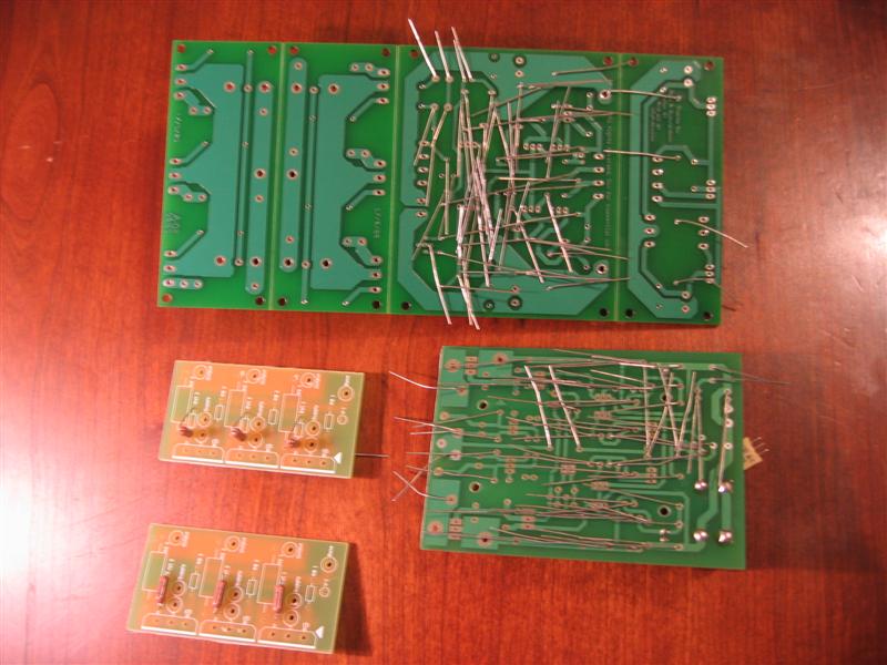

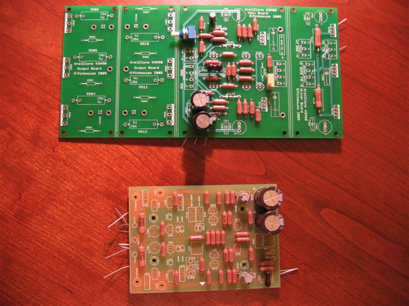

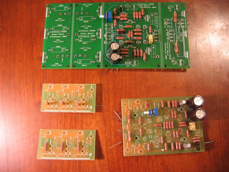

Ok I will jot down the differences here while they are fresh then add them to the wiki.
***Fix the traces on your Jan board before you start!!!***
It makes reviewing easier if the leads of the resistors are bend with the value facing up. In other words mount the resistors "value up" so you can check the value later since there are no bands. You should be able to read something like "3321F(3.3K), 1501F(1.5K) or 9101F(9.1K)" or such. I will list the dale values and part numbers on the wiki.
All Jan's "box" caps are 5mm pitch. (THANKS Jan!)
Al's are 3 different sizes. 😕
**Carefully!** Jan's resistors bend right at the body and look nice
Good luck bending the leads for Al's uniformly to "look" good.
As you can see I'm picking on Al, but in reality both boards are just as easy to assemble, but Al's is harder to order for. I will add my BOM to the Wiki, which fixes the mistakes in his.
On both boards mount the components in the following order for the most ease.
1. Diodes
2. Resistors
3. Pots
4. Small caps
5. Large Elctylc caps
then the more delicate transistors.
Lastly, GeWa, thanks a MILLION for having the Wiki URL in your signature as I used it as a reference every time I worked on this from a different PC!
That's enough for this weekend. I spent the last two days going over these orders again. Fortunately, because I found SEVERAL things (that wouldn't work) in the BOM I posted t and asked everyone to review!..
