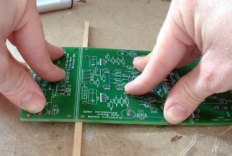

Well as the first part of the builders guide I promised, here is a pic showing the best way I have found of splitting the boards up. Push on one side, then repeat on the other, and the boards will snap cleanly. Much less fuss than saws or knives.

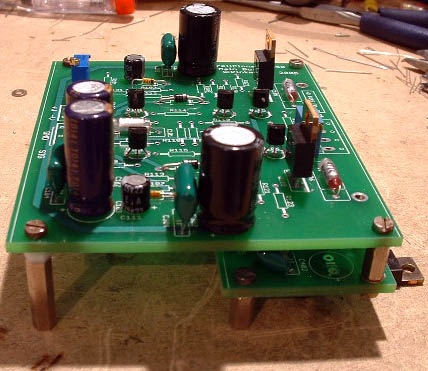

However, before you break the main and driver, boards, it's worth thinking about your physical layout.
Here's how mine will be laid out...Still not sure if I should wait for the Parts GB for the resistors... 😉

Pinky,
how about supporting all four corners of the driver board?

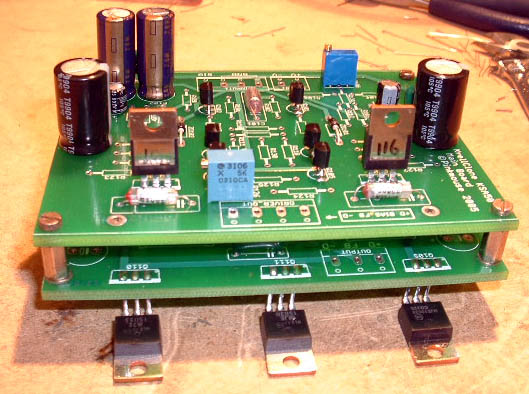

Al. I noticed you didn't use the 2SC3955 for Q111. What was the reason for that and what did you use? I suppose it doesn't matter now since I already have the parts but I had to go to another source for those and that added to my shipping. 🙁
I didn't mount the drivers or Q111 like you did, I mounted them straight up figuring to use a common heatsink for them and get the thermal tracking that way. Has anyone tried that yet? It was mentioned earlier in the thread. I thought about doing it the way you have and may change it. I am still trying to figure out how to work the heatsinks. I would like to have everything on the main heatsinks.

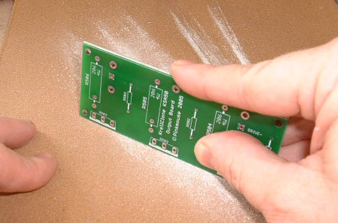

This will probably sound silly but I thought I'd share the way I snapped the boards. Here goes.
When the door to my studio is closed there is just enough room to slide the board between the door and the jamb. I simply slid the end of the board that needed to be removed into the gap between them and pushed sideways on the board. Snaps it off very easily and the wood door/jamb is soft enough to not harm the board in any way. Just thought I would pass that on.
Note: You don't have to have a studio, just about any door will do. 😉

I used another 15032, (but I have also used 15030 with no problems), for Q111. The 2SCs were impossible to get in the UK in quantities of less than 500. As for the resistors, I picked a pin spacing that would cope with most types of resistor, yet without using up too much space on the board. Be greatful I didn't chose those subminature ones that some other people like! 🙂
