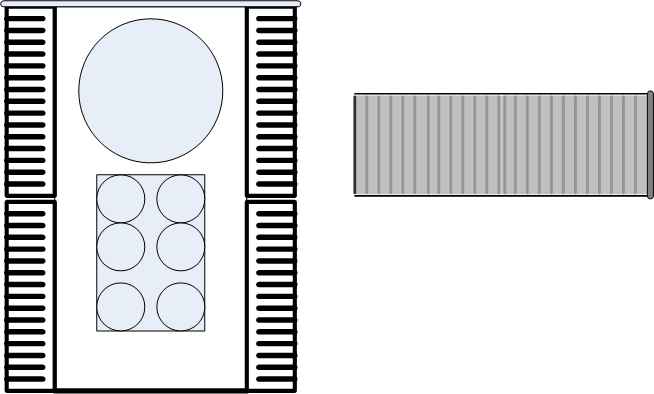

Hi All-
I know I asked this before, but now I'm putting out money so I want to double check.
How long does this extrusion have to be to support 1 channel? That is both the +V AND - V sides.
http://www.mmmetals.com/extrusions/drawings/mm10332.jpg
Extrusion Part Number = MM10332
Width = 8.350
Height = 2.000
Base Thickness = 0.250
Weight = 5.906
Rq oC/W = 1.0
Surface Area (sq"/1") = 57.648
I would like to just use 1 heat sink per side, but will use 2 if REQUIRED. the amp will be 8 inches tall.
I have some 16" long x 8" wide sections of these and will have them cut into 8" x 8" squares and place 2 per side and make the following style chassis. I will have 4-5 of the chassis made if anyone is intrested in one. I will see if I can post the pictures of my last chassis I had made for my little GC..

rabstg said:Hi All-
Let me be the 1st to say that I'm interested in one of those. When you get the final dimensions down, please post. Also, it looks like from the prior one your heat sinks match very nicely so can you include them?
Cant wait to see some of these other amps.

Well first of all I need to find out how long the extrusion needs to be to support a single channel ofthe KSA-50 clone.
I would like the amp to produce the full 50 watts in class-A into 8 ohms.
May I ask if you are using fans?
I asked a couple of days ago about my heatsinks which are 8" x 12 1/2" and was told that they wouldn't be close to being enough for this amp without fans. I wanted to go without them due to noise. If you look back just a couple of pages you'll see where they did the calcs.
Blessings, Terry
I don't remember whom it was who built one of the first amps with the gold sinks mounted horizontally but they were the same sinks I have here.
When I originally posted about these sinks I was told that 6 inches would be adequate but 8 was the safe bet.
I will see if I can find the builders thread that was started some time ago.
Edit: Found
http://www.diyaudio.com/forums/showthread.php?s=&threadid=53160&highlight=
Same heat sinks only mounted vertically NOT horizonally.
Natural convection should help out tremendously.
Edit: Found
