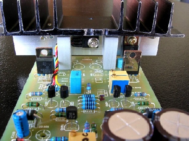

Those Dale's are indeed a fraction to big for those boards and therefore you have to bend the leads realy tight against the body of the resistor. It's not how it should be done but hé......

The blue caps are Panasonic FC 1000µF/50V types from Digi-Key.
C110 & C111 are 10µF/50V Elna Silmic from a vendor in Holland.
Cheers
here's what I've done so far
And here is my construction so far.
Maybe the drivers go to the main heatsink later if the temp is to high.

Fellow builders I have one more question.
In the partslist the value for R122 & R123 is "150 Ohm but can be dropped to 100 Ohm depending on the rails voltage". If I go for 37V rails can I use a 100 Ohm resistor. It's also the fact that I don't have 150 Ohm Dale's anymore. Ordering only a few of those in de States is a bit to expensive.:xeye:

100ohms is fine, but be aware...
...the current through the 'chain' (r122, q107...q108, r123) will increase from ~10ma to ~15ma...
This is not a problem for the resistors, they are still well under their dissipation limits, but the transistors (q107, q108) are going to have to deal with 50% more power...
With 37v rails, the standing dissipation will go from ~0.3W to ~0.5W, ie they will get quite a bit warmer, perhaps hot...add heatsinks if you need to...
