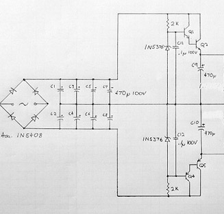

I made a few class A amps and headphone Class A amps, and they all sounded better with a regulated supply. If there was any supply noise/hum, the regulated supply really takes care of it🙂What would the advantages be in doing this?
I am not sure that if you want to run the Krell with lowish bias, that the advantage will be so great. There has been a lot of talk about regulated supplies, not being the best for class A/B. Nonetheless, with the Zen amps and headphone amps I tried it, it was a great thing. They went totally quiet 🙂
Steen🙂
newer model
AFAIK The power supply board you show is from the 3rd and later version of the krell KSA series. It has higher regulated rails for the main board to make the 'new' driver topology work properly. The predrivers are mosfets and need a higher voltage to do their work.
If you have transformers wth additional windings it would be quite inexpensive to try, but you need about 10 more volts to feed the regulators...it would be easy to add additional windings on toroids with open centers...I may have to try it later...
It's not clear any benefit will accrue in the earlier amps...as long as the voltage doesn't droop below that required for the zeners in the front end...
Stuart

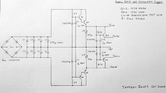

Mark A. Gulbrandsen said:What would the advantages be in doing this?
In the MPSA version a 1mA variance in the VAS stage would result in a voltage difference of 3.4 Volts.
With minimum hFe of the mpsa's at 25, current variance at the collector of the LTP device need only be 1/25th mA.
Voltage regulation of the LTP and VAS rails give accurate working points, resulting in less hard labor for the feedback to rectify the mistakes.
Less work for the feedback should improve sound, if the feedback is constantly correcting the output signal is never perfect.
(my opinion anyway)
I found a box full of 2* 9 VAC sealed toroidal transformers on the web for $1 each. (surplus telephone transformers), using those to raise the PS voltage to regulation level.
The regulator for the 80/160 is a bit simple, but changing it to KSA50 level is easy.
Would do very nicely on the Krell clone, i think.
