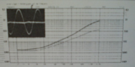

"... very low distortion ... " - do you have some objective measurement ? Square wave tell nothing about distortion .
Yess, I have a Sound Technology 1701A distortion analyzer. I had made some quickie measurements on my first KSA build and it was quite good at about .008% average across the band at 10 watts into 8 ohms. Square wave looks square, no rounding of the rise, etc.... so pretty good linearity and a very fast amp. This was with the 330pf and 100 pf values in the amp. I have 680pf on the input.
I am somewhat more curious to see the distortion spectrum... hopefully this weekend time permitting.......
Mark
Original:
20Hz-20KHz, 8 Ohms, 40 and 60 watts, starting at 0.004, reaching 0.1 and 0.03 at 20KHz.

If you take the Threshold Stasis amplifiers from those years, those had nearly constant distortion, almost to 20KHz.
The amplifiers by Mr Pass were the first i saw that had a gradually decreasing harmonics spectrum, with lower uneven harmonics. (NP> clever dicky)
Why Mr D. placed 390pF in the posted original circuit is a mystery.
What is your advice on the accuracy of those capacitors ?
Every amps with similar curves, which I had heard ( and belive me, I had heard realy many amps ), had " unpleasant " trebles, including NP's " modernst " ones, where is this curve typical. Some manufacturers call it as " musical " amp, but I hear it like distortion and I don't take it. 😎
