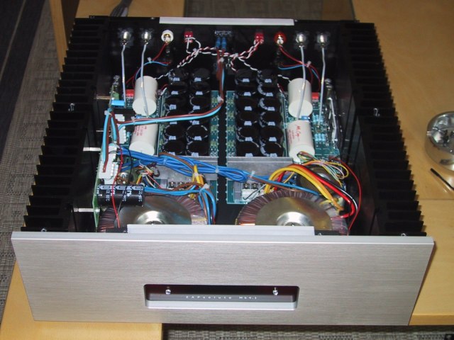

The LC audio Zapsolutes have very clean and natural highs.
A bit OT, I have to agree fully to that statement😉
Take a look at this baby.
Steen.
BTW, I guess the big Mcaps has something to do with the clean high's.
Steen, remember, that clear high make mainly sophisticated connection and precise designed construction, not miracle caps .
You are right Upopa😀 (as always🙂 ) I wasn't sure about it, thats why I guessed😉 The Zap is precisly designed, IMHO. No NFB!
And the Sanken output transistors has something to say too😉
Nonetheless, that amp sounds incredibly good🙂
Steen😎
