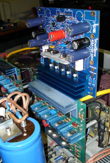

Here's a picture of Jozua's Mk2 with one of my boards placed on top for comparison. All the dimensions, mounting holes etc. are a perfect match! It was the original idea and carefully measured out but it's good to see it checks out.
Even though they won't be put in this particular amp, they will be used to upgrade his other Mk1 to a Mk2.
You are right about that PWatts,
Im aware of that stray fields round toroidals due to flux leakage. Thats the reason I always suggest potting in a mild steel can when asking for a price quotation.
Regarding thickness of secondary windings and toying around: its not an issue, due to it will be flexible leads on this transformer, if going as far as to a group buy (GB)
