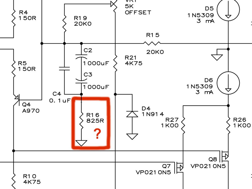

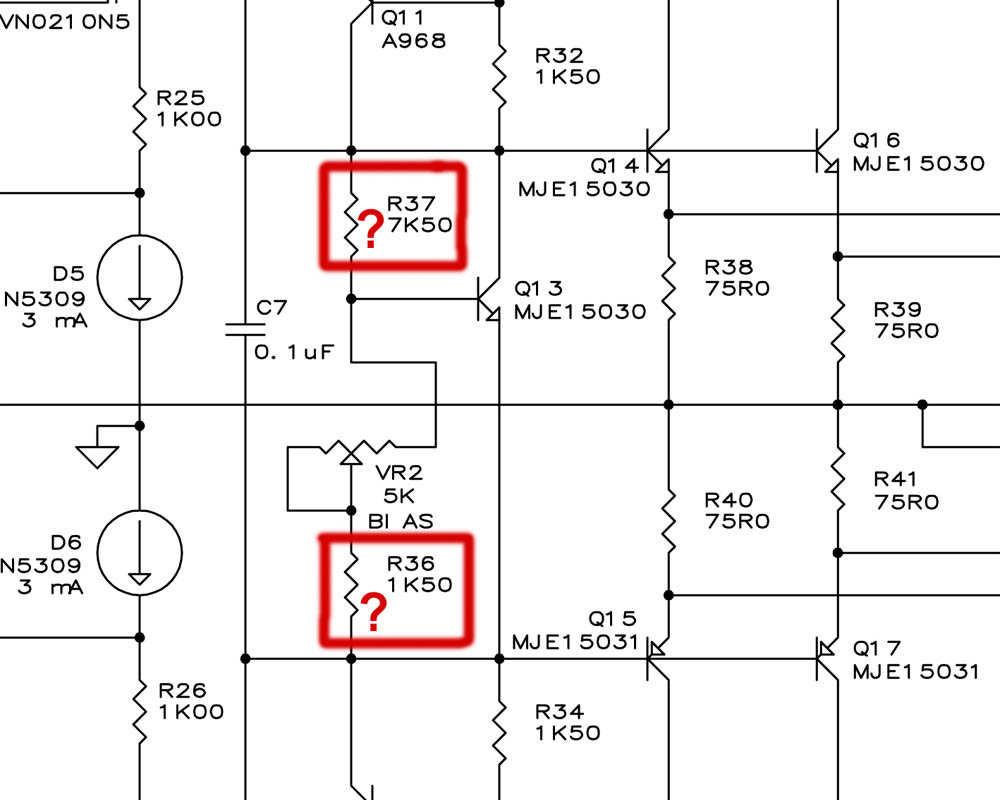

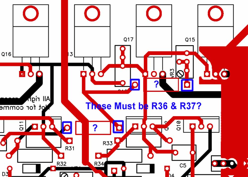

KSA100 Questions
Hello folks,
I¡¯ve been low profile on the DIY audio projects but things are heating up again. I¡¯ve stuffed most of the parts in my KSA100MK II boards and I have a few questions.
A) Regarding C4 (0.1uF) & the C2/C3 pair (AKA 470uF bipolar) they seem to be floating and not terminated to ground via a missing resistor R16 (825R). Looks like a simple fix to run R16 to the ground on the underside of the board?
B) R37 (7K50) and R36 (1K50) from the schematic do not have ¡°homes¡± on the MK II boards but there are some mysterious pad/via¡¯s that line up with the layout images. The layout image file seems to be different from the actual PCB¡¯s that were manufactured. It looks like the resistors do have positions to be soldered into but some slicing and dicing would be required on the actual traces to make them work, possibly?
Or was the design changed to eliminate these parts?
Hope all is well,
Shawn.

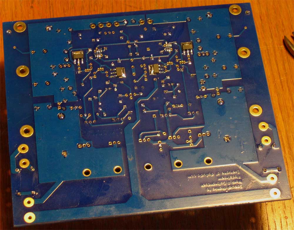

General comments KSA100 MK II
I used the SOT-223 package options for Q5, 6, 7 and 8 and it was very easy to solder these surface-mount parts on the underside of the board. I was hasty on my components purchase last spring so now I have the extra substitutes for these devices if anybody wants them; I have 4 pieces each :
IRFD110PBF-ND
IRFD9110PBF-ND
ZVP2110A-ND
ZVN2110A-ND (Obviously you would use one set or the other)
I also deployed the use of some of the extra capacitor positions provided, using 4 pcs on each board of 100v 680uF FC type electrolytic. I now have 4 extra pcs if anybody wants those too.
I purchased 100 each of 2SC2240 & 2SA970 and found perfect matches for all of my Q1~Q4¡¯s and I was lucky because there were only 4 pcs of the A970¡¯s to match the large bunch that came from C2240¡¯s.
I¡¯ll be using my 1000VA 44-0-44 VAC transformers, one for each channel so my rail voltages should be just under -+60 VDC so I decided to use 100V electrolytic caps. I picked up the cap bank for the main supply from Steve @ Apex as I purchased 4 pcs Hitachi 47,000uF 80 VDC but just recently I picked up 4 pcs of Panasonic 68,000uF 100 VDC. I think it makes sense to use the 68¡¯s on the Krell KSA100 and the 47¡¯s on the KSA50 (which is almost ready to go into the enclosure).
Mr. Watts has placed jumper positions J4 and J5 to connect the front end power supply to the driver stage power supply and has indicated a value of 0R to 10R. Regarding my power supply rails, I was wondering what you think would be an ideal value to place here for best RC filter performance vs. voltage drop on the front end? Again my rails should be just under 60VDC by a few volts depending on the level of bias current that is set.
I have not 100% decided how many output transistors I want to use but think a total of 12 per channel would be plenty. I have some samples of the MJW21196 and MJW21195 and I can easily get more. Any thoughts using these devices versus others from On Semi?
The -+60VDC will obviously sag but is it too high to operate this thing at 55~57VDC?
See pics of my stuffed KSA100 MK II's

These three components were routed on the bottom of the board; the bottom silkscreen was merely left out to save costs.
R37 can just as well be placed on the top, I put it on the bottom to prevent it from possibly interfering with Q9-11's heatsinks.
PWatts said:These three components were routed on the bottom of the board; the bottom silkscreen was merely left out to save costs. R37 can just as well be placed on the top, I put it on the bottom to prevent it from possibly interfering with Q9-11's heatsinks.

I guess you folks have already discussed all this stuff? Sorry I have'nt been around to catch it all. I'll make the adjustments and post some more pics.
Have you dropped your boards into your friends Krell yet? How many of you people are listening to this baby nowadays?
Shawn.
