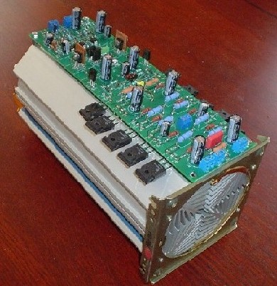

Do you want to see the KSA-100 or the KSA-50 Flod? AM enruote home fomr Vegas and had car problems but will be home later today... just let me know which ones you want to see.
Mark
Mark
Mark A. Gulbrandsen said:Do you want to see the KSA-100 or the KSA-50 Flod? AM enruote home fomr Vegas and had car problems but will be home later today... just let me know which ones you want to see.
Mark
KSA100 please.
Thanks Mark
Regards 😎

Mark A. Gulbrandsen said:AM enruote home fomr Vegas and had car problems but will be home later today...
Mark
Heavy problems I guess,
But to be honest, maybe you have had to much to do Mark, but it should be nice to see pictures. 😀 😀 😀
Regards 😎
