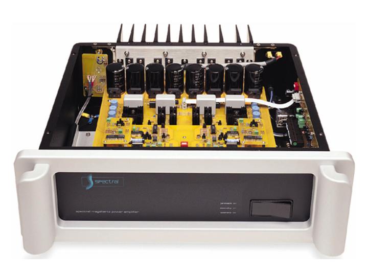

NEW SCHOOL. Worth a look.
Spectral DMA 360, 1 Mhz single PCB layout. Front end circuits are inside silver cans, front end regulators on main PCB with local small blue caps, output drivers on main PCB with Black Gate cap per VFET, ICs in front are power sequencing and error sensing, small PCB on right side holds protection relays.
DMA-360 Monaural Power Amplifier
Keith O Johnson is an audio genius....! He has been designing audio gear since his high school days and is also one of the inventors of the HDCD format. He designed and built his very famous reel to reel tape machine when he was in high school. I believe it had 3.5 mhz bias! It was very revolutionary in its day and by todays standards the recordings he made with it are amazing.
So he's not entirely new school..... Spectral sold 1mhz bandwidth high end power amps in 1982.
