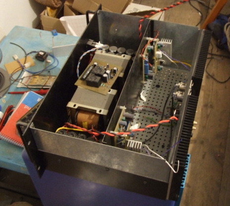

OK-now I can give ya my snail mail addy ,to send me this ugly MKII
selcuksiyoni said:i have to upgrade
Smart choice.
Although i haven't seen such a clean KSA interior in at least 10 years yours looks like it is in real need of a refreshing.
Those small red Roederstein capacitors haven't been produced for quite some time, the ones on the board are overdue for retirement, and there are much better electrolytics nowadays.
You might as well go for an entire new set of boards.
Consider a fresh set of output devices as well, your KSA looks like a classic specimen that deserves to be kept in shape to show to your kids.
