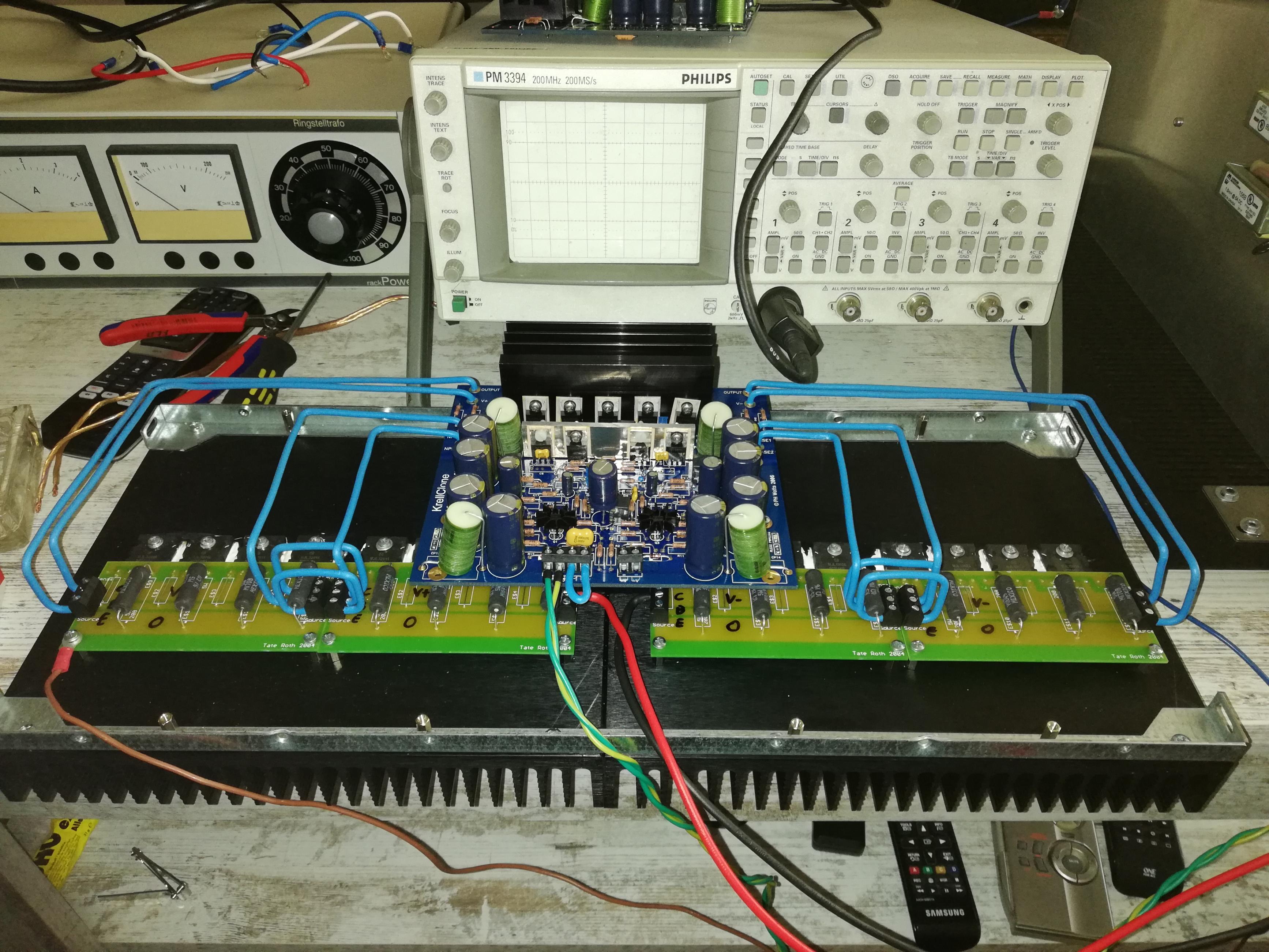

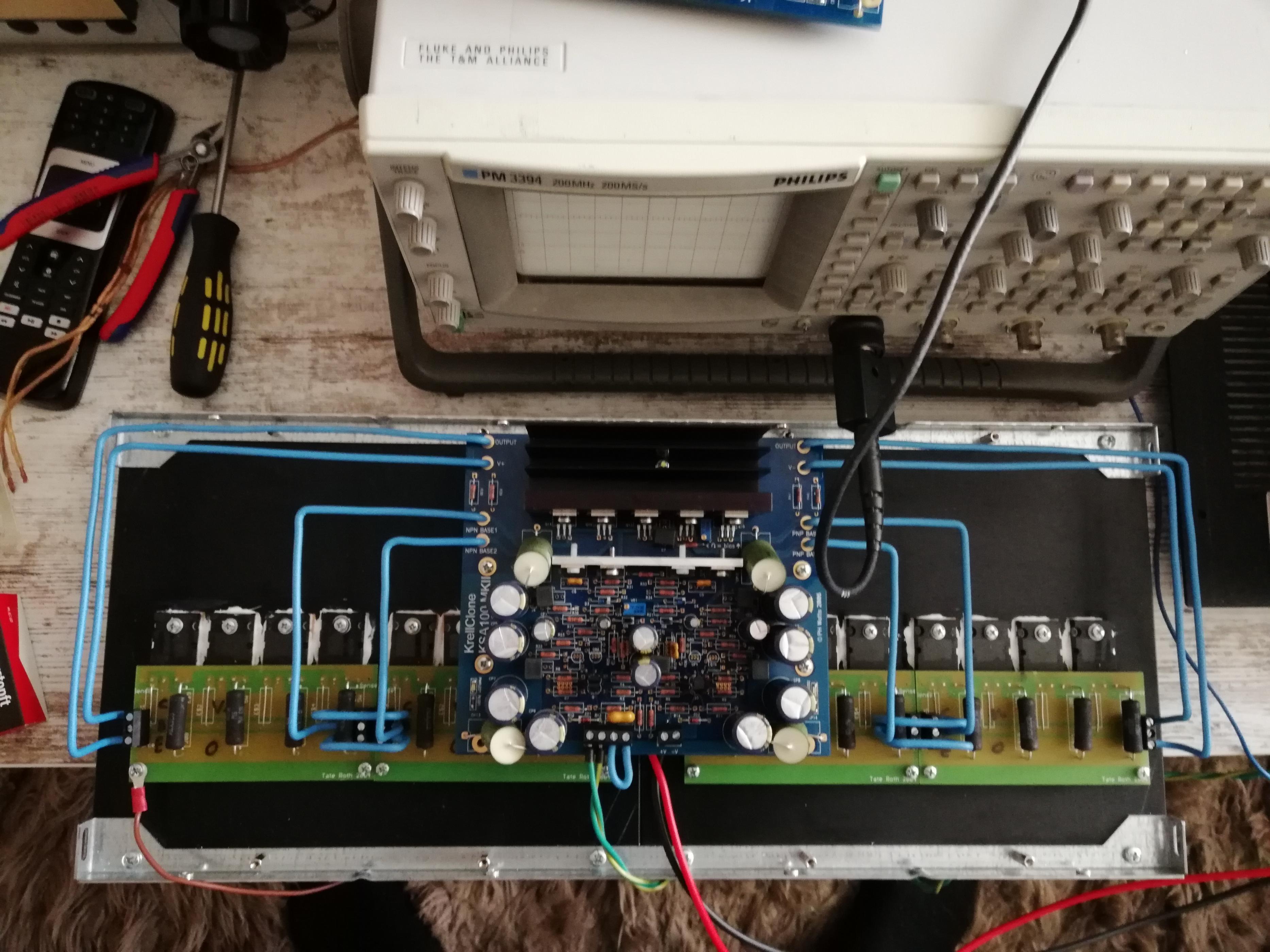

here is my picture
i know that the output should be biased to about 320mA.
but with +/- 10V the bias is already at 300mA with the potentiometer to minimum.
when i power more up the bias will raise to a big value and destroy everything...
if the potentiometer is wired in correctly, then a high value gives a low bias voltage.
Have you set the bias voltage correctly?
Have you wired in the pot correctly?
I doubt your heat sinks will support the full bias from the looks of it.
You might get away with half their value.
I would set the trim pot to half rotation and run it up with a Variac. Many boards are opposite from the way you think they should work and this allows you see which way increases bias
Immediately turn up the Variac about a 1/3rd to get the transistors to switch and go from there. You should be alright but seriously think the sinks are not enough surface area.
