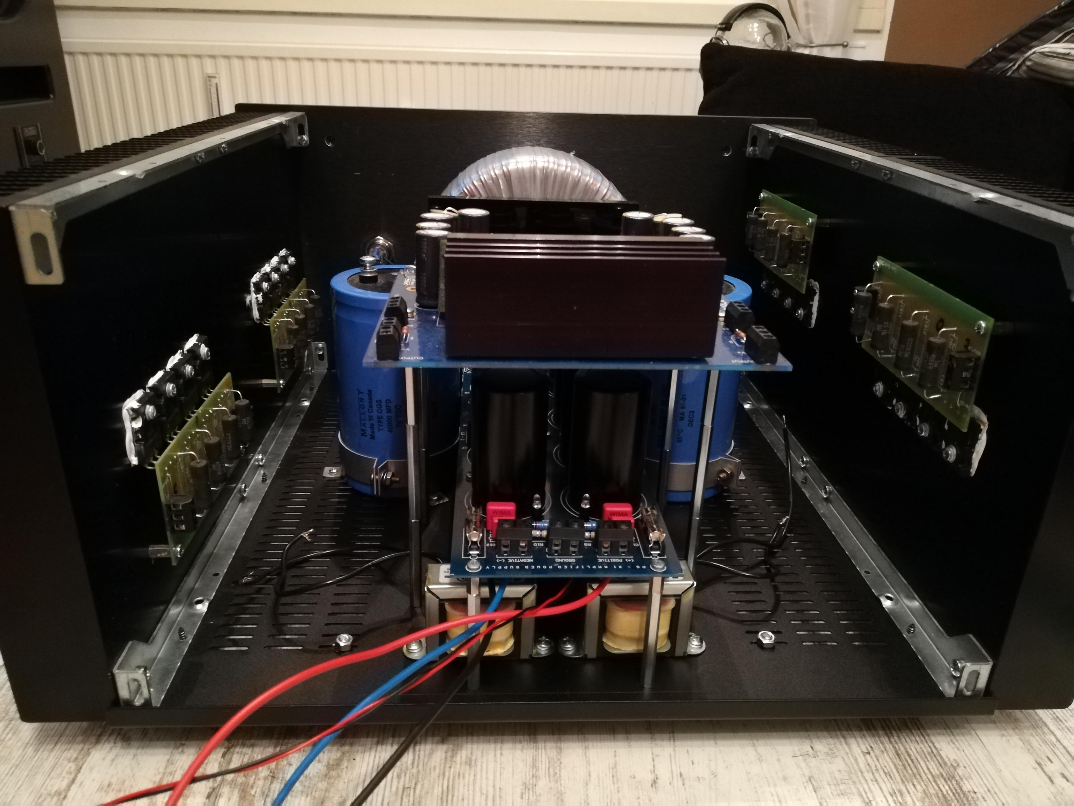

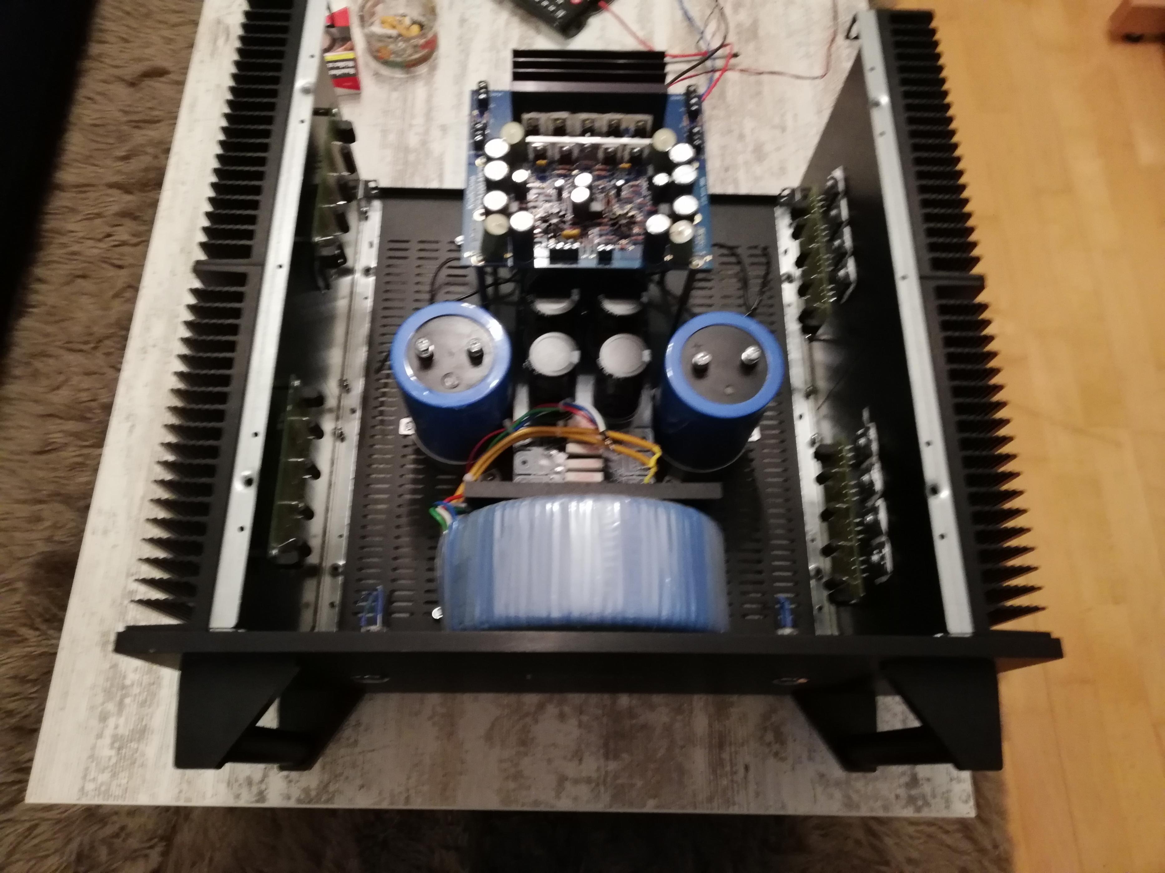

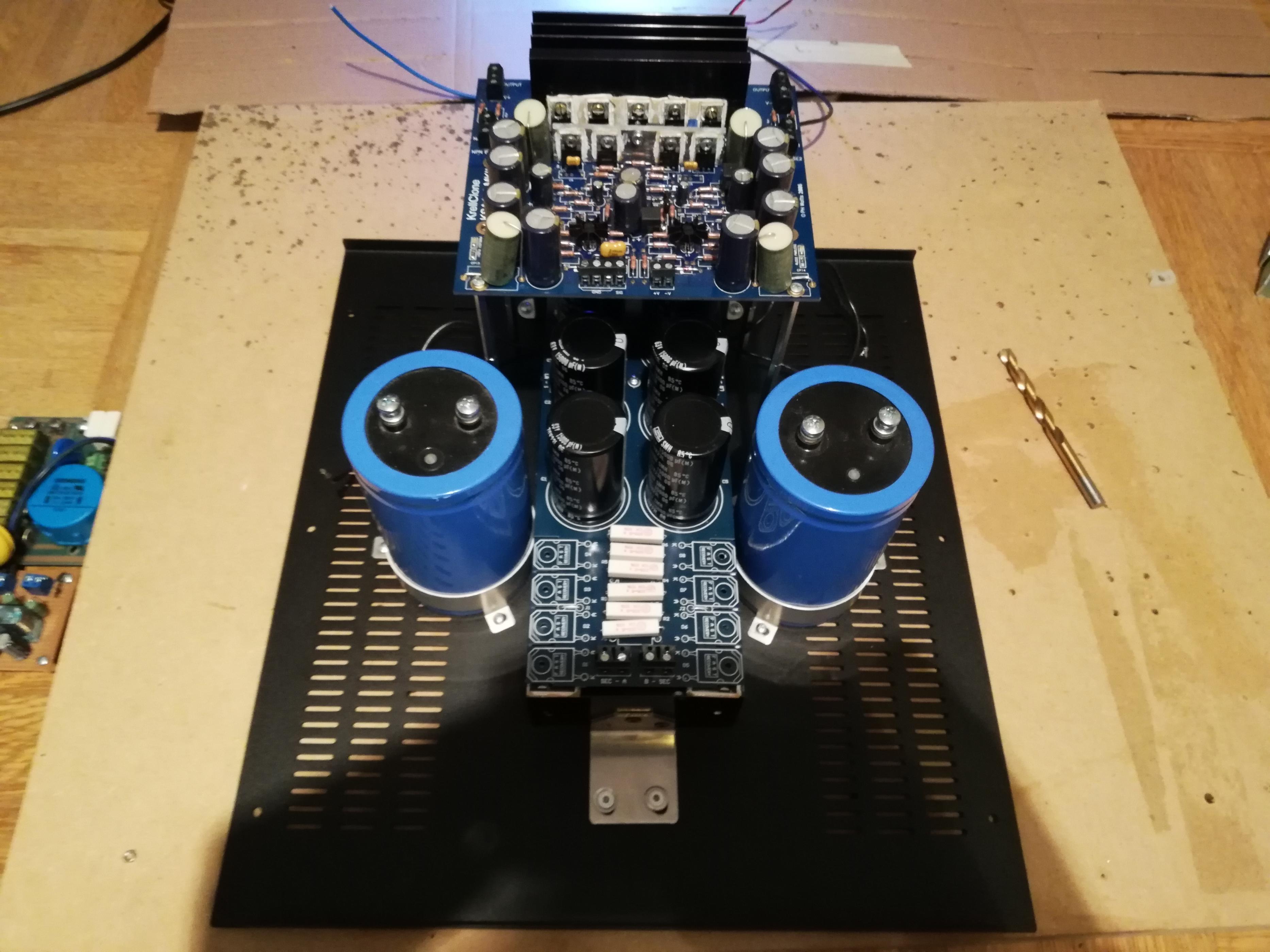

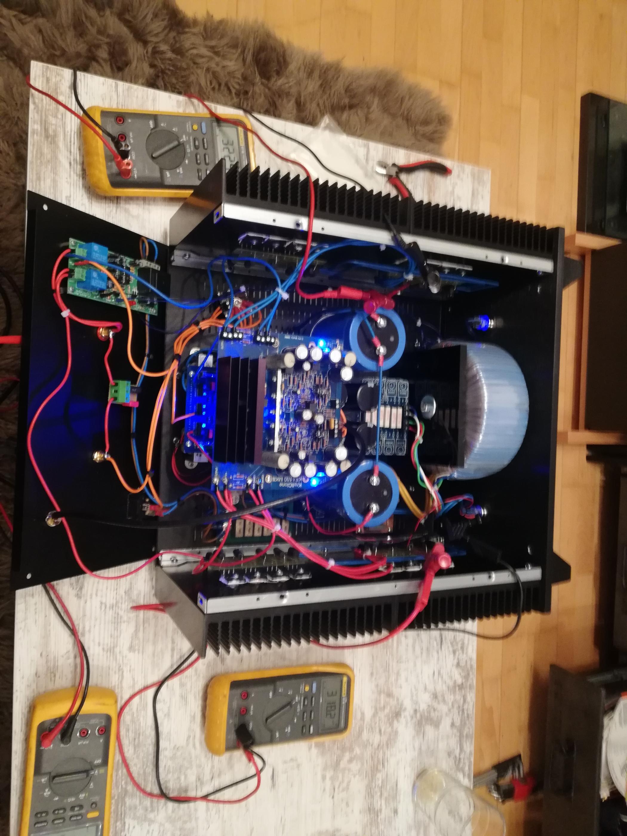

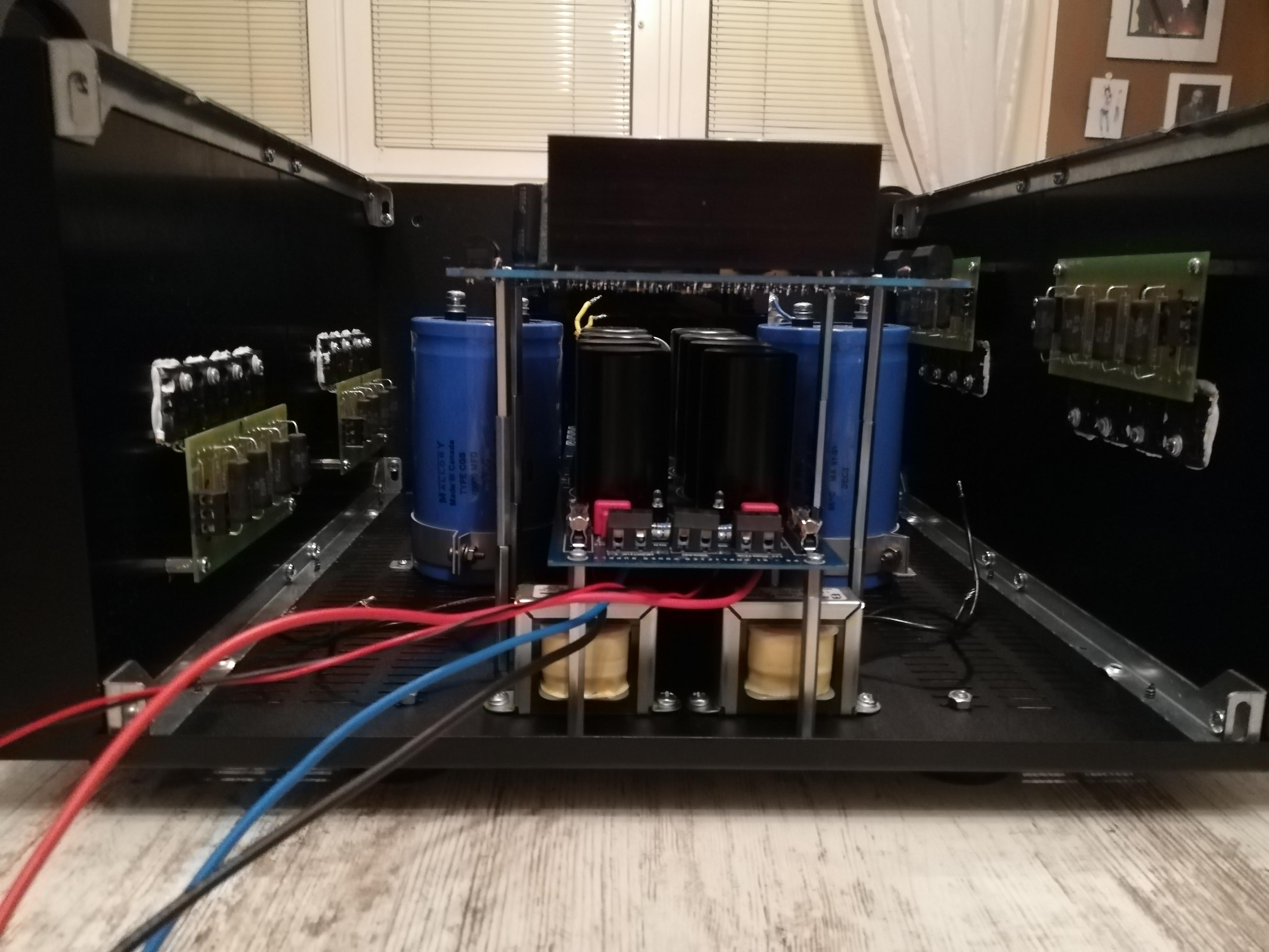

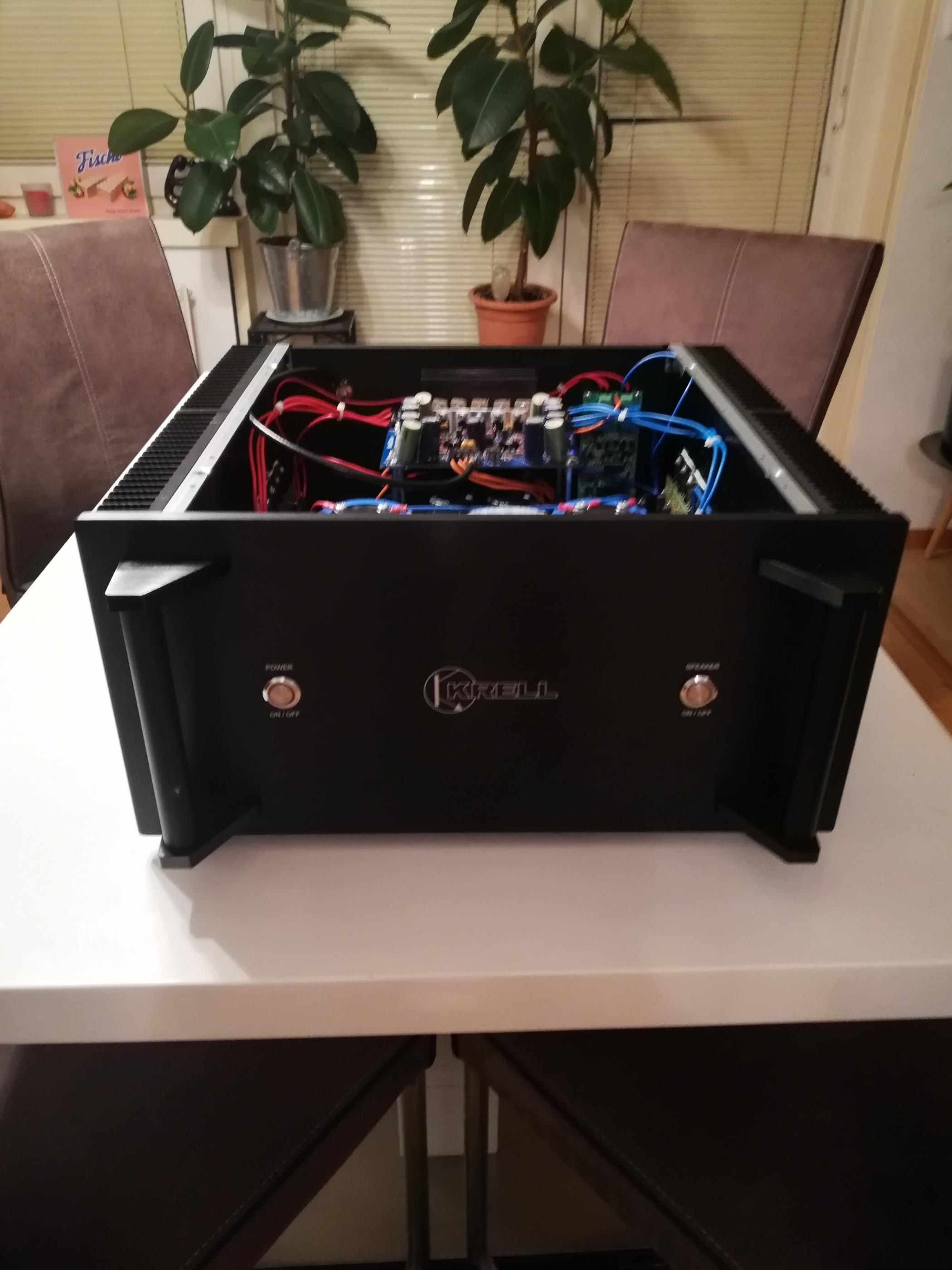

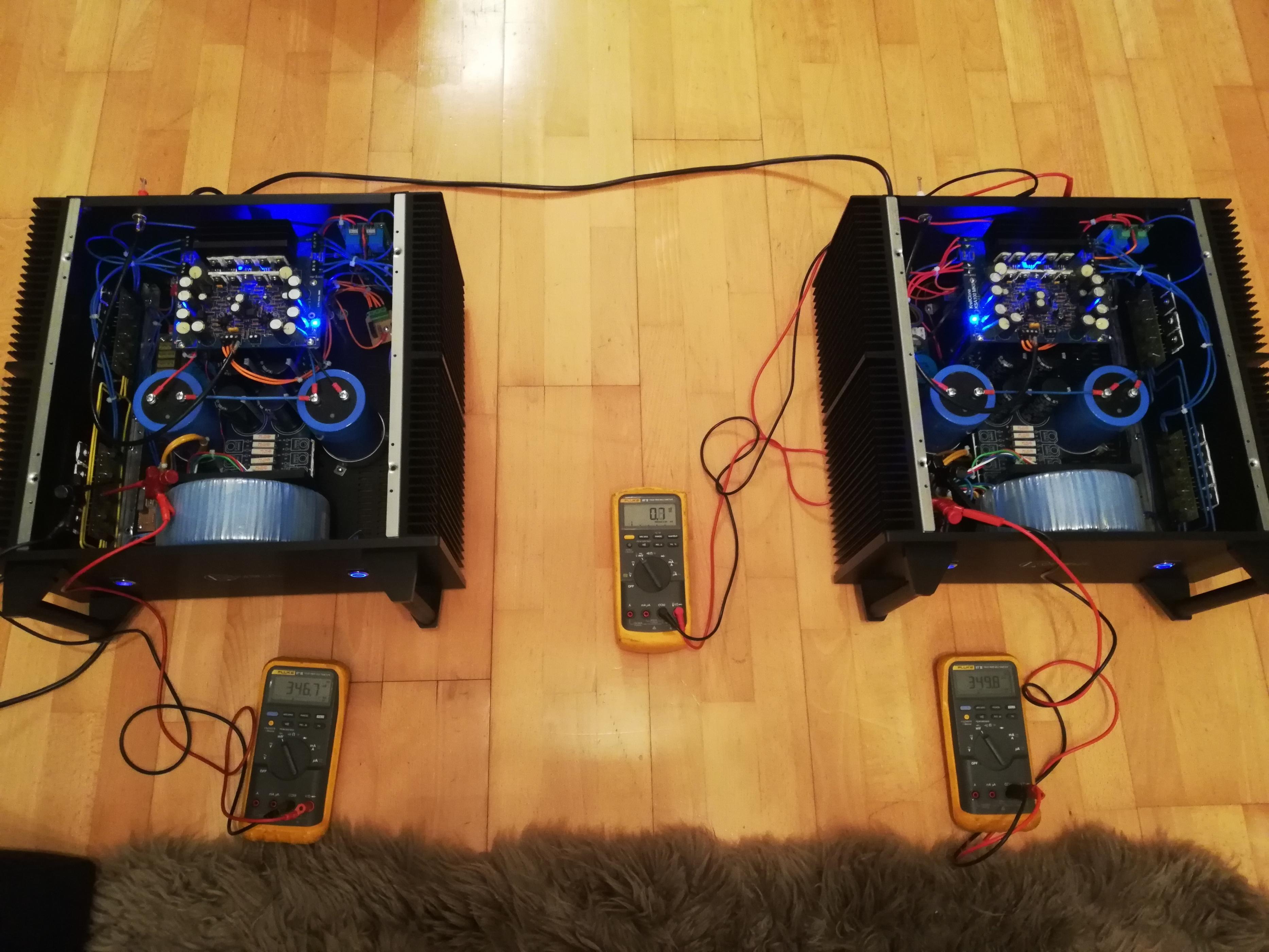

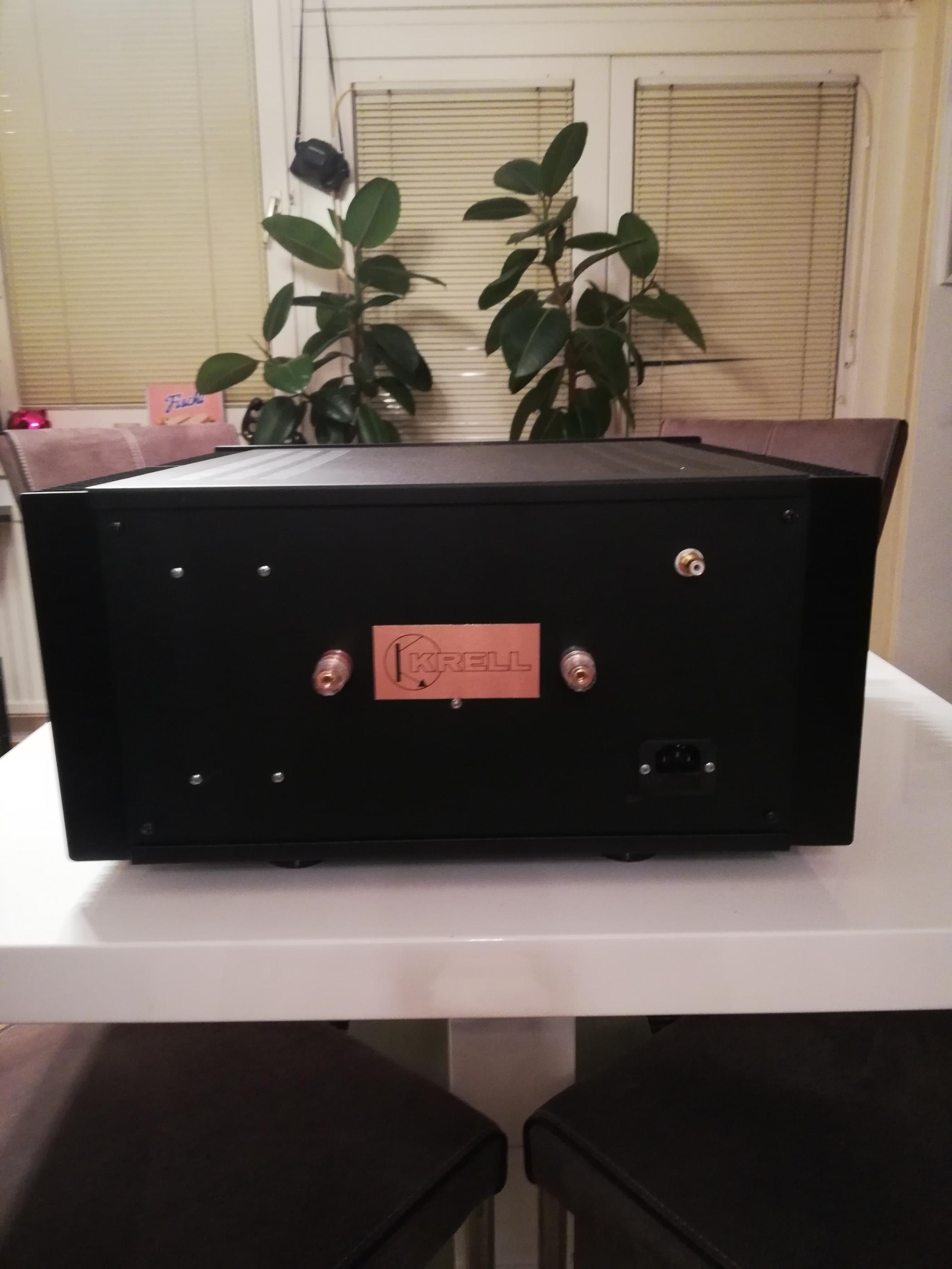

here are some photos of my finished amp...
That's a beautiful amplifier!

Looks awesome!! Im curious, How much did you end up spending in total all in?

Beautiful artisan work!
Also the inside looks very tidy.

it was really expensive but i wanted to try the maximum (for me)...
about 1200 - 1400 in all the parts and tools.

it took me verly long to sort out how to realize and then to do it...

It seems that you used 8 output pairs for each channel.
To do this, did you make any other changes to the circuit i.e. the driver stage?
What are the two inductors under the power supply board?

I only see 4 pairs/channel.
