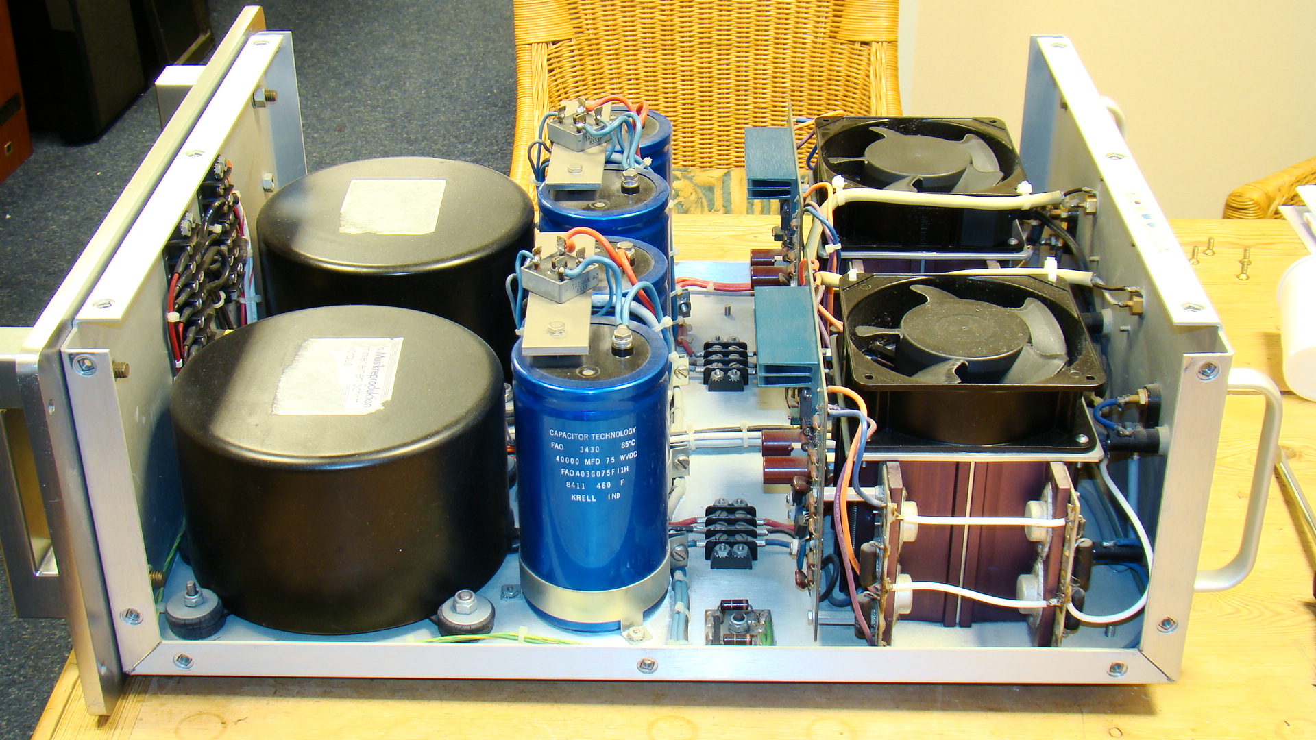

Sorry to interrupt but I just bought this original KSA 100 where the fans have been replaced to somewhat strong (and noisy) ones (you can hear them in the next room when no music is played).
I'm very surprised by how cool this amp runs. I play low levels of volume and the amp is basically cold.
Is this normal? Could it be that the amp has been tweaked and no longer runs pure Class A or is it just that the very strong fans are keeping it cool?

check the voltage drop across each of the outputs' emitter resistors.

I think the procedure might be in the owners manual.
If not then start posting pics of the inside particularly around the output stages.
There are a number of KSA threads and at least one website that already have pics of partially dismantled KSA shown.
You should be able to compare your version to some of these and from there identify the outputs and the emitter resistors.

compare your output stage to pic in post2445.
Are they similar, or same, or identical?
That pic shows 1r0 emitter resistors and also shows croc clips attached ready to take voltage readings.

yes,
the voltage measurement across the output emitter resistors allows you to calculate the bias current passing through each output device.
For this push pull output stage, the maximum ClassA output current is ~2*bias current
The KSA100 is a 4pair output stage.
If you have 600mV across all 16 emitter resistors then you know you have each output device is passing 600mA.
4devices in parallel pass 2.4A and from there the maximum ClassA current is 4.8Apk. This is equivalent to 92W of ClassA output into 8r0. 600mV is underbiased. Krell should tell you what the correct bias is for you model.

thanks Andrew. This is all chinese to me; sorry for being so ignorant on this side of the world. I'll probably seek professional assistance here in Paris, where I live.

I would seriously recommend that your replace the power supply caps and the Roederstein cap on the PCB. They most likely beyond their safe lifespan.
