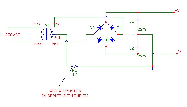

One of my KSA50's does that. By itself, no hum. Hooked up with any other amps I get a hum from all. What do I check for?
Thanks, Terry
Do this, it works. There are other solutions as well this is simple and you can use values between 10 - 27 ohm 1/2 watt.
How much current do you reckon flows at center Tap... I'd hate to blow the resistor and thus the whole amp... what am I missing? To me the center tap from the trafo is the anchor... if broken, the boat sails away for good...
I could perhaps think about this fix at the input gnd after all thats where it connects to the rest of the system... I would not open up the star ground...

still4given said:

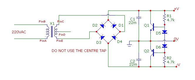

Thanks, I'll try that. 1/2 watt is enough? 1/2 watt is fine. After you decide it is a great idea, try the next circuit.
There should zero current flowing in the transformer centre tap.

Because there is no reference to the 50 Hz of the transformer to the 50 Hz of other transformers in the system there is no 50 Hz/100Hz signal in the ground.
Terry is experiencing this in that one or several of the other equipment "zero volt" or ground is not quite zero volts. and the 50/100 Hz signal appears in the amplifier as hum.
All a.c. is flowing trough your capacitors which is not only the "reservoir" but also the low impedance path for the loudspeakers, while d.c. references V/2 and not zero volts.
Nico
Zen Mod said:
look for Quad 606 schematic
Hi Zen,
if I am not mistaken all transistor Quad amps uses this method, also quite a number of other "esoteric" types, those whose designers know what this circuit is.
The headphone amp guys use a complete amplifier to achieve this and only because they don't know :whazzat: what it is that they are implementing.
Nico
Nico Ras said:
Hi Zen,
Nico
I agree with most , except that - not all Quad amps use that technique;
405 , for instance , use plain vanilla center tap
