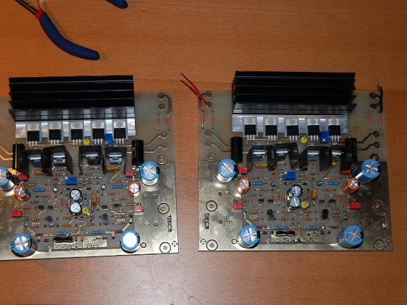

I'm soon ready building my input board.
Next thing is to try them, before building rest of the amp.
Is there any information/guide how to try them without breaking them.
How do I set Bias and DC ( VR 1 / VR 2 )
Could I start with lower +VCC
Then attach Tone Generator to Input, and use an oscilloscope to
look at the signals.
Is there any good Testpoints, Values etc..
Do I need to have some resistors at Output ?
Sorry for all those "stupid" questions, but this is my first amp project 🙂

I think PWatts has given some information that stated the LTP and driver stage could be tested without the power stage connected. But Im not sure of the schematic network he suggested because I couldnt find the actual posts in this thread so you/we have to ask him again. 🙂
Fix, You could start with a low rail voltage but for a proper test with generator you need at least ±42-44V for the LTP (zeners are 39V so rail voltage must be higher than that). 🙄

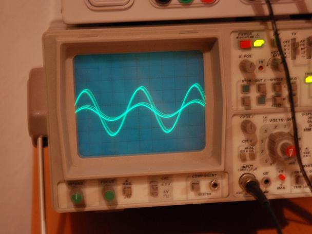

There is life...
Havn't tried it at 42v, just at 25v ( 35v for short time)
One card is working as it should, the other I place a transistor wrong, will change it tomorrow.
Now I need to knew where to measure so I can build the rest, but it looks promising.
Input signal and output signal..sd

Work and other unimportant stuff been taking my time...
But I have worked hard and have actually made a test run on one channel.
Pictues and other stuff for my Krell Clone
I made a test, 31VDC, 400mv on Emitter Resistors, Circuit is drawing 1.8Amp 🙂
Since there is no smoke, and input signal is matching output signal ( yes output signal is amplified.. )
I guess I've managed to come this far.
