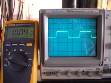

I finished these back on 12-2007
[IMGP0610.jpg]
Hi all!
I payed someone for some special diodes a very long time ago.. Someone recognise this? 😉
My boards are still unpopulated due to indecision, lack of time, etc.. But one day..
