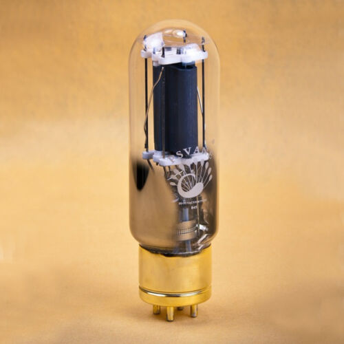

Hey Bill, well not much has been happenin’ on this front. I wandered off reading about the Sakuma amplifiers for some weeks and ended up procrastinating myself into a dead end. I think I got myself a big 845 triode during that period. I’d love to get stuck back in on a project, although first up I need some sort of pre for switching between sources in my family room system and that just begs for a bottle somewhere in the box, maybe a cathode follower just to make sure there’s a glow. Of course, the big bottles still beckon, and the high voltage seems less dangerous than the virus or the stock market these days!

yes, that 845 is a beauty for sure, "go big or go home", as they say.
Now, one of those SV811-10's would make a sweet driver for my 845 😀
