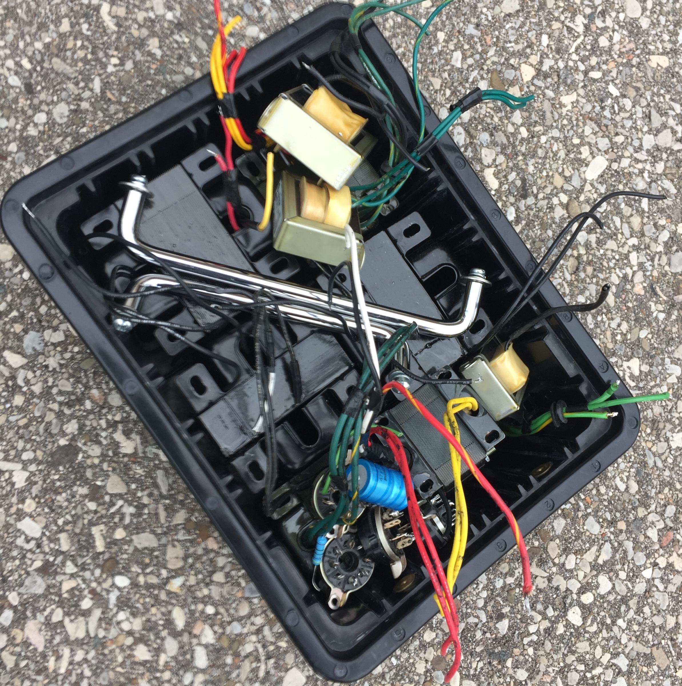

I've now stripped the parts out of the old amp power supply chassis. A lot of iron. I'll likely be adopting just the Hammond 714 plate supply from this.

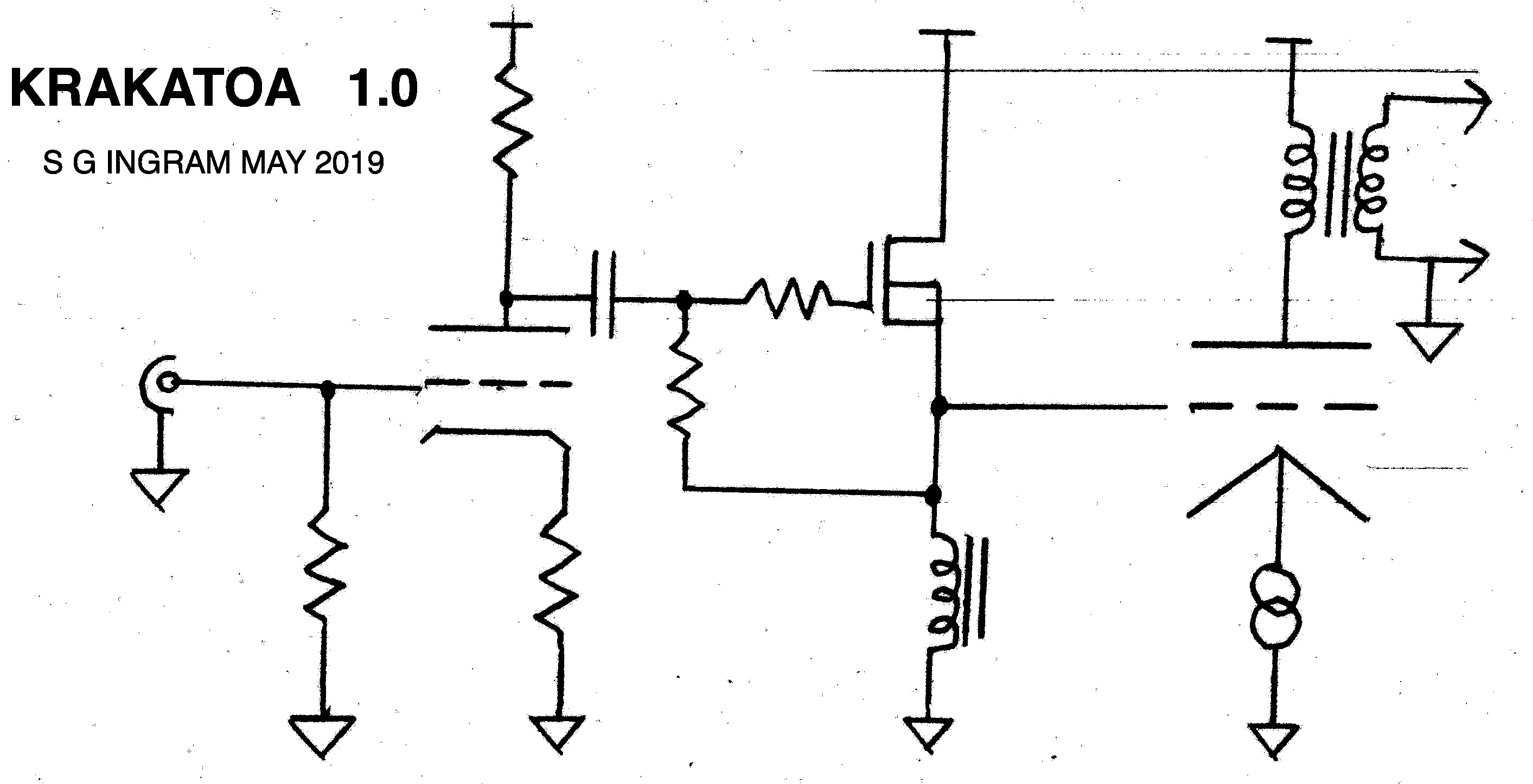

Here's the conceptual schematic. Nothing new per se, but this approach came about due to a number of considerations,
Input: I believe a simple common cathode, resistively loaded triode will help the amplifier provide a sound I will like. I'm thinking 6SL7/6H9C here.
Driver: Use of A2 grid drive needs a low impedance for +Ve grid current without the risk of blocking distortion, which favours an n-type source follower over almost any other approach. As I want to keep things simple I'm avoiding an additional negative supply rail by using choke loading which allows the Source voltage to swing negatively. Negative grid drive requires virtually zero current so there's no need for a symmetrical drive. The DCR of the choke implies that the no-signal grid voltage will be above zero depending on the standing current through the depletion MOSFET.
Output: I need the flexibility to lift the cathode above ground and I want to improve the stability and ease of setting the standing current through the output valve by reducing it's sensitivity to the standing current through the driver stage, which may have temperature variations. I've chosen to use a current sink under the cathode of the output tube. It'll need to be decoupled (not shown).

Why depletion mode? Any MOSFET would work, if you provide positive bias source, with a trimmer to set the bias up. Otherwise you would need a choke with quite high DCR. A minus of constant current cathode bias is, you need decoupling, that would cause the same blocking distortions.
You are getting too low bias voltage for an output tube if to rely only on vgc of a depletion mode FET, even if it's cathode is grounded. Anyway you would need some positive bias.
Edit: I see, you added one more bias resistor in source to bias the FET. Well; it would work then, even without a positive bias source. I did not think straight, you were right. 🙂

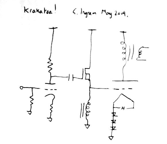

no luck I'm afraid.
see attached.
I was hoping to keep it simple and avoid a bias supply. How about fixed bias, using diodes to lift up the cathode potential without blocking distortions ?
See attached (and remember, I will have some resistors in there to self-bias the FET), the quantity of diodes depends on Vf of the diode type. I believe SY championed this approach with the 'red light district' amplifier when he used LEDs.

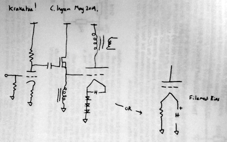

And perhaps, another option. Filament bias using a DC filament supply. With a 4A filament supply the cathode bias resistor is going to be acceptable without bypass. But it's sure going to be toasty !!!, between 20W and 40W of magma warming heat!
With the diodes I'd only be 'wasting' ~1W.

ha! - well I may yet add a bias supply.
This project was supposed to be a quick win, a diversion on my main journey with some other projects. I wanted it kept at safe-ish voltages and simple - kind of like a 2A3 is simple. As I dig in further it gets more complicated. These transmitter tubes are a lot more trouble than I had imagined. Now that I've thrown down the gauntlet on A2 it seems I will have to impose some kind of solution.
