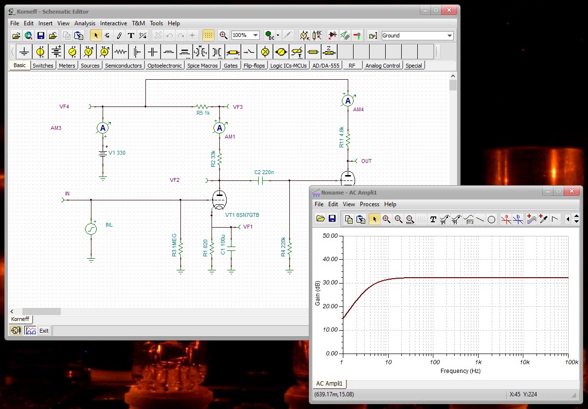

I have a pre-amp already. It is a Jack Elliano designed 6SN7 low-IMD. One of the best preamps I have yet to hear in my system, very transparent and dynamic. I would say very similar to Octal Aikido but Aikido had too much gain for my system. I am driving Lii Audio F-15's in full-range in OB can turn it up to uncomfortable levels. Choosing the 45 tube was a no-brainer for me. Choosing WHICH 45 amp was tougher! I saw several reviews that said the Korneff was by far the best with a preamp present. I tend to agree as it is better than my Tubelab SE 45. I also like the simplicity of the design as experience building has shown me that the fewer parts in the signal path the better things sound.
You're correct, of course, and I'm all for reducing the number of stages and parts, if possible. The SET I've got on the breadboard only uses two tubes per channel with a 26 input, although it's technically not a 2 stage amp since the power tube is a 6N6G.True. But if a high-gain first stage is used instead (D3a, E186F, C3g, etc.), the amp could be driven directly from the output of a DAC. No need for a preamp in this case, resulting in a quality gain (1-2 less preamp stages in the signal path - every stage adds its own distortion to the signal).
My point was that the amp was designed to use a preamp. If you design a 45 SET to use a preamp, there's nothing wrong with using the 6SN7. If you're designing a 45 SET that can be used without a preamp, you choose a different tube.

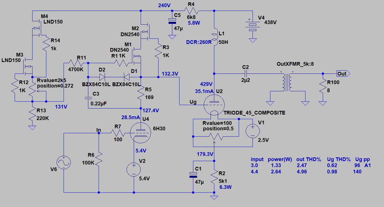

These tubes are super linear and provide a bit more gain than a good ole 6SN7. However, some of these tubes will typically end up with the grid at a DC bias of maybe -1.5 V or -2.0 V. Modern audio sources will therefore easily swing the AC signal into (or close to) positive grid voltage, which means grid current and distortion.
To prevent the grid current problem, I like to use tubes that allow a more negative DC bias. The 6SN7 is a good choice (if you ask me). If you want something else, take a look at the 6H30, which will easily work with a -5 V or -6 V DC grid bias: Tube Tester Files - 6N30P - 6H30П
6N30P has gain 15, so at 2V RMS input as standalone driver not optimal.
BTW sucks almost at least as much current as 45. 😛
I am not sure what you mean.
If the grid of the 45 tube is biased at -40 V or -50 V DC, it can swing 40 to 50 Vpk before it starts clipping. With a driver gain of 15, that would correspond to 2.6 to 3.3 Vpk. For a sine input, that's 1.8 to 2.4 Vrms. For non-sinusodial music, it's less than this (about 0.3 to 0.9 Vrms depending on the crest factor). In other words, a gain of 15 is just right to fully drive the 45 tube in such an application.

Please don't attack me it does not work like that. Moreover, data sheet mu not attainable with resistor load. We also should consider insertion loss. What works for me is if the output tube's grid is at -50 volt then the driver's mu should be minimum 30 and that is for CD's standard 2 volt rms output.

You can bias ef184/e180f/c3m/e186f etc. at about 180 volt plate voltage for 8-10 ma current, cathode at about 2.5 volt...been there done it many times.
