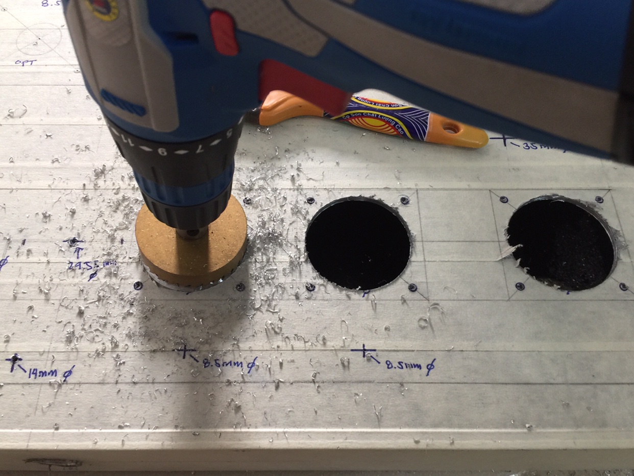

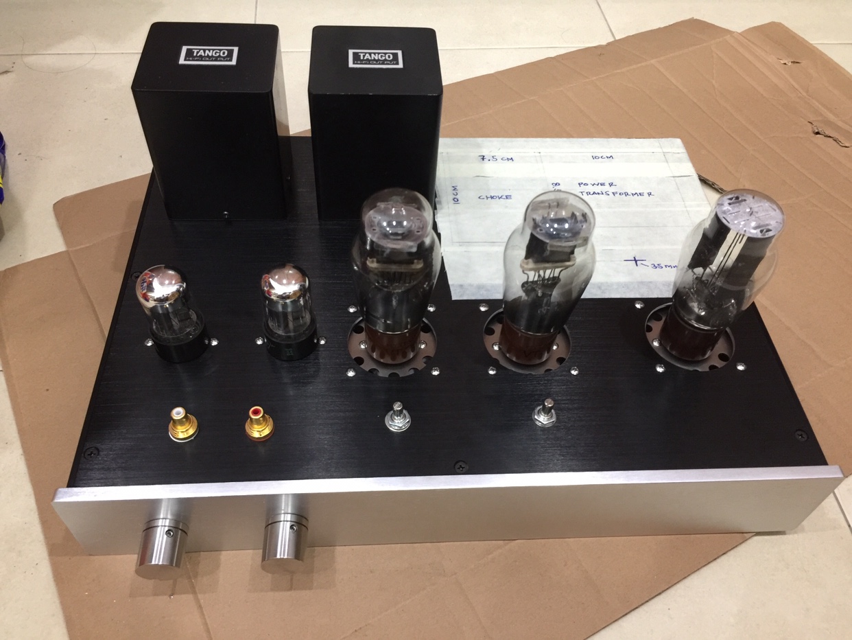

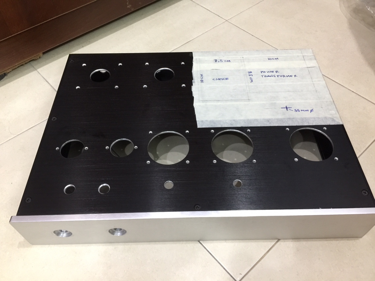

Hi JJ, yes i started the project already but i have no time to start a thead for that subject [emoji4]
Here are some progress photos..
Target date of Completion, End of April.. my friend Edrel Sidon of AT&S Transformer will do the custom wound power transformer & choke for that project..
