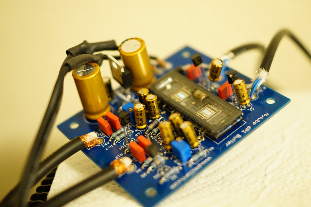

I am working on a few reference schematics. Also an article is upcoming in audioXpress. It's pretty simple.
You typically need some kind of buffer on the input to drive the grid. I have used both a JFET buffer, and a small MOSFET follower. Either works well. If the input impedance of the class D amp is low (10's of K) you also need an output buffer - same idea, JFET or MOSFET.
I am attaching the schematic of the entire class-D hybrid amp I built (shown below). I used dual JFETs to buffer in and out, and a JFET phase splitter to drive complementary inputs to the class D. This preformed better than driving it single-ended.
Pete

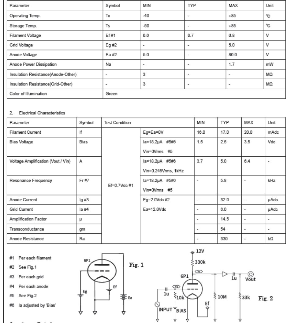

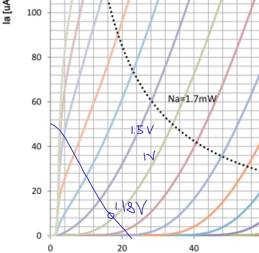

I now have Pete's nutube headphone amp built.
One question is on the biasing (note I am a beginner with tubes).
The nutube datasheet spec says max Grid voltage is 5.0V and Bias voltage max 3.5V, yet in the user manual says bias to 11V (24V supply).
Can anyone explain the reason for the 11V bias?
I looked at the curves and grid voltage only shows up to 4V , I would assume the optimal would be within those curves voltages.

I haven't looked at the circuit in question, but with a tube, the grid bias referenced in the datasheet is the difference between the voltage on the grid and the voltage on the cathode. My guess is, again without looking at the manual, is the 11v is cathode to ground, and if you measured the voltage on the grid would be 8.5v or 9v giving a grid bias of -2 to -2.5 volts or something within the tolerance stated in the datasheet.
Sorry, my mistake. Measure the wrong pins. With 22V input and 11V bias.
Grid ref to ground is 1.87V, ref to Cathode would be -0.7v or 1.17V

The manual says to adjust the grid bias to get 11V on the test point, which is on the plate of the tube - not the grid.
The grid bias adjustment range is 0V to +3.3V.
Biasing at 11V on the plate results in nearly the lowest distortion, when operating on a 24V supply, with this load resistance.
Pete
Pete's headamp - PCB with 6P1 plus the kit
Hi everyone.
I got my kit, the PCB and the tube last Thursday :) (found them at my door when I came from work.. ups). I spent the night soldering the components but I stopped before the last step, the tube. It was 12:30 AM and I didn't want to s...w up anything.
Friday I debated with myself for about 2 hours if and how I should mechanically isolate the tube from the PCB to avoid microphony. Ended up following the instructions and just used the foam pads that came with the tube.
Everything went smooth and I have been able to set the bias to 11 V (on the test points), as indicated in the instructions.
I have to say that if one follows the instructions there should be no issues. You need a little bit of soldering experience, though, since some of the pads are really small.
Some background about this project: I am a dedicated to solid state guy and I have never before tried any tube based build. I do understand the technical aspects and I love fidelity (meaning what's coming in should go out). I also understand someone’s preference for a certain thing (when it comes to personal taste there should be no discussion). That being said I wanted to experience firsthand the tube "flavor" and, eventually, understand the appeal. Since this project was more of an experiment I just followed the instructions and made no changes.
The bad:
- The 3.3 V regulator for the filament really gets hot. So hot that I wouldn't use it for a long time (it worked for a couple of minutes but I didn't want to push it longer) without a heat sink.
- Microphony is there, very real. You touch the board, you get the ping. I even experienced some positive feedback from speakers with a little bit of oscillation. Once you touch the tube to dump the vibration it goes away. I had to "hide" the PCB behind the amp, directly on a rigid surface. Once I have done that there was no positive feedback any more.
The good:
- The PCB along with the tube arrived much quicker than estimated by EBay (3-4 days)
- The kit provided by Mouser was complete and all the components fitted perfectly. This one arrived even quicker.
- Everything went smooth, as described in the very detailed instructions provided by Pete (thank you).
- When you get to the "Now listen" part of the instruction that's it, you can listen :).
- With a short on the inputs it is quiet (I wasn't able to hear anything with my ear near the speaker - once there was no oscillation)
- The sound was really good. Unfortunately I have no technical terms and/or numbers since I have made no tests and took no measurements (other than the bias). The only way I can describe it: smooth and sweet.
On the gray part (I don't know if this should be classified as good or bad - I take it as tube experience): if you are looking for very crisp highs they are not there. I have compared with solid state and the highs are somehow softer.
I have listened to a plethora of music types to experience the results (my usual soft vocal jazz but also disco, club, electronic, symphonic, opera, pop, rock, and some hard to categorize :), not necessarily in this order.
My conclusion (this is personal opinion/taste and so.. see above): I came to like the feeling given by this little tube based preamp/headamp. It really performed impressively with all the music I have listened to. Jazz and vocal in general got the most benefits but also delivered the disco and club punch, the fullness of symphonic. I didn't expect as much as I got for electronic music. Listened to some Kraftwerk and I liked it!
I know it's not pure tubes and most likely it can get better but it really made me curios and I will, probably, try some more in the future (maybe a "pure tubes" one).
Thank you Pete, I hope this helps.
Cornel
