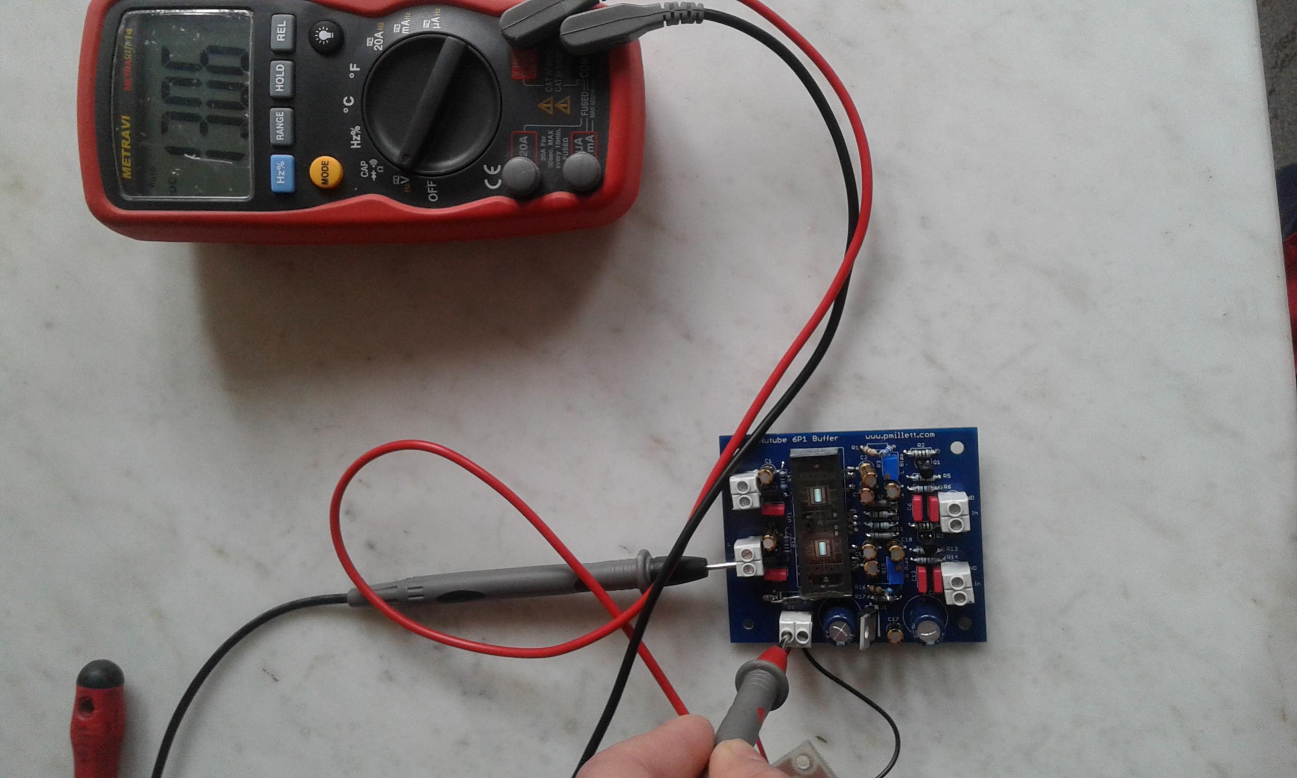

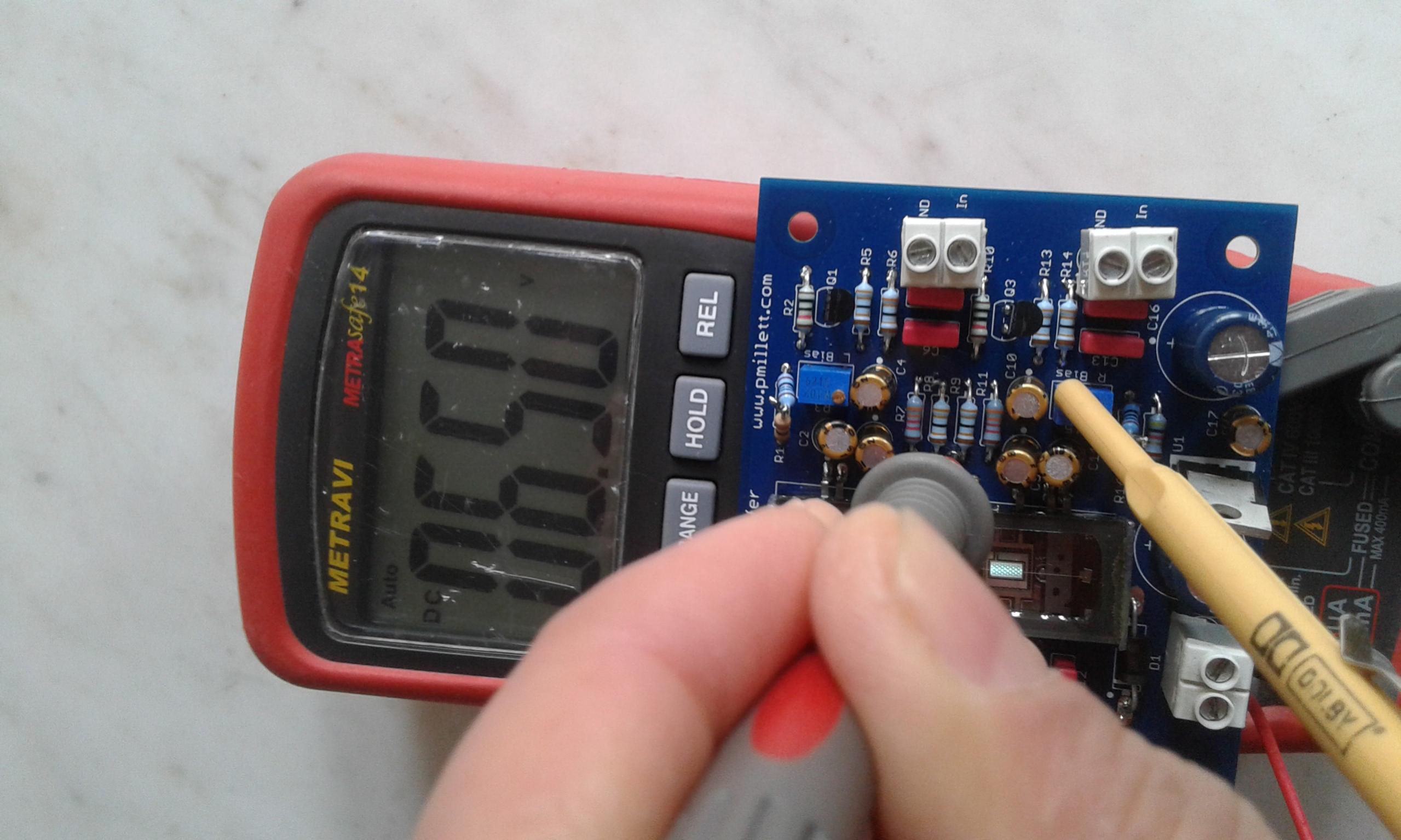

I tried reading the schematic but it's over my head. So, if I understand what you saying, is that I put the black on the left or right ground at the output and then the corresponding resistor, either r8or r9 and then adjust the bias with the trim pot with the red lead of the multimeter? When I read the multimeter when adjusting the bias am I seeing the voltage, and the desired outcome would be 1 volt? How can you measure distortion? Is that not possible unless you have an oscilliscope? Shooting for the 1.5 % distortion at 1v that Nelson Pass determined. Thanks again for the help.
Measure bias
I do this
With my multimeter I leaves black test lead in gnd every gnd are the same.
1) With red test lead measure the voltage of circuit. In my case is about 13 Volts. See photo
2)With red test lead measure (be careful)the voltage on R9 and set the trimmer R bias until I read 6.50 Volt (13/2=6.5) see photo
3) repeat 2 see photo
If wrong please correct me
Hope photo arrive

Thanks Volavola! I did what you said and was able to change the voltage to 6.25 because my battery is 12.5. I have not had a chance to add it to my preamp, but I will do so tonight and let you know what the result is.

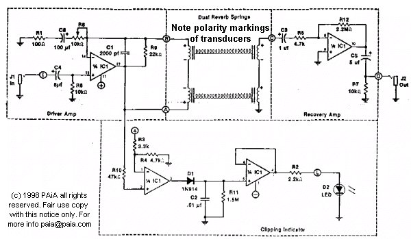

I'd like to build a tube driven spring reverb, like the old Fender units. Would the NuTube be good for this application? I'd be using this circuit, from PAiA, possibly substituting, or adding to, the opamp section.
