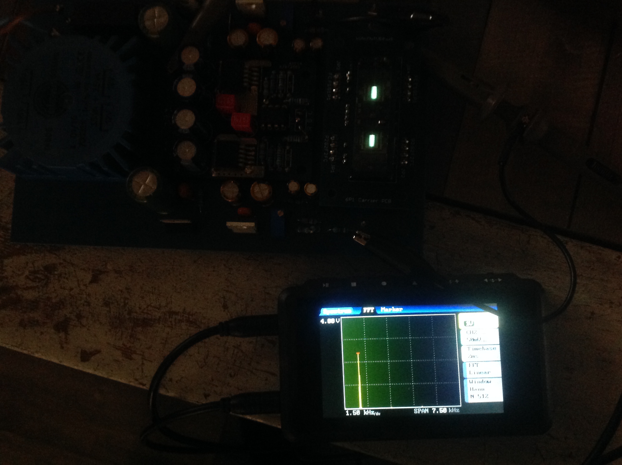

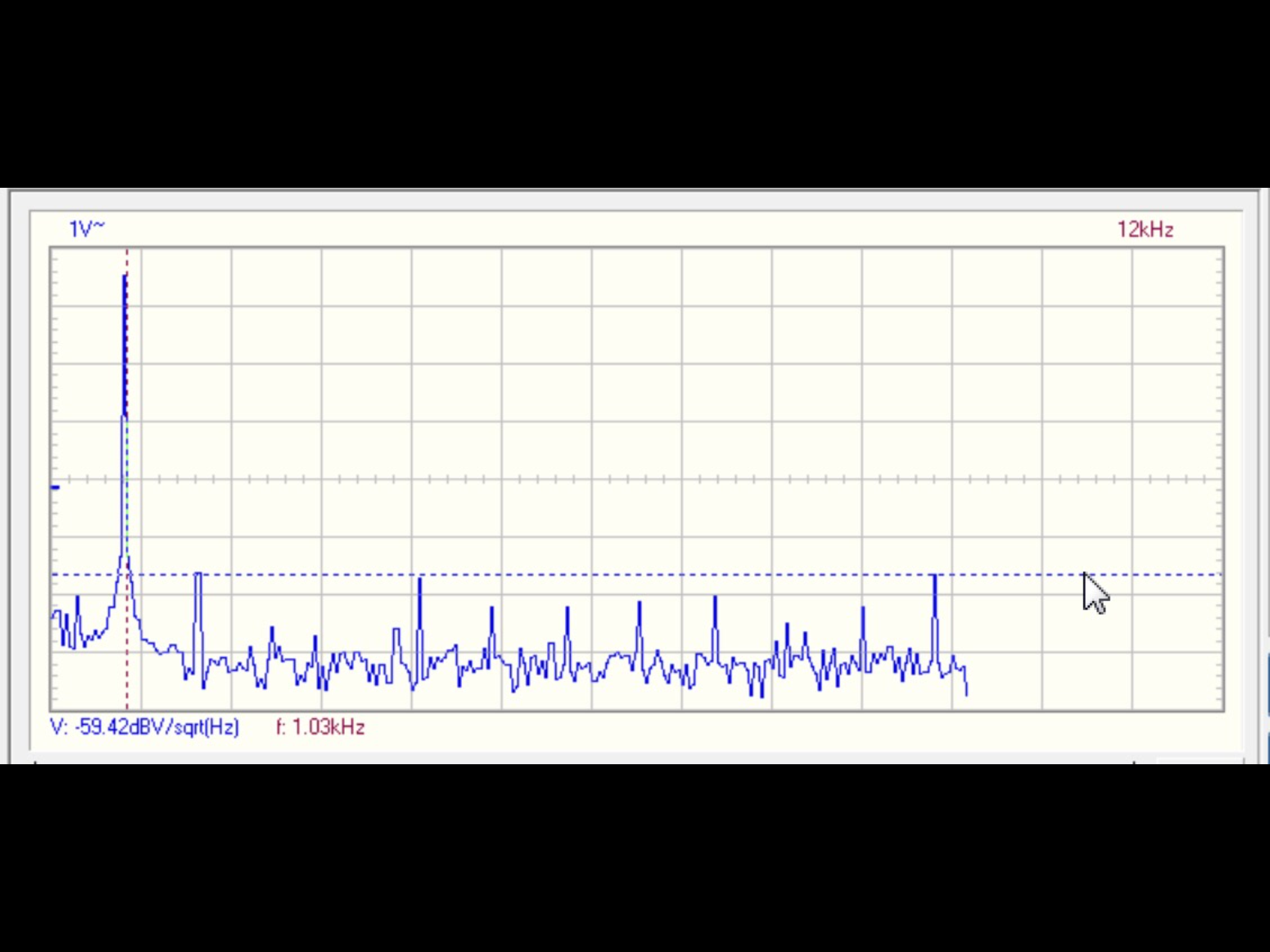

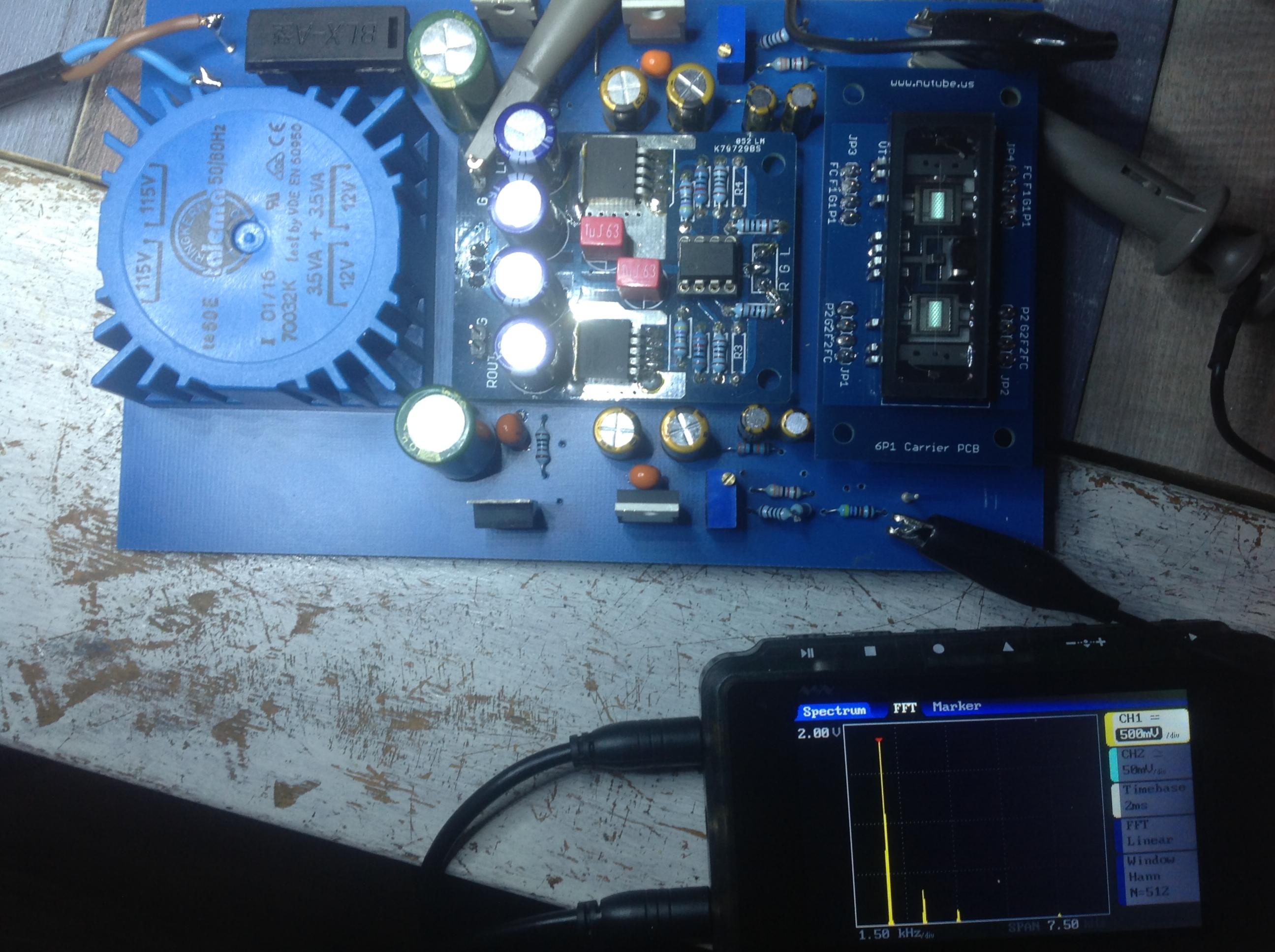

Played with harmonics by adjusting the bias.
I had very less harmonics with bias around 2.0v.
See the pictures with different harmonics.

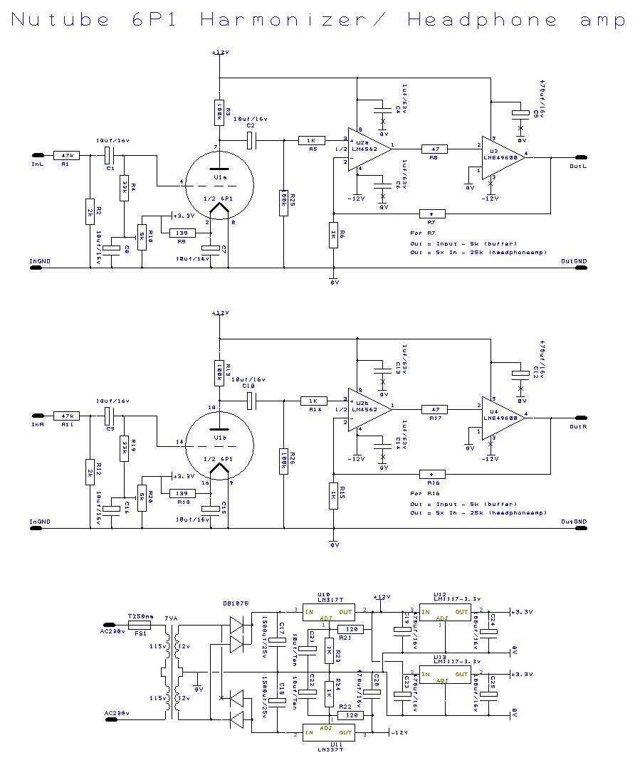

Heater voltage is 0.64v, Pete should i go higher with heater voltage?

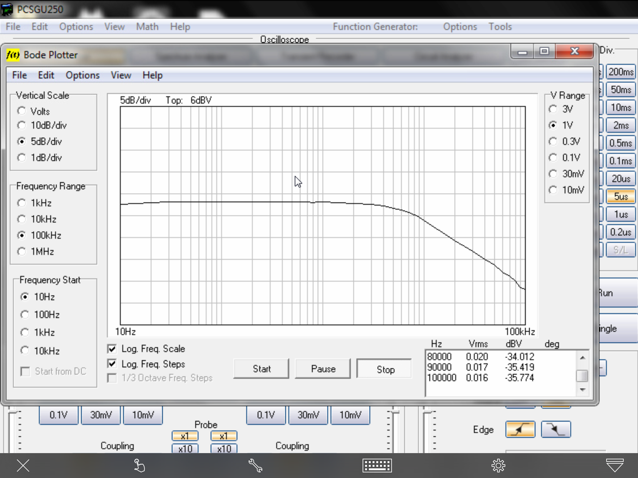

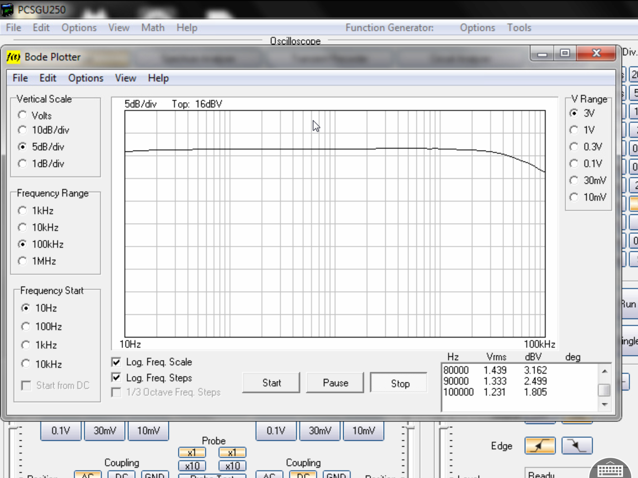

Solved it myself.
Just higher the heater voltage from 0,64 to 0,72v.
Frequency response now -3db at 60khz, just perfect,
I will do new harmonics measurements.

Harmonics at -59db, noisefloor below -80db.
So next some listening tests.

Interesting that it was so sensitive to filament voltage. That is one thing I have not tried varying. I guess Rp much be significantly higher at 0.64V vs. 0.72V.
This makes me wonder if the parameters can be further improved by running at the high limit of 0.8V...

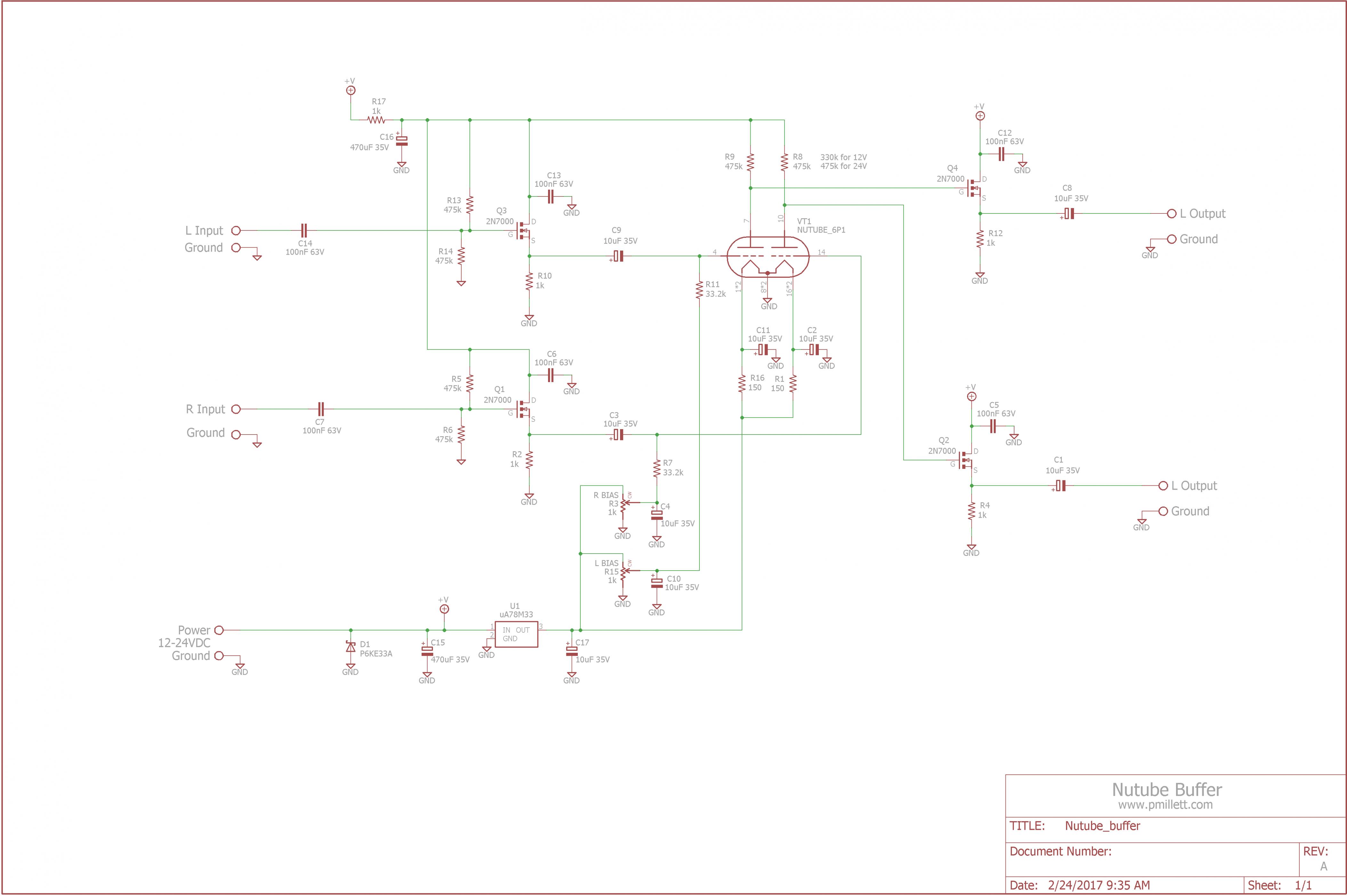

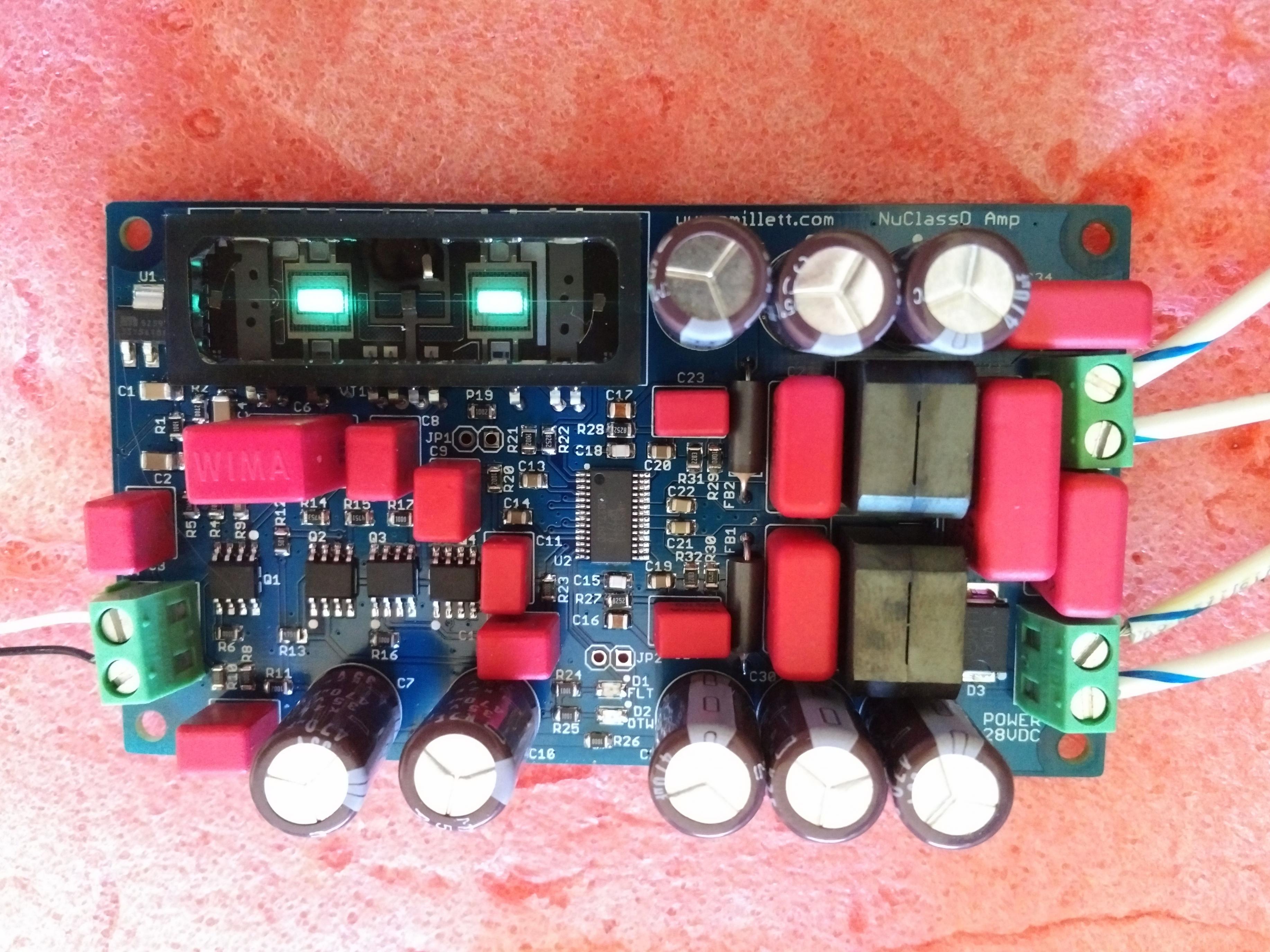

Are there any published schematics for a simple buffer or class-d amplifier front end, that don't include opamps? I don't have the ability to design these circuits myself, and the inclusion of opamps makes other circuits less attractive to me (I fully understand these are required for driving tricky loads). If there was the equivalent of the B1 buffer circuit - something simple and easy for people to replicate - I'm sure that would increase interest and demand. I've got two nutubes from Pete ready to go 🙂
I am working on a few reference schematics. Also an article is upcoming in audioXpress. It's pretty simple.
You typically need some kind of buffer on the input to drive the grid. I have used both a JFET buffer, and a small MOSFET follower. Either works well. If the input impedance of the class D amp is low (10's of K) you also need an output buffer - same idea, JFET or MOSFET.
I am attaching the schematic of the entire class-D hybrid amp I built (shown below). I used dual JFETs to buffer in and out, and a JFET phase splitter to drive complementary inputs to the class D. This preformed better than driving it single-ended.

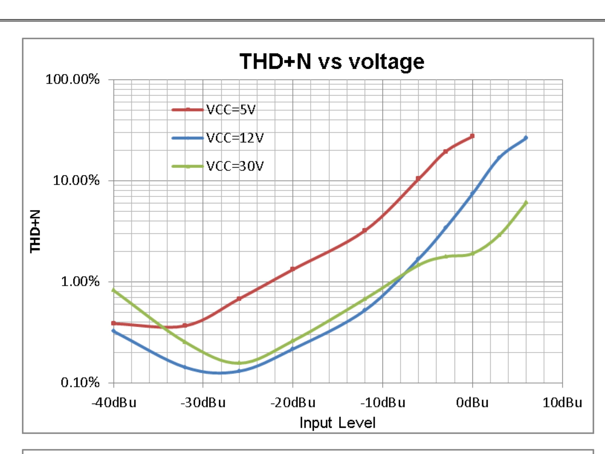

Pete,
looking at your schematics, i like to know how much distorsion does they have?
Because when i look at the chart at 1Vrms input you must have 10% of distorsion?
I did not need much gain, so there is some NFB around the tube - R4. So there is less distortion. At 1V RMS in, though, the amp is getting close to clipping at 50W.
I thought I had measurements of the whole amp, but can't locate them. I may have to run them again.
Pete

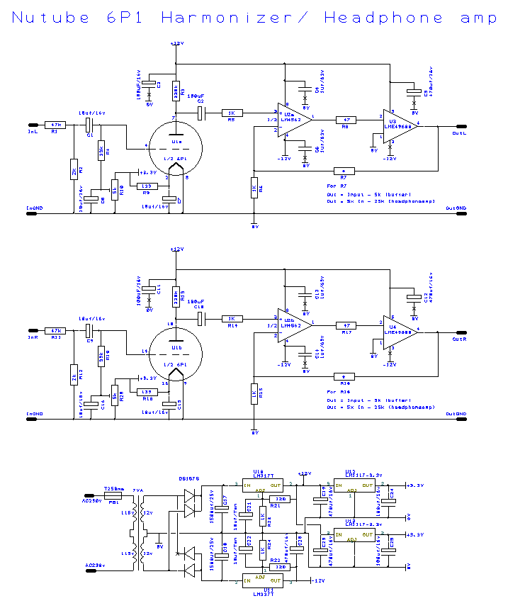

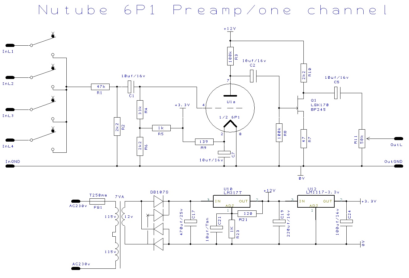

Below schematic i now use.
Differences to origenal:
- R3/R13 from 330k to 100k, Other working point, a little bit hotter🙂
- Ad R25/R26 behind output capacitor C2/C10 to ground to lower DC.
- Changed C2/C10 from 100uf to 10uf. They did not needed so big.
- Remove C3/C11 because they where not there in the first place.

Using the halves for stereo now, I see.
That MP7770 is an interesting amp chip, haven't seen it before. I suppose if you had a differential (balanced) input signal you could use the nuTube on each half of that signal, and no need for the phase splitter. That's a bit OT, so no need to pursue it.
