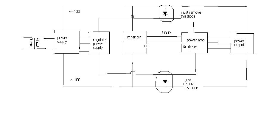

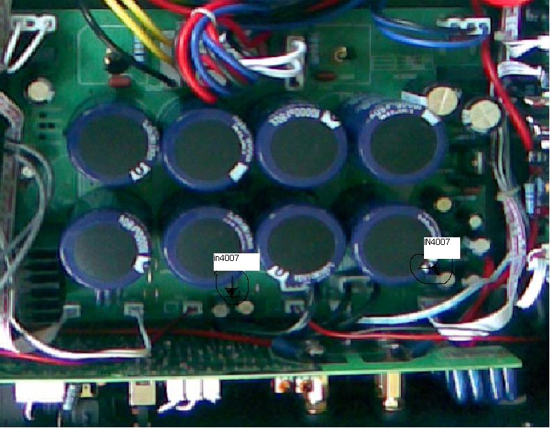

@lizgar
have you inserted all the sockets correctly?
please double check, the 108V +/- is fed to a voltage divider which serve as a voltage reference for the window comparator of the compress ckt. It is comparing the voltage swing of the output section against the rail voltages.

@lizgar,
sir that is a clamping diode is a part of the original design, something is still wrong with your amp. It may be working right now but on the other hand your compromising the reliability of your amp, are these diodes HER204?

@lizgar,
check the polarity of the diodes if they are the HER204, the cathode (the upper diode) side should be place on the Vcc+ (I am basing these on the diagram you post) the anode of the lower diode should be place on the Vcc-

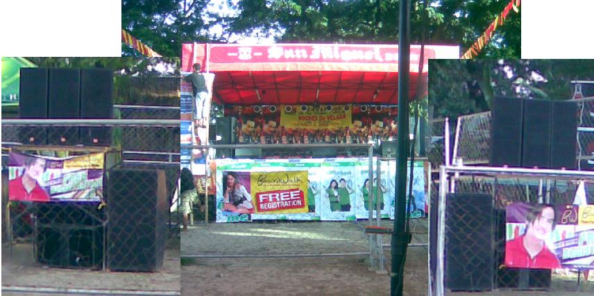

yes you have a very simple setup. i presume you have a total of about 3,000 watts (500watts x 6@) for your high and mids, and 2,000 watts(500watts x 4@) for your subwoofer. Is it a band playing or just a rally?
this just a ponda mins preparing for a night show for coming fiesta... for mid i used 6pcs. 12" 450w dual magnet (konzert) n 3 pcs. hi comp. tweeter 450w (Crown). 2pcs. 15'' sub 450w(crown). and 1pc. 18'' wbin sub. 1000w (crown) PER SIDE. 1 amp. for hi (150wx2). 3amps. for mid (600wx2) and 1 amp for sub. (1000wx2)
