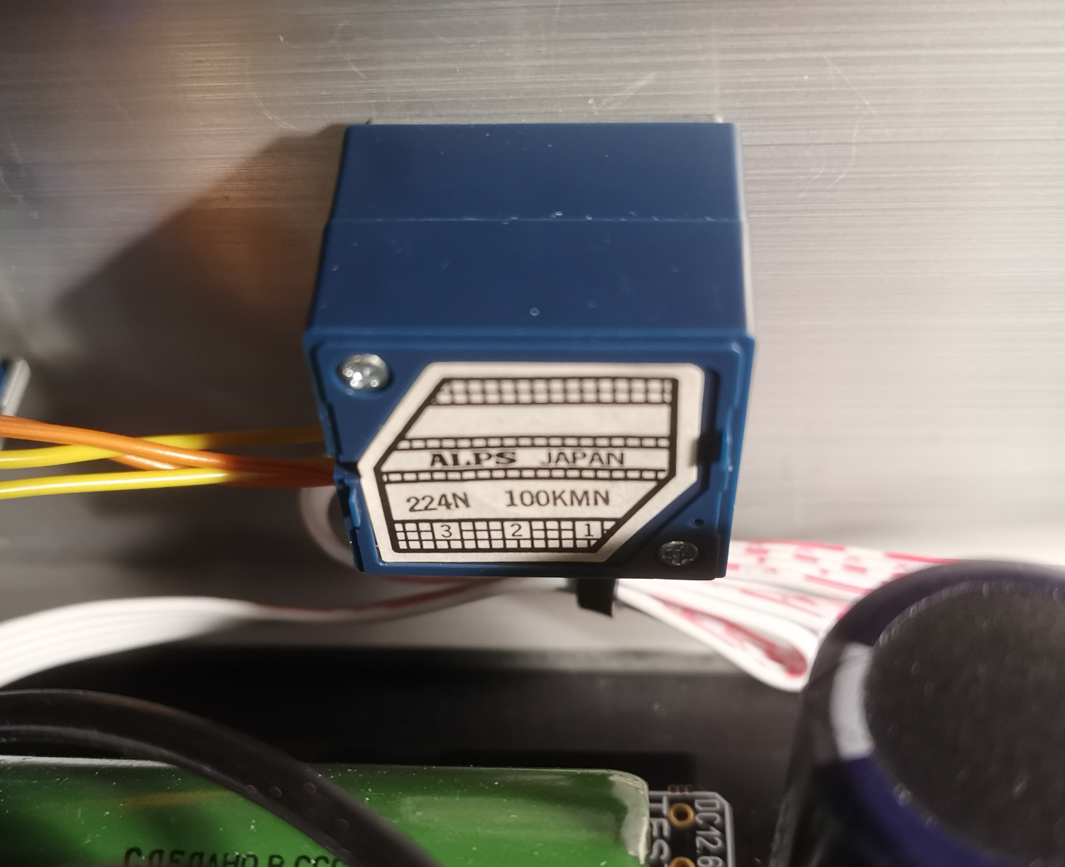

Just to follow myself up. I just realised that there is something called a balance potentiometer (MN-taper), and that I had bought one some time ago without realising what it was. With some experimentation and measurement with my multimeter I managed to wire it to the M77 pcb. It seems to function properly. I think. It attenuates 3.5 dB maximum, which should be enough to to adjust for a slight asymmetric listening position or some imbalance in the sound.

In old commercial gear I found that the stereo volume imbalance was usually worse at low volume so you just have to play loud :D. I often wondered if all it needed was a fixed value resistor on the one channel. I guess youll find out if you need to adjust the balance once its been set.
I'm more thinking about any imbalance in the source (real or perceived). The preamp channels are very equal (which might be luck?).
The imbalance I’ve noticed in the past with commercial amps is not the electronics because they are feedback designs which have gain match guaranteed by resistor tolerances, but rather in the stereo volume pots which often struggle to match an audio taper. The expensive one’s are usually tested and selected out at the factory, e.g. TDK pots are very well matched. I recently bought a stereo audio pot 500k Ohm from ebay, which looks like blue Alps but
