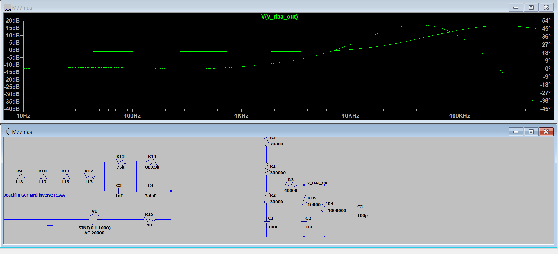

please check this simulation, it shows the new values (the 20800 Ohm resistor is the plate resistance of the previous stage, please ignore).
In essence, good enough to change the 33k to 40k or 50k, and add 10k resistor in series with the 1nF capacitor. This simulation was verified with measurements and corresponds very well.
It gives pretty flat response, and sounds tonally very correct. But taste and opinions vary 😀

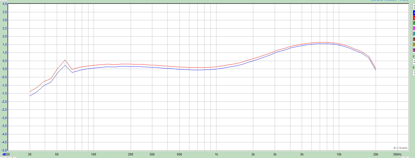

Attached is the measurement result of the original value version. Dont worry about the 50Hz peak, thats due to the setup (hum). You can see strong lift in upper midband. Measurement with my modified values is flat 😀
Soundwise, I found this to be rather significant - very much in your face, getting on my nerves were the impressions I remember. Instruments sounded overly sharp and unrealistic. This was confirmed by a good friend of mine who plays cello and he didnt like it too.
But hey, its just a couple resistors - you could actually put a trimpot and adjust to taste 😀

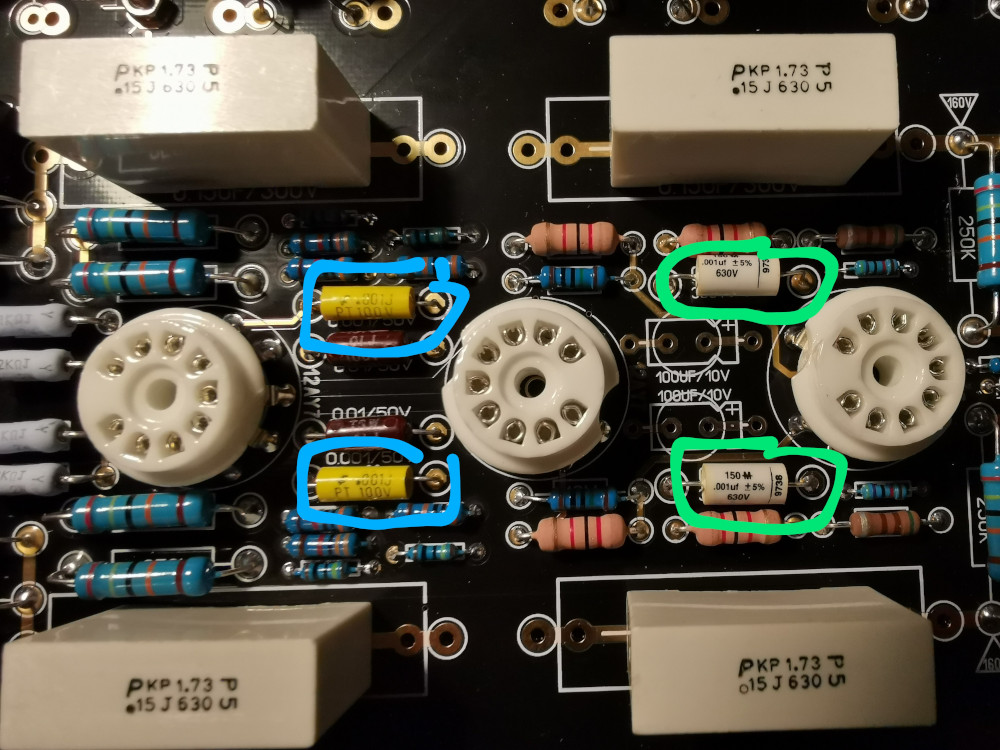

I've started building my M77 clone kit, and have a couple of questions.
  1. 1 The kit came with a 1nF capacitor instead of 10nF as is printed on the PCB (see capacitor and position on PCB circled in green). What difference will this make?
  2. 2 I going to do this modification "change the 33k to 40k or 50k, and add 10k resistor in series with the 1nF capacitor." Just to make sure. The relevant capacitor is the one I have circled in blue?

to your question1: most likely it will not make a difference. but if you can get larger caps it would be good, exact value doesnt matter much in my opinion.
question 2: yes that is the right cap. i just desoldered one end and added the 10k resistor with a flying connection.
it pays a lot in sound quality IMHO to replace the 300k/33k/40k or 50k/10k resistors with good quality types (dale rn65 or55, PRP come to mind) and the 1nF/10nF riaa caps with better types as well (silvermica, kemet pps2, .....). if you do, try and get more, to be able to measure and select for identical values for left and right channel, as much as possible. correct absolute value is good, but low deviation L/R is even better 😀
and , while you are at it, replace the coupling caps (the big caps with 0.15/0.22uF) with high quality caps as well. i used jantzen silverfoil, but there is lots of choice and opinions vary 😀
for the output cap it doesnt hurt to put 1uF for good bass.
hope that helps!
