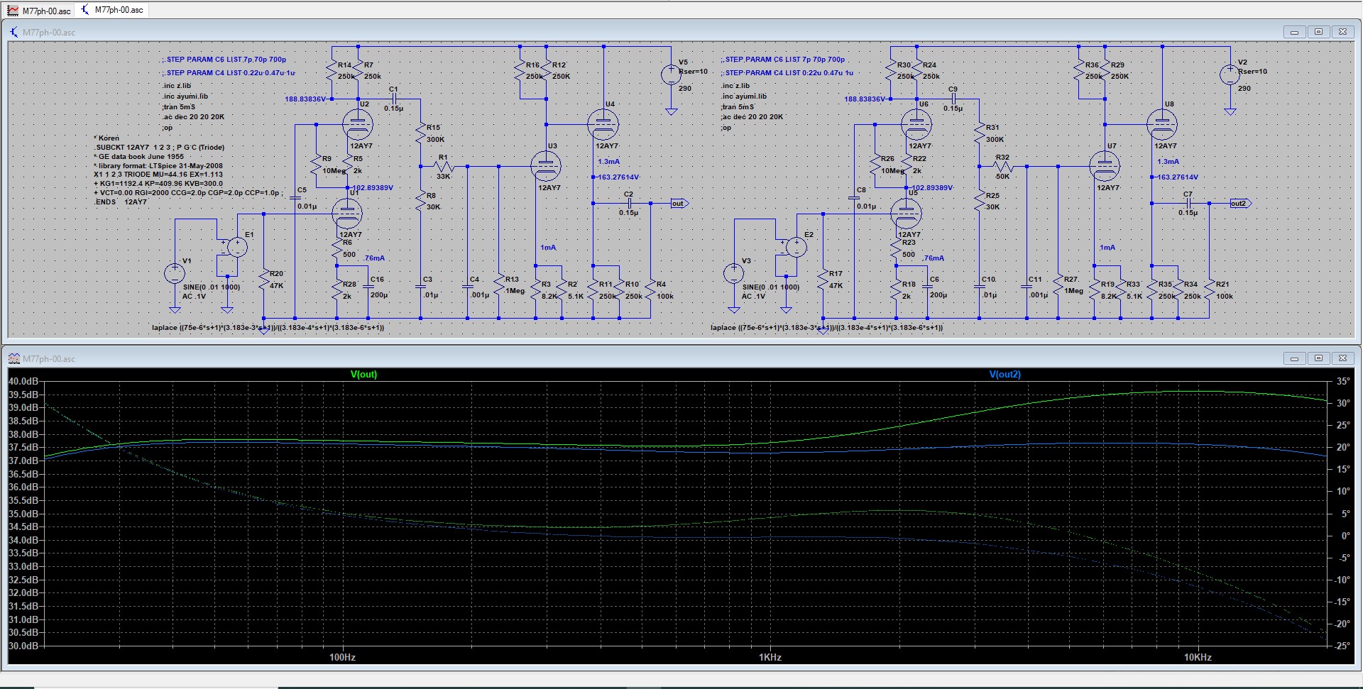

yes exactly. and if you do the math, or simulate, it is all correct except the 33k resistor which really should be 50k. So, this resistor needs changing.
Plus, if you want to add the "neumann" constant, you need to add the additional 10k resistor. It will give a boost of 2-3dB at 20kHz. This topic is hotly debated and I am not going to add any opinion here, only that to my and my friends ears, it sounds better if you add this in.
:up:
Here's what the Sim gives: green: 33K, blue: 50K. About +/-0.25dB. If you want better, you can, just invest a lot of time.

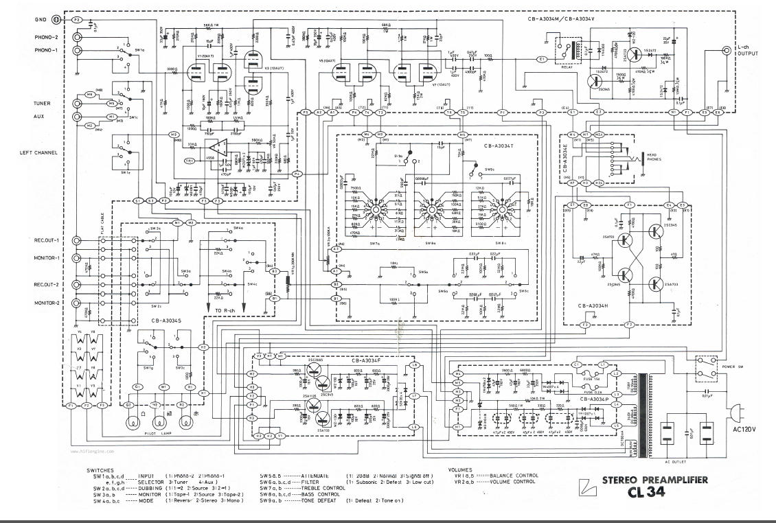

Fillament lifting or capacitor multiplier are better than regulators on fillament.Capacitor multipliers work in luman , they should work everywhere.I'd use a darlington transistor there as today they are largely available.

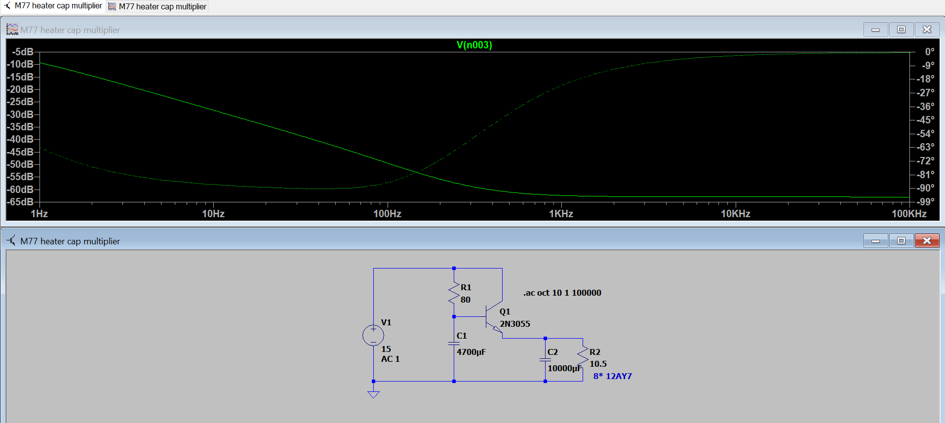

this clone also uses a cap multiplier with the big bipolar transistor. It is not very effective, though. The trimpot is used to adjust the tube heater voltage a little bit, and obviously affects the noise suppression capability of this circuit.
Using an external regulator, in combination with the filament lifting already implemented on this PCB, should definitely reduce the hum.
quick sim shows -43dB at 50Hz as per attached picture, not great but at least some help. (I used ESR of 0.1Ohm for both caps)
What is a little worrysome is the current in the trimpot (30mA), caused by the not-so-great current gain of this transistor. Power dissipation in the trimpot is quite high, albeit still in acceptable levels, but I wouldnt be surprised if it fails after some time.

Luxman is using two darlington transistors for the same number of tube fillaments as ksl m77 ...you could use triplets if doubtful :) , but transitors with hfe=15000 are easy to find.I can only tell i have built a Luxman clone already with even higher fillament current demands(12bh7 instead of 12au7)and the multipliers work very well.

Good point. I simulated with a darlington configuration, and it reduces noise by >25dB, easy enough modification. Will try it on my preamp and let you guys know!

So, here is the deal: I used a BC337-40 in darlington configuration with the built-in 2N3055, and 100Hz noise reduced by 17dB, 200Hz noise reduced by 8dB.
So, the improvement is there although not massive. For fun, I simulated a little regulator with the TL431 and that should be much better. not sure when I have the time to test....
