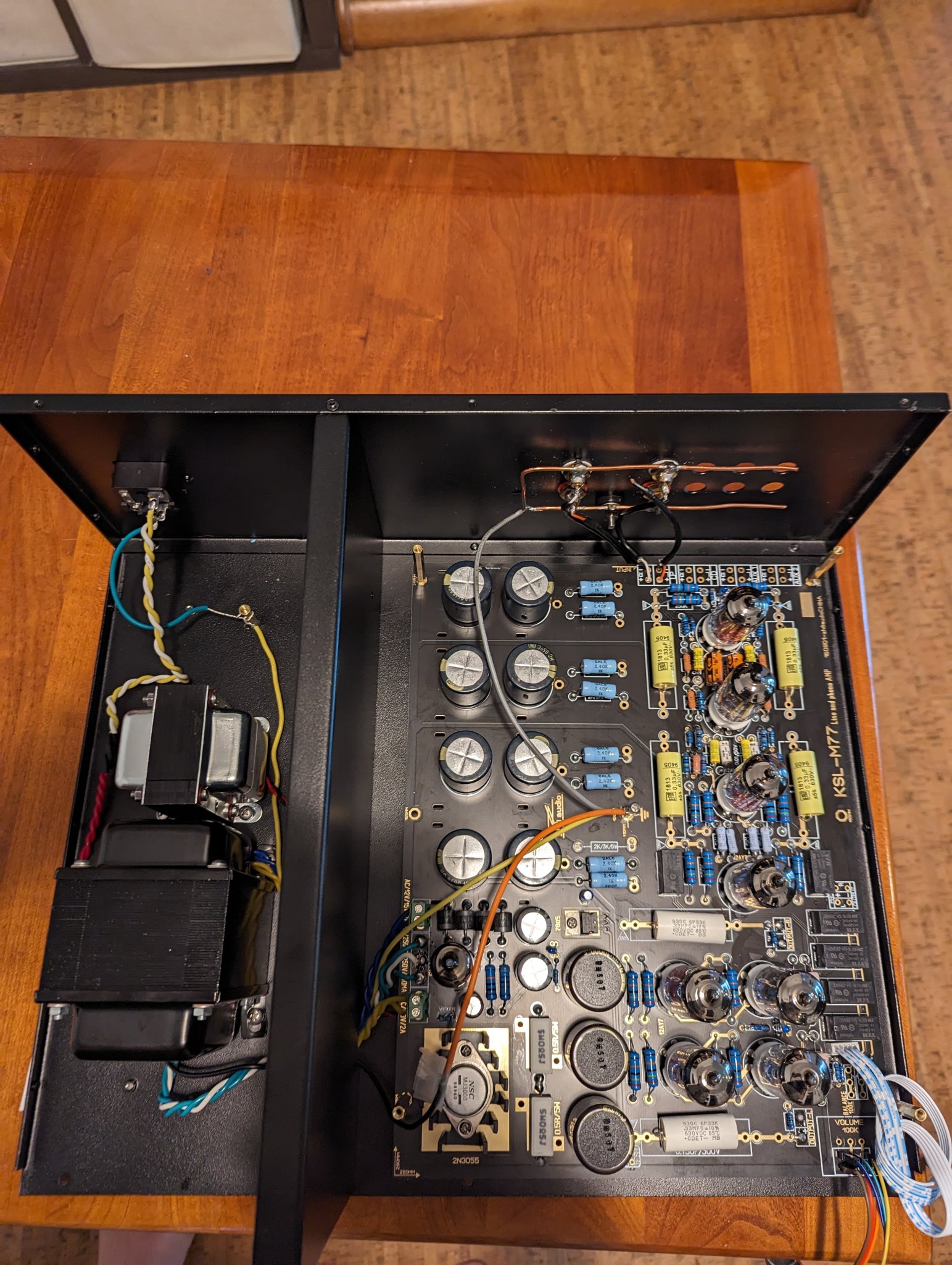

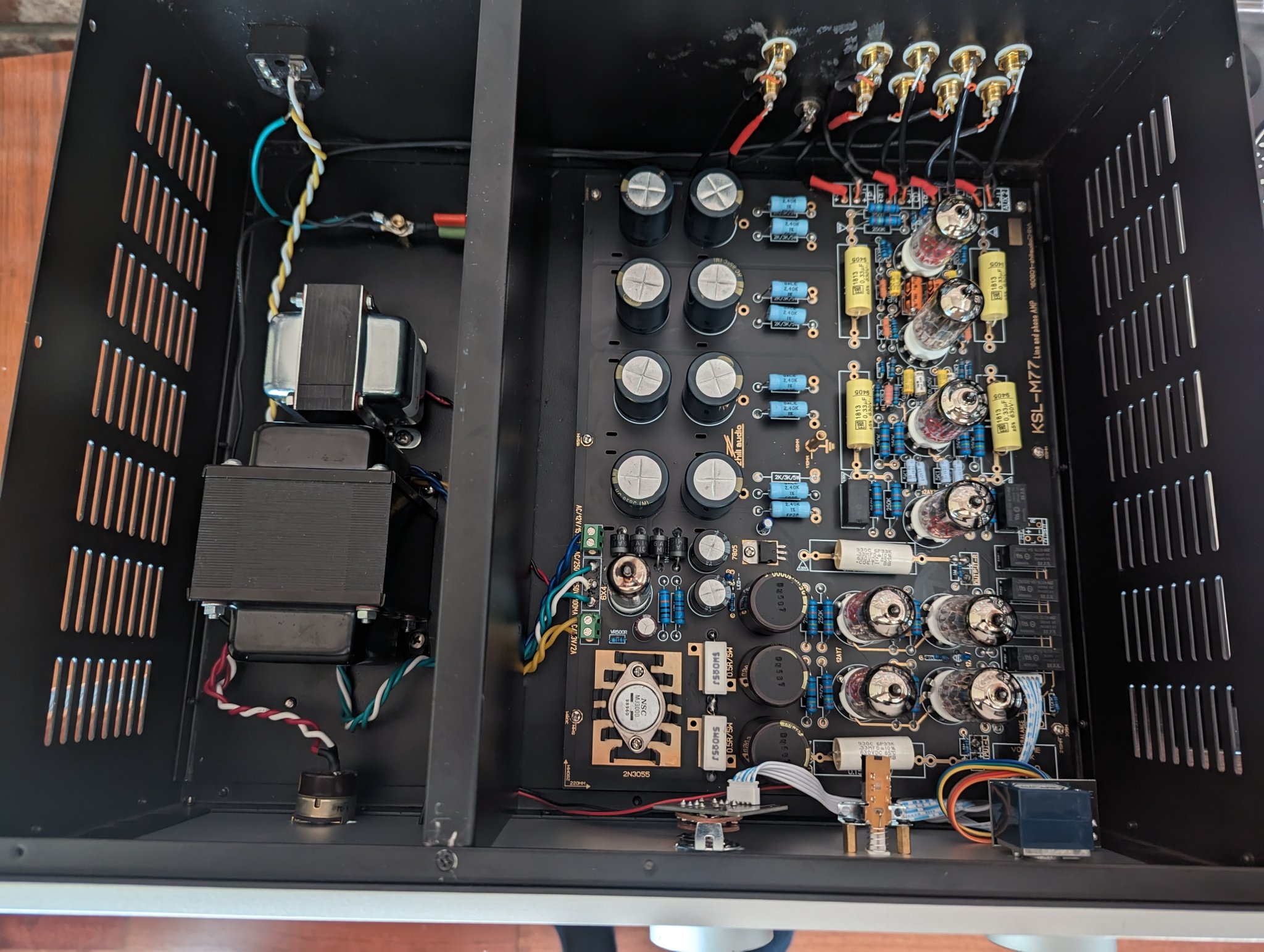

This Friday I got my kit from China. Here is my build. Waiting for a 6x4 rectifier tube replacement to continue testing.

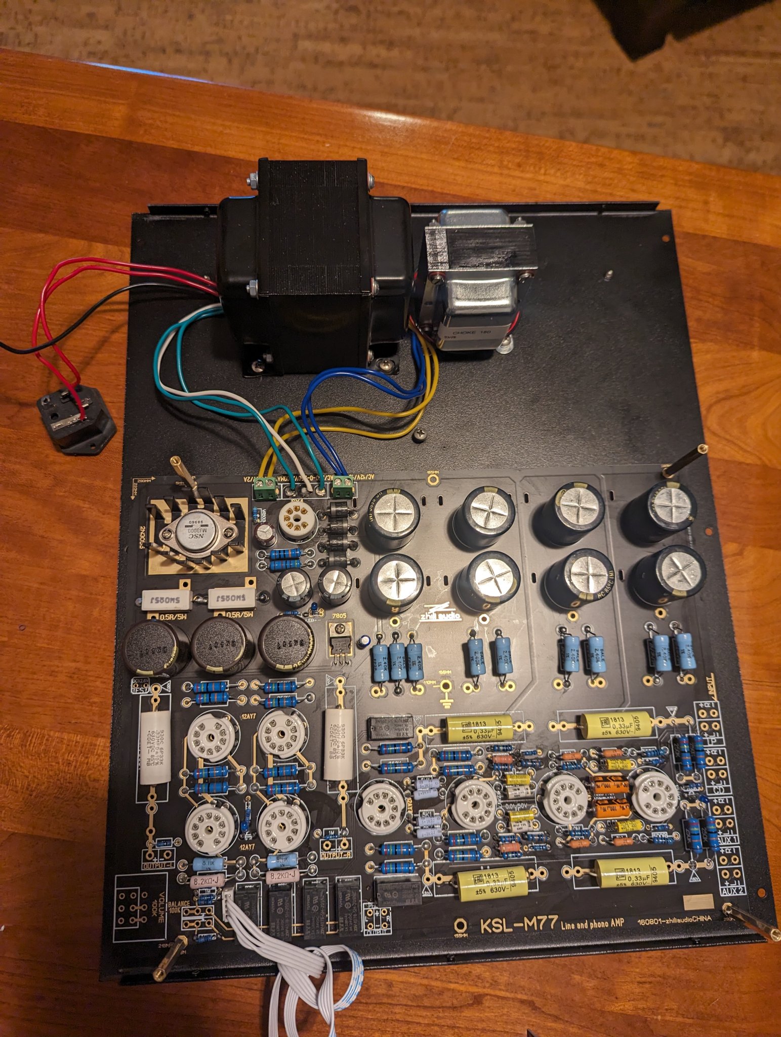

looking at the board and the components i got. For the balance potentiometer on the PCB, do I need to add more resistors in the area since I am not going to use a balance potentiometer?
In the package I got a Mute switch, the front panel has a spot for it, therefore I will have to install it. Where or how do I wire this Mute switch?

I have a 60Hz hum. I did the filament power modifications as advised. I used shielded cables for connection. The PCB is ground is connected to the case. Ground for the power line is connected to the case. I used the star ground scheme with the star point on the PCB.
My speakers have a high sensitivity and the hum is much more noticeable due to high sensitivity at 103dB.
I am not an electronic engineer and I don't understand all of this. Typically the power line hum is coming from the filaments or from the HT power?
I am open to suggestions

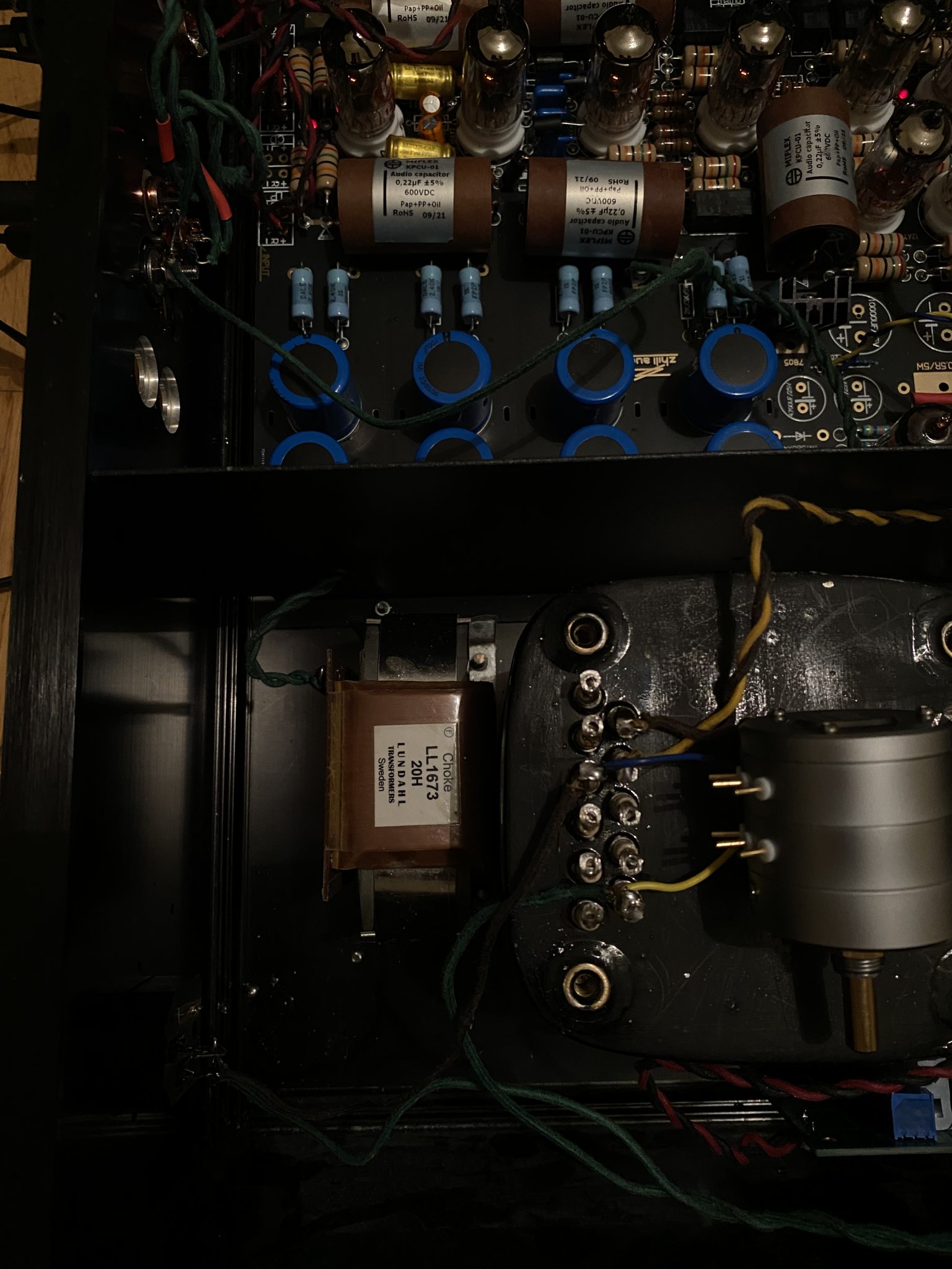

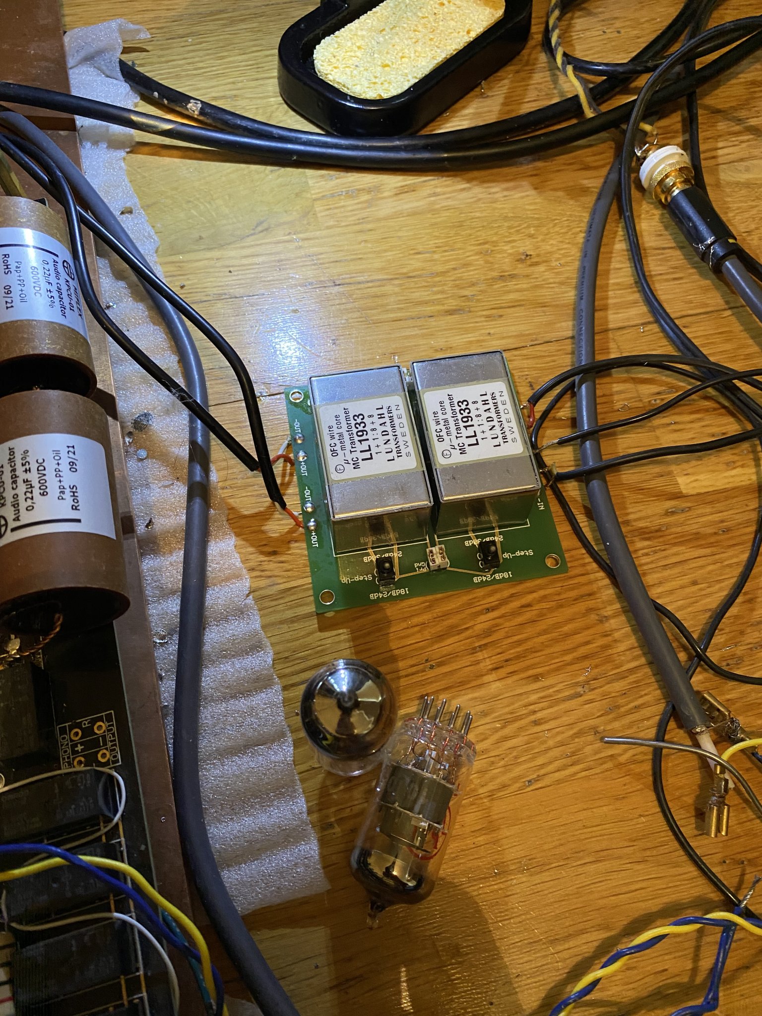

(I use Lundahl ll1933 but this have ( Huuum)and noise!
Isend photo now , i hope you help me 😉

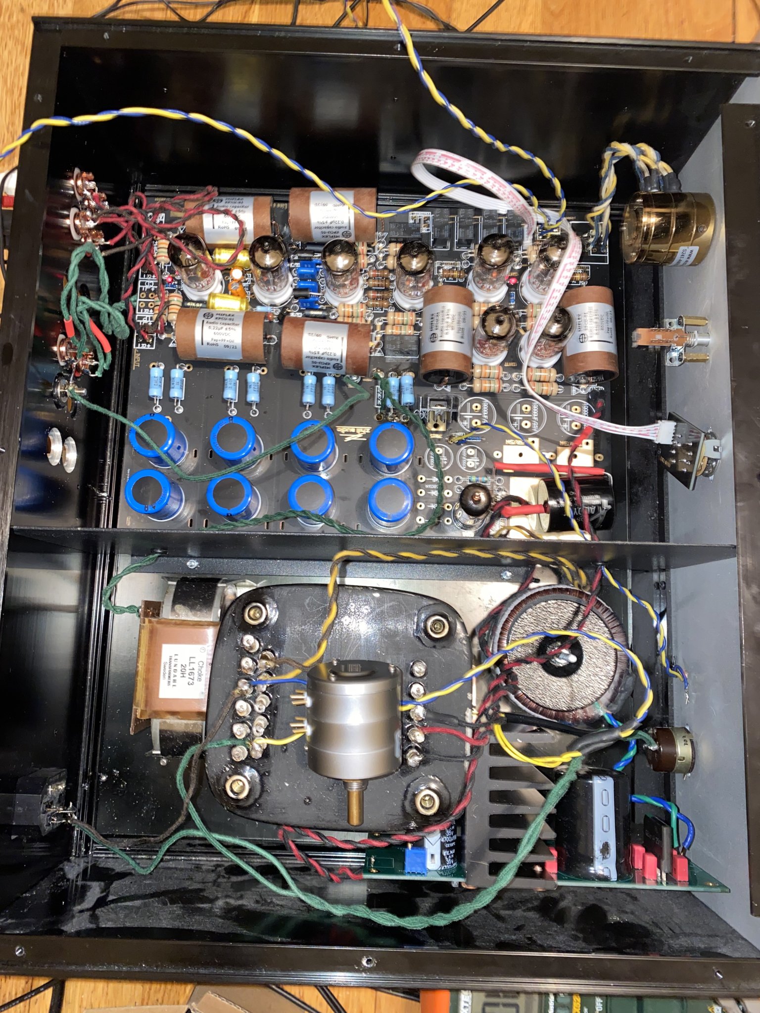

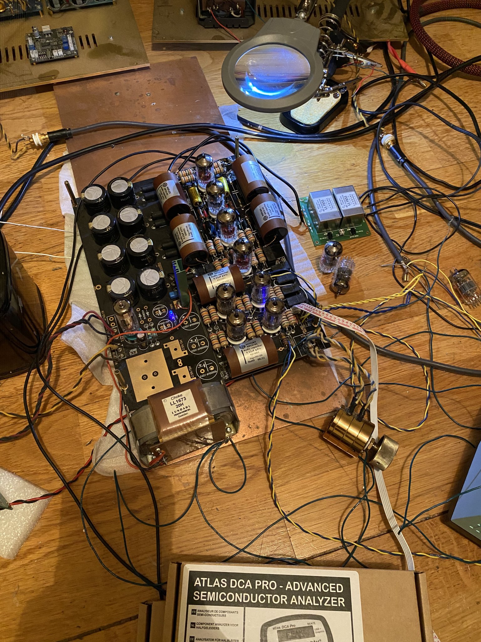

Finally got around to take some pictures of my build, please see attachments. I tried to use copper where possible, just like in the original 😀
Also, fully potted mains transformer attached with springs and foam, a line filter, and additional bypassing on the supplies (the small black film caps).
You can also see the MC input transformers on the backside, giving me both asymmetric and symmetric inputs. The symmetric outputs are connected asymmetricaly for the moment, work in progress..... The volume pot is a chinese stepped attenuator, works fine in my opinion.
The coupling caps are Jansen silver caps, and the RIAA caps are Silver Mica. Wiring is done with silver coated solid copper and cloth isolation.
Enjoy 😀
I noted you have a resistor on the RCA inputs. What is the purpose for it, and what value are those resistors?

Those resistors should discharge any DC coming from a source, as I have noted a clicking sound when changing the input. 100k in my case, but they can be anything maybe up to 500k.
Finally found out the clicking noise is caused by something else (relay decoupling)...... This can be cured with a diode in parallel to the relay coil, with the cathode to "+"

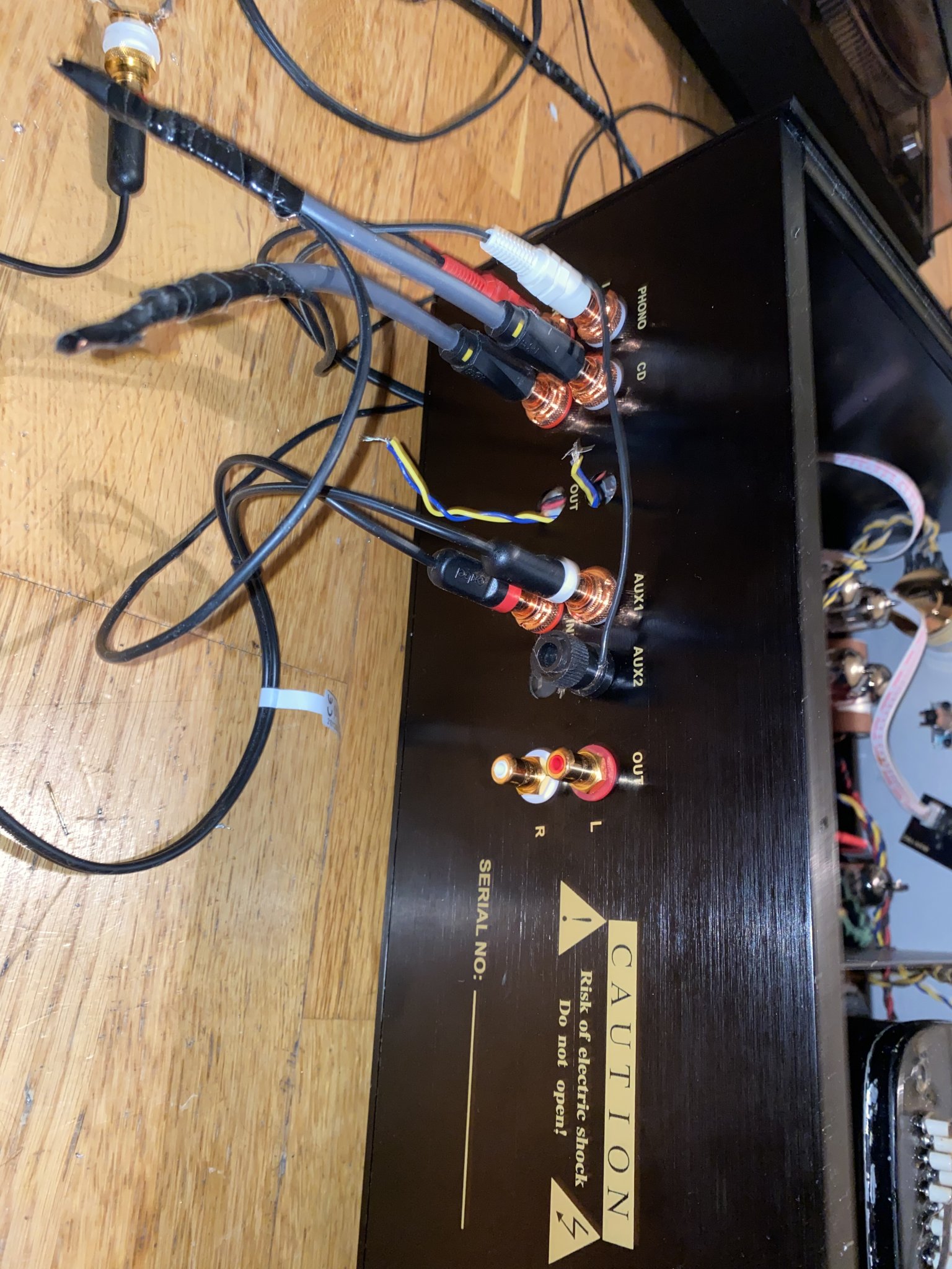

Just found out that my clone is showing a mysterious issue: When something is connected to the LINE input, but the input selector is switched to PHONO, there is a small but noticeable coupling that can be heard at the output (need to turn up the volume though). It is clearly coupling into the phono stage as the sound is muffled because of the RIAA correction. This is despite the input relays short-circuiting all other inputs when not selected.....
Anybody else have that problem????? Guess it could be solved by routing shielded cables directly to the relays, but I wanted to ask if anybody else has that issue.....

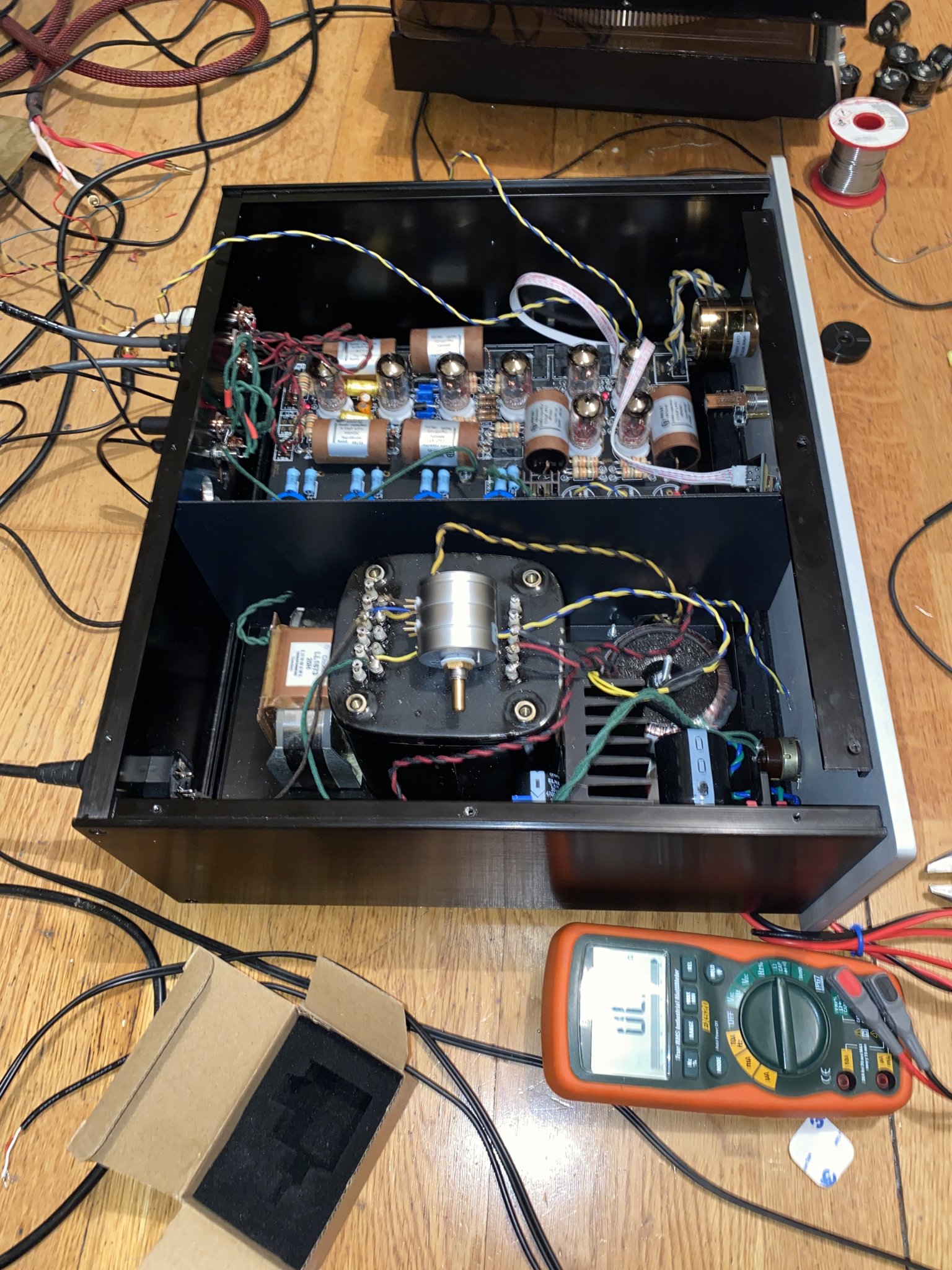

My preamp! Finish and this pre dont have noise !
I use vintage NOS Gresham oli transformer

excellent. I noticed you are not using the build in filament power, what do you use for filament power supply. I think my problem is with the filament power, I did do the modifications as described by hesener but I think I need something better
Reactions: tomashans
use LT1963A reglator !
