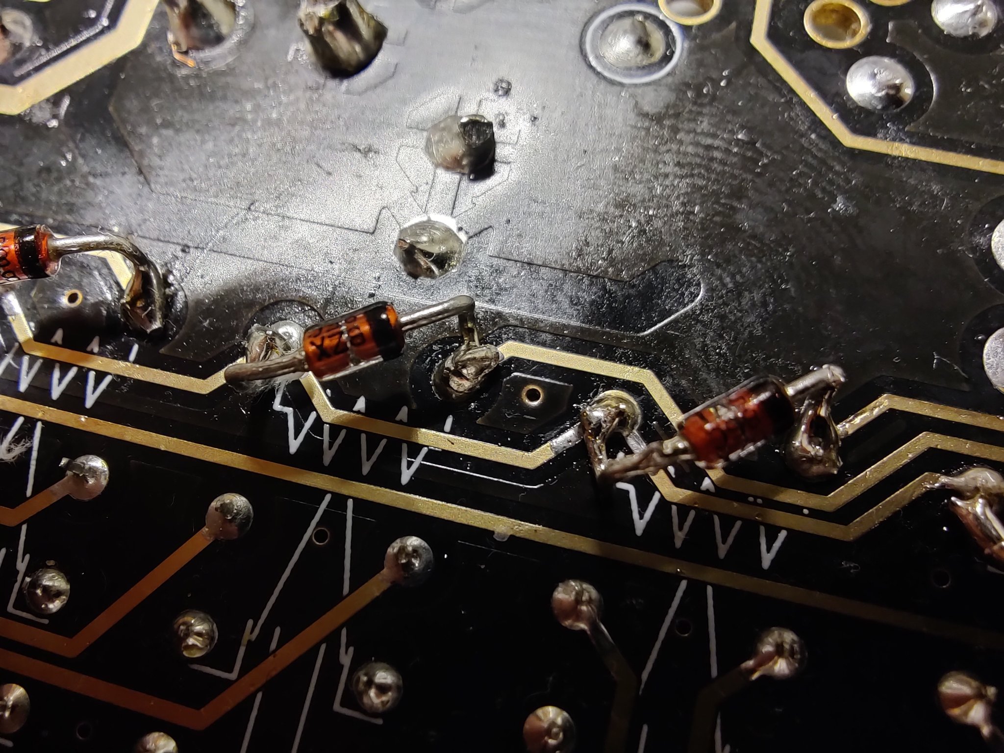

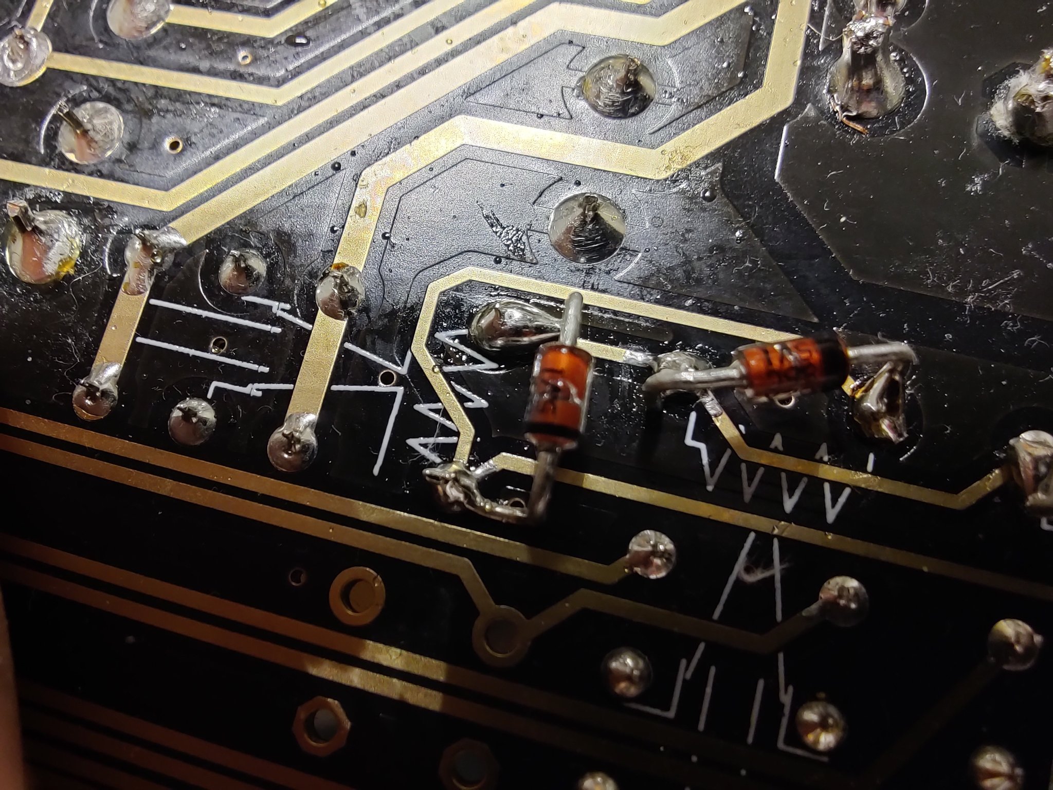

Those resistors should discharge any DC coming from a source, as I have noted a clicking sound when changing the input. 100k in my case, but they can be anything maybe up to 500k.
Finally found out the clicking noise is caused by something else (relay decoupling)...... This can be cured with a diode in parallel to the relay coil, with the cathode to "+"
Based on your suggestion,
I simply soldered in Zener diodes. 5.1V-1.3W (BZX 85C 5v1).
No more quiet cracking in the speakers.🙂

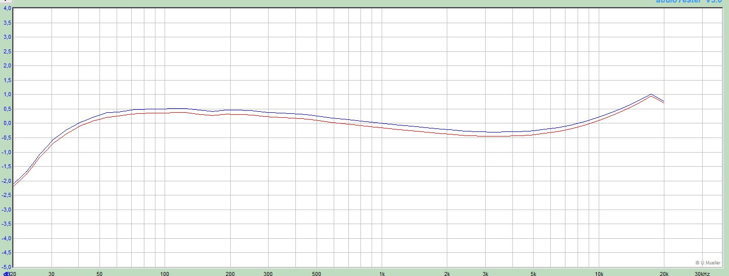

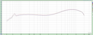

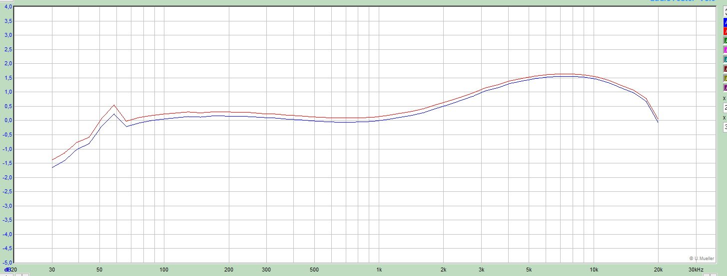

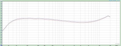

Here is the RIAA response of my build, including the modifications indicated earlier in this thread, with the Neumann modification. The channel imbalance is due to my slightly sloppy setup, I should have calibrated the two channels before measurement, but that does not affect the frequency response, fortunately 😀
the other picture is the RIAA response of the original network. I did not spend too much time analysing and interpreting (so I am not sure where that LF hump is coming from), since after simulating it was clear that some adjustments are needed.....

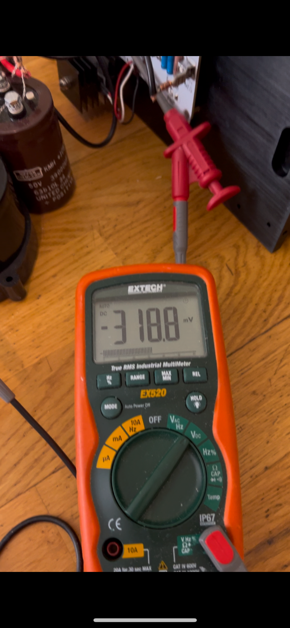

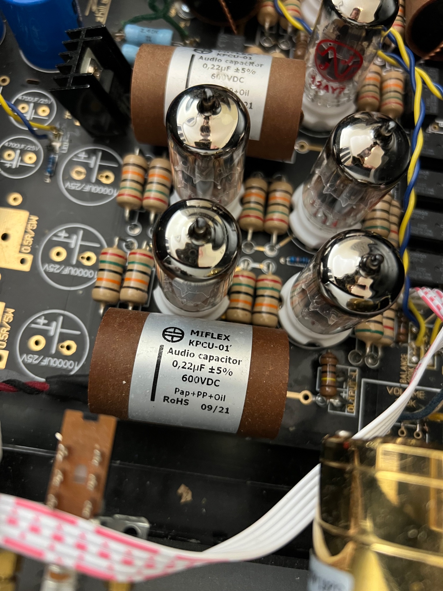

Maybe leaking output caps in the preamp; try to measure the preamp output with no connection.
Assuming you're talking about the Hiraga 20W Class A amp, its input impedance is only 10K: not a good match for a tube preamp, but that's off topic.

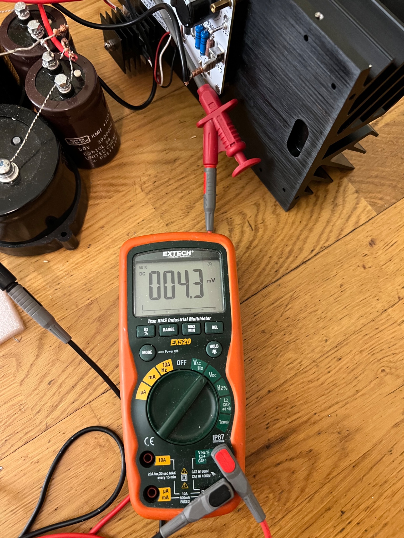

I test all cap they work well , when i test my preamp without connect to amplifier, dac anything my pre have -15mV +15 mV and no stable DC in output .
That's exactly the problem: assuming the poweramp has a DC gain of maybe 20, times 15mv = 300mV.
In any case, it's a very poor match: the 0.22uF with the 10K input impedance makes a hipass filter at about 70Hz, and the preamp will have high THD because of the heavy load.
