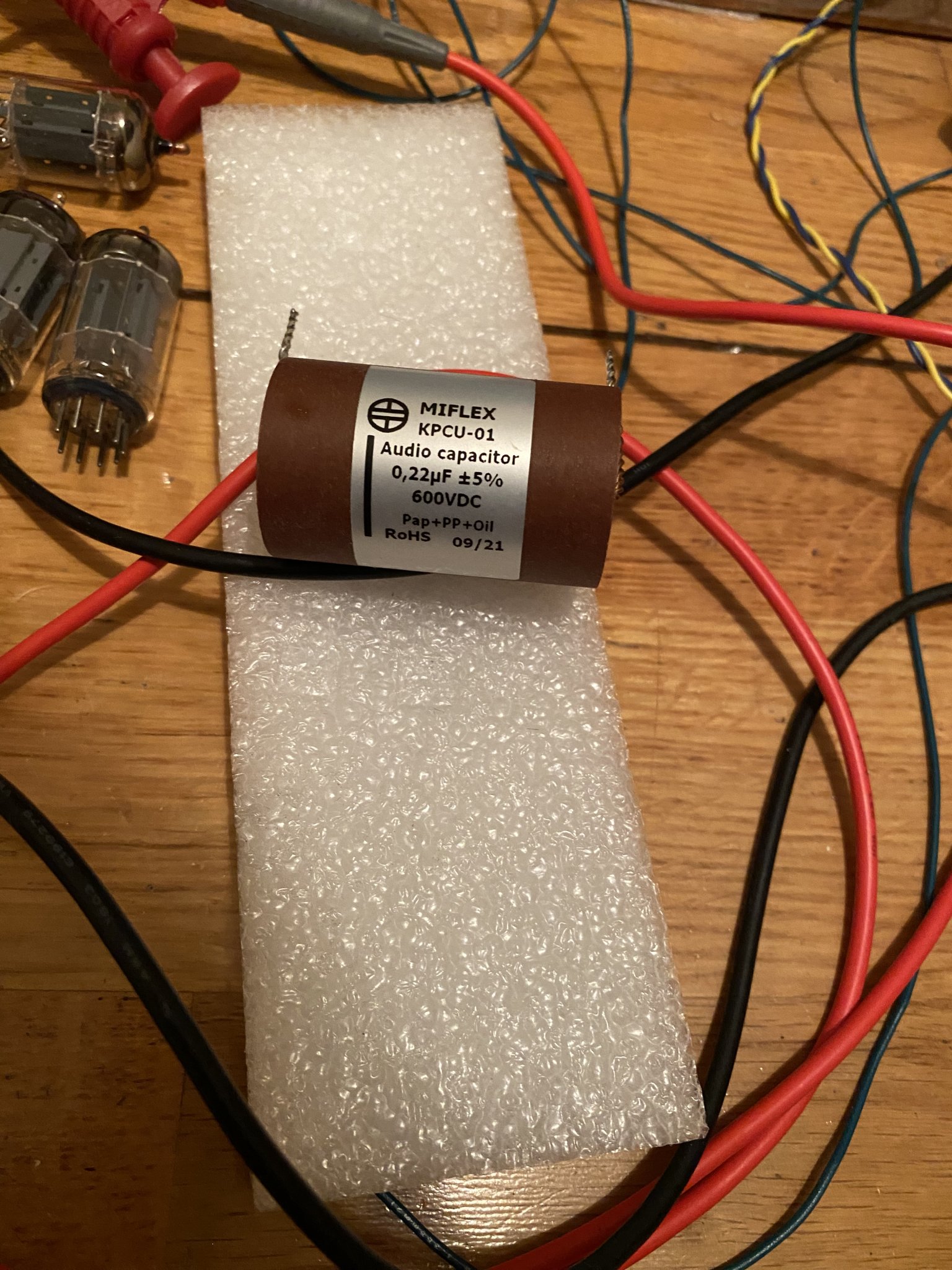

You need to give a bit more information and some pictures. Is the noise happening at all level of the volume, does it happen when the phono preamp is connected or even when phone preamp is not connected . i use 0,22uf cap for phono stage

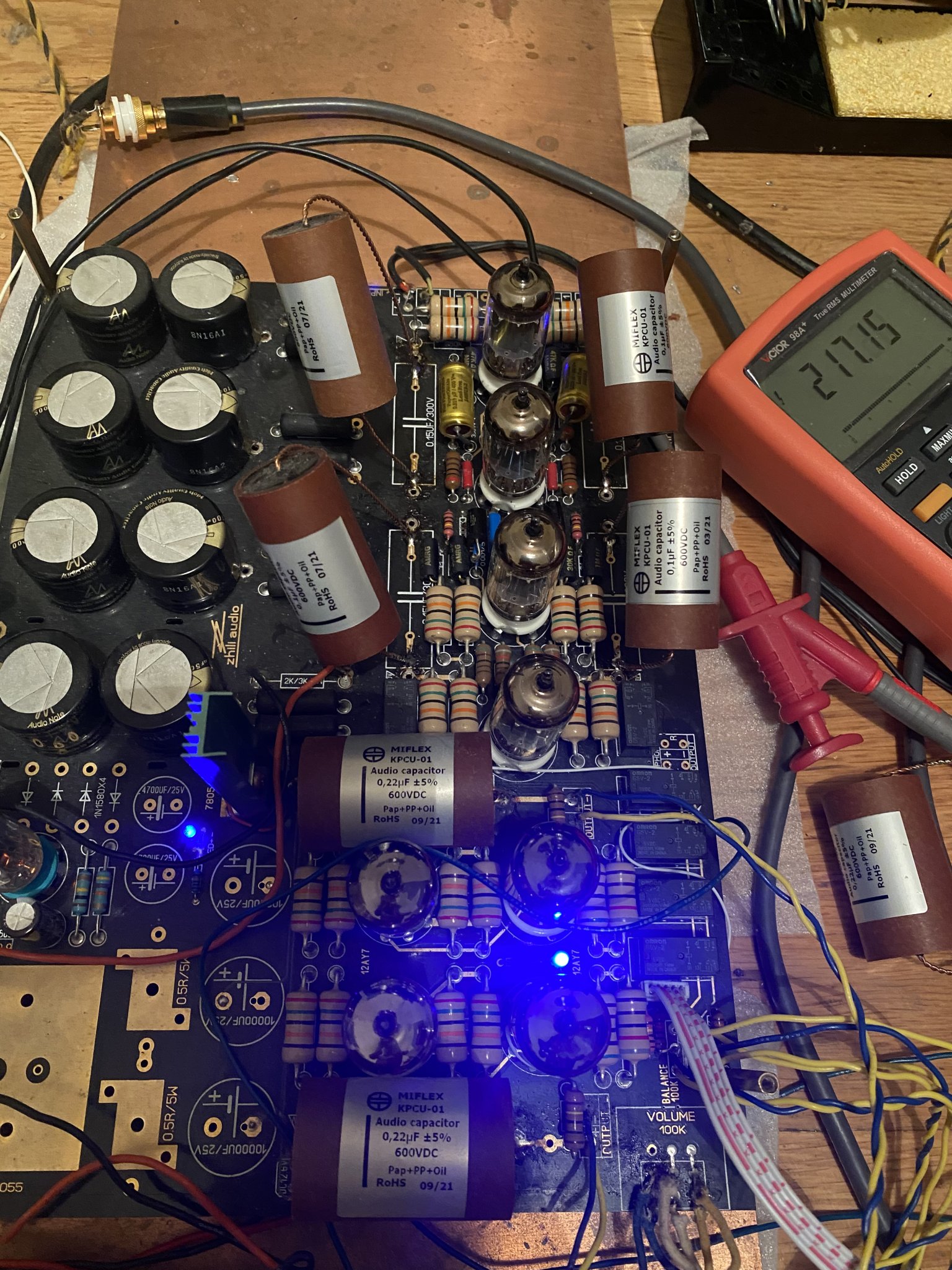

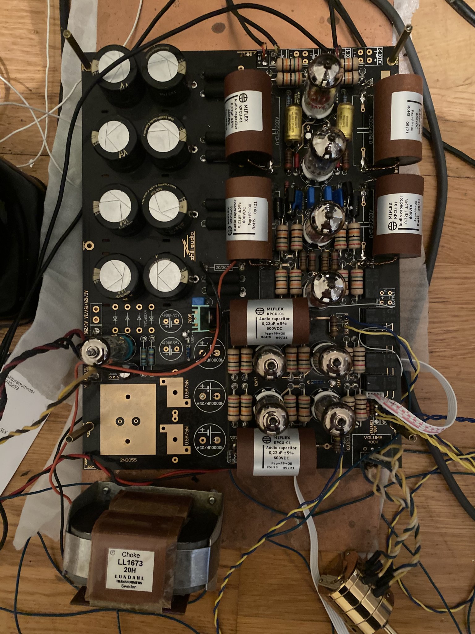

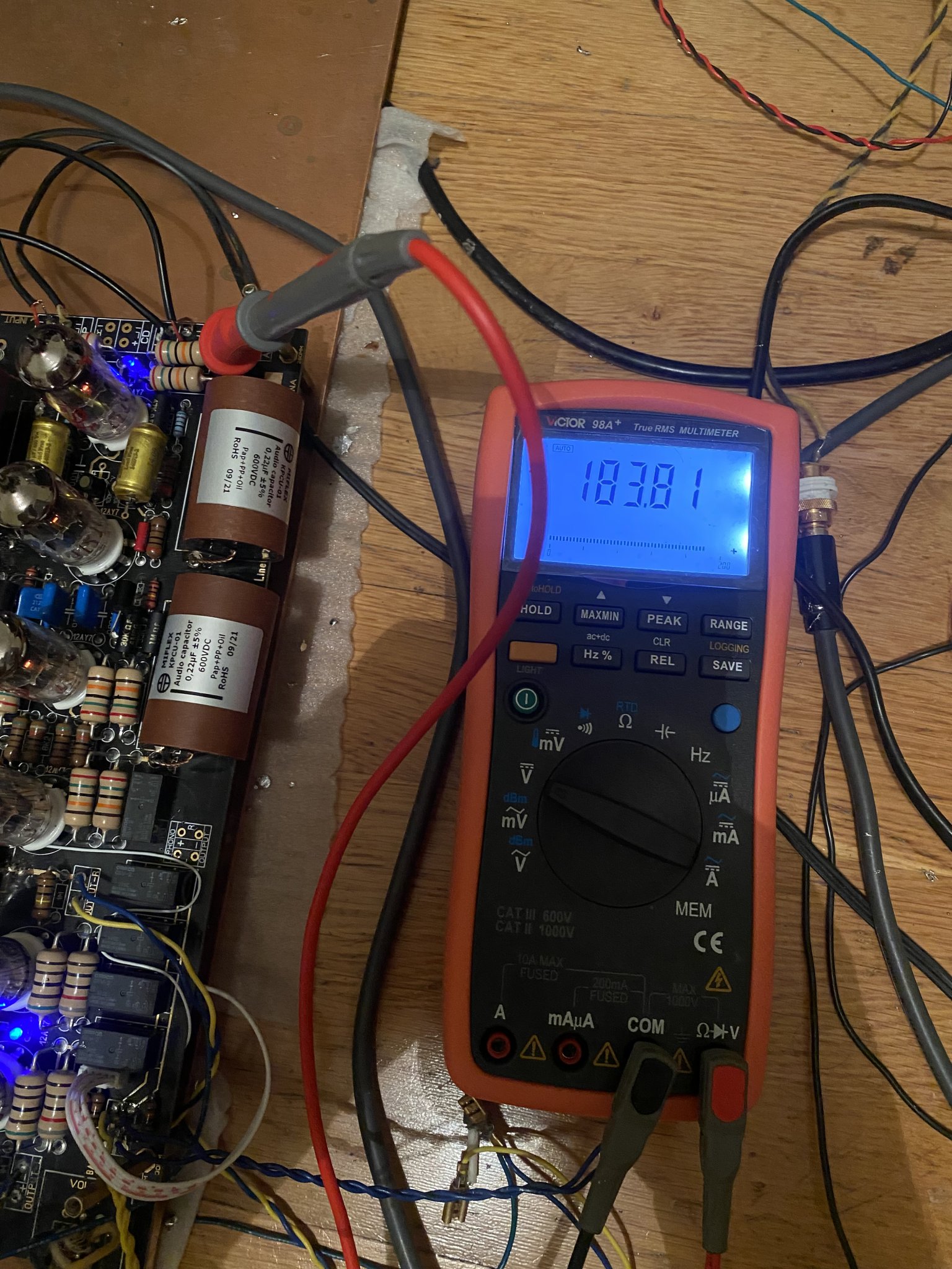

It seems to be motorboating oscillations in a preamp that has a well designed B+ supply and no feedback, which shouldn’t happen. Can you look at the HV supply while the put-put noise is occurring and see if there is a corresponding disturbance on the B+ supply. The other issue could be around the cascode biasing used in the stock circuit. The circuit may be fussy about the tube quality and could possibly oscillate if a tube is not up to scratch. So, I would change out the tube in the cascode stage of the phono anmp and see if it makes any difference. Also make sure you have the correct resistor and capacitor values in the B+ power supply filter and that the DC voltages for each stage are near where they should be. The power supply filtering on the board is a bit convoluted and perhaps you have a wrong resistor value that could be putting a time constant in the power supply that allows it to oscillate. That’s all I can come up with at this point with the info given. Also, if you have changed capacitor values anywhere in the circuit let us know what changes were made.

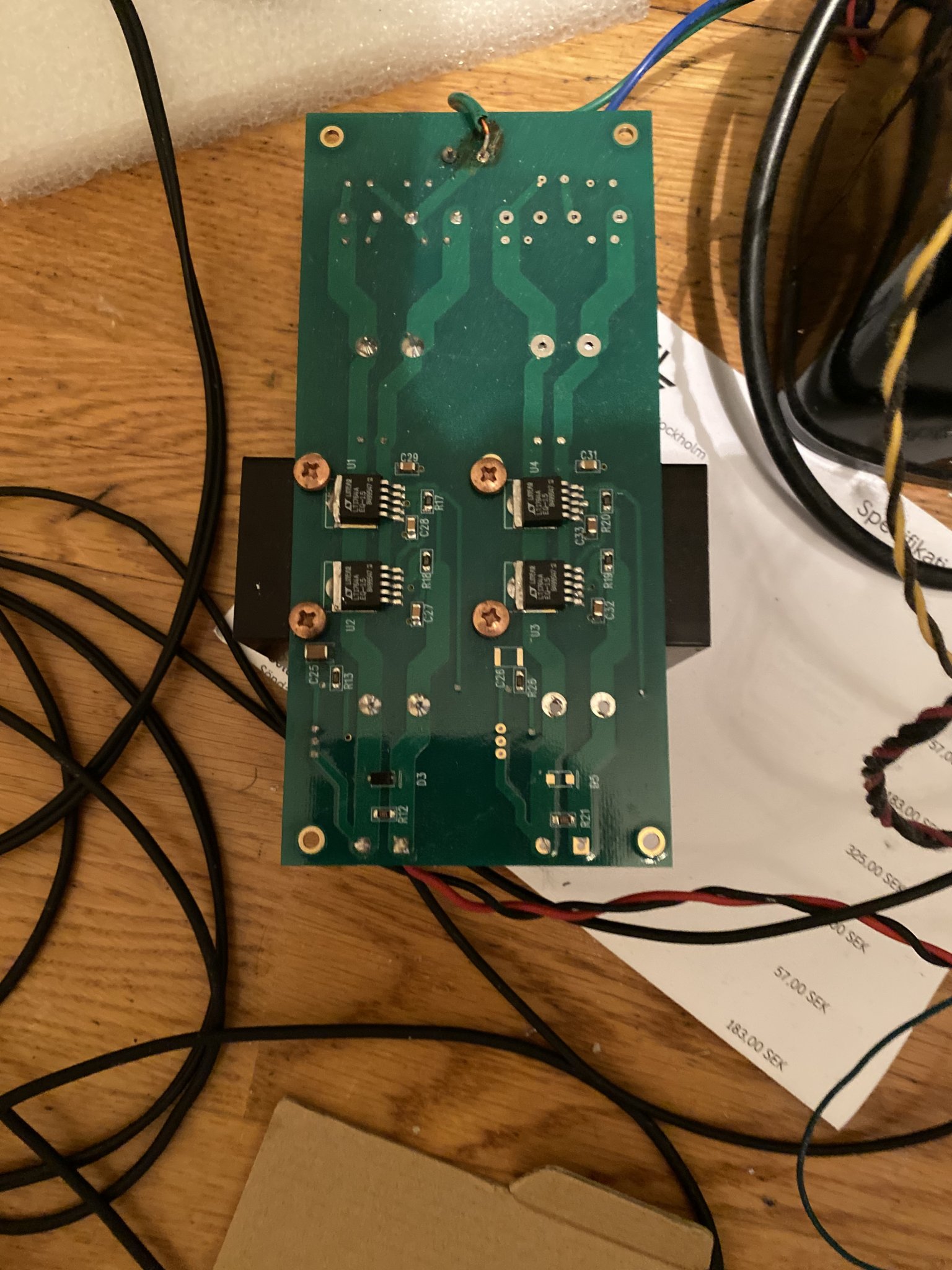

LT1963A which side of the supply you use it? the 12.6V or the 300V? The post above from Bfpca is talking about 300V high voltage rail.
I have noise when I start the m77! after 5/6 minutes the noise disappears! I clean PCB aigen ! but when I use the M77 with my DAC I don't have noise!

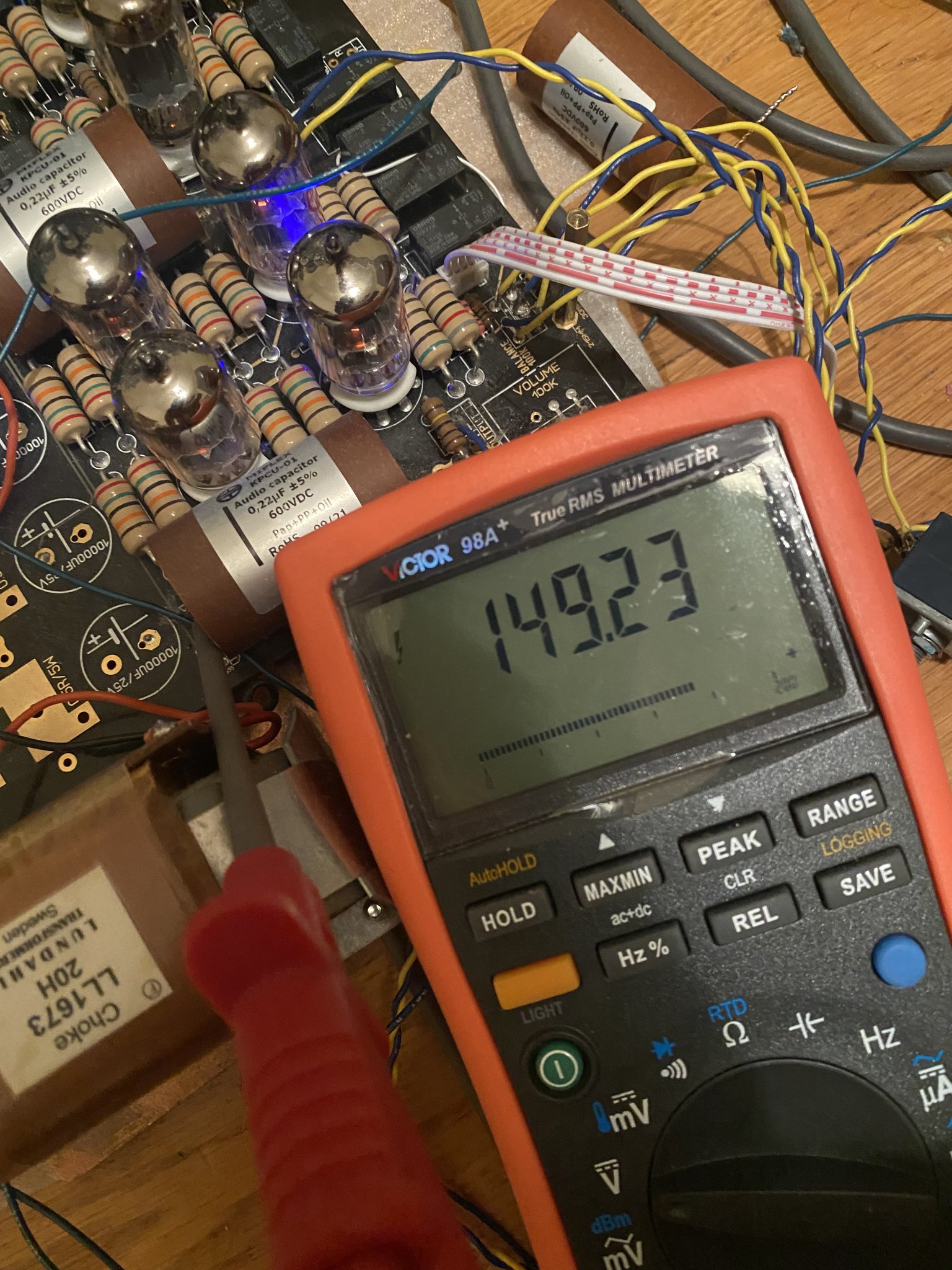

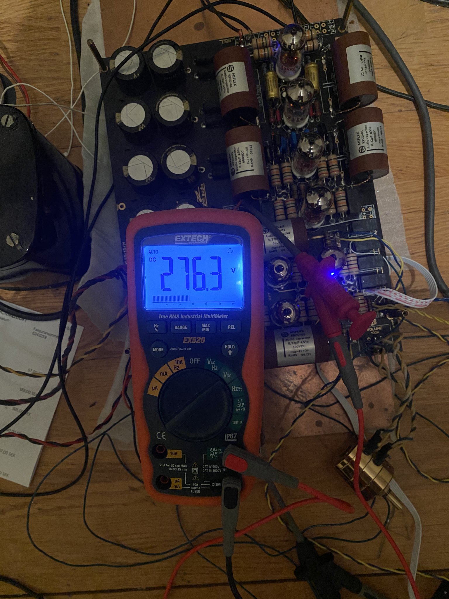

I have 275V on B+
But 185V on CAP !
See photo !
Thanks 🙏🏼

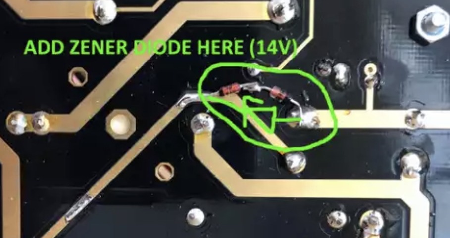

Now my question comes. I am testing the power supply. I modified as advised the 12.6V voltage, I am getting around 14.7V with no load. I forgot to turn the trim pot to max, I might have to replace the Zenner because is reads across of it almost 16V.

I have questions about 12.6v dc filament with one recommend you modify i that witch MJ3001 + zener or use i LT1963A low noise ? with of they have less noise ?Sounds like something needs time to warm up fully, probably one or more of the tubes themselves. If the noise is in only one channel, or one channel is worse than the other, try swapping tubes around to see if the noise follows them.
