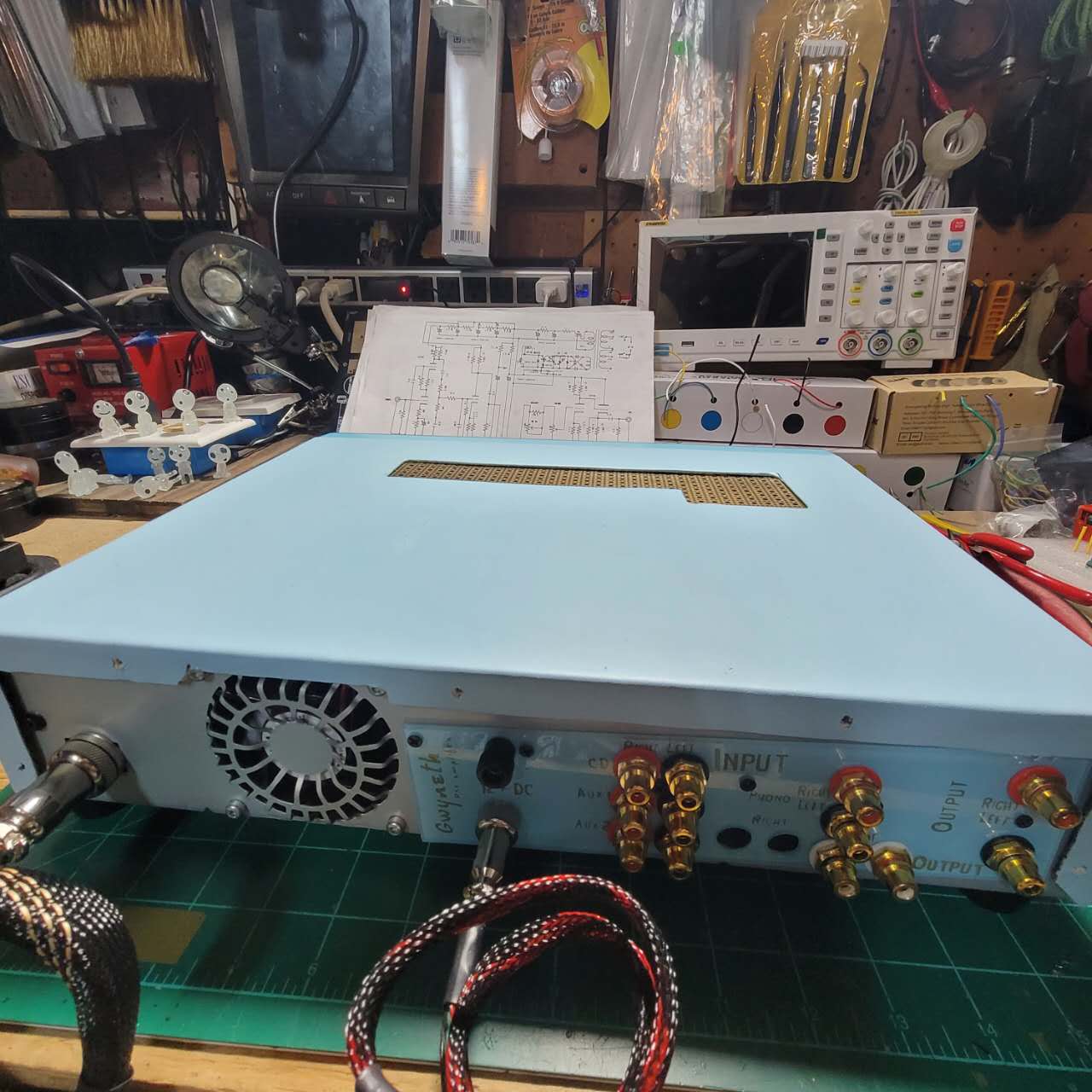

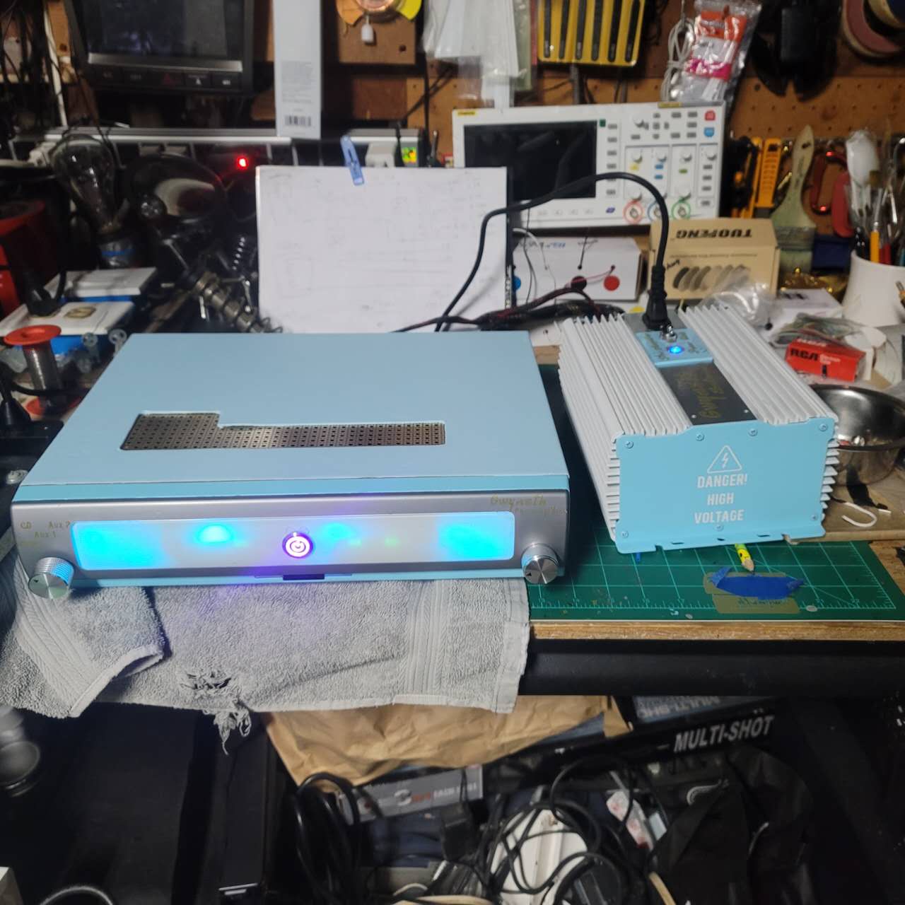

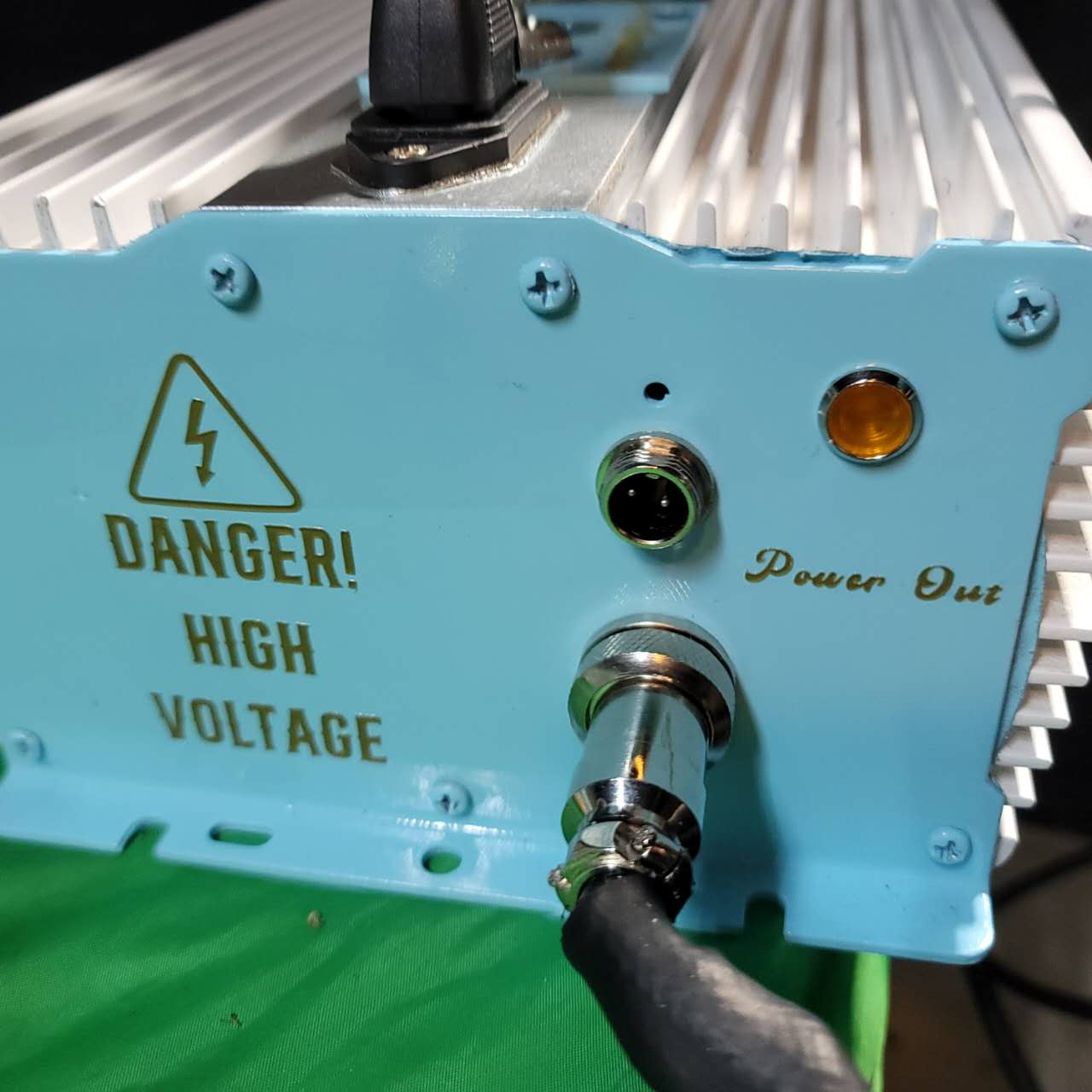

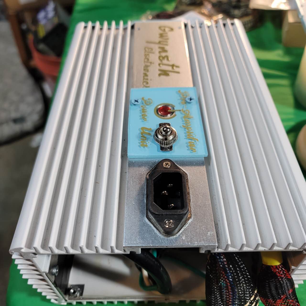

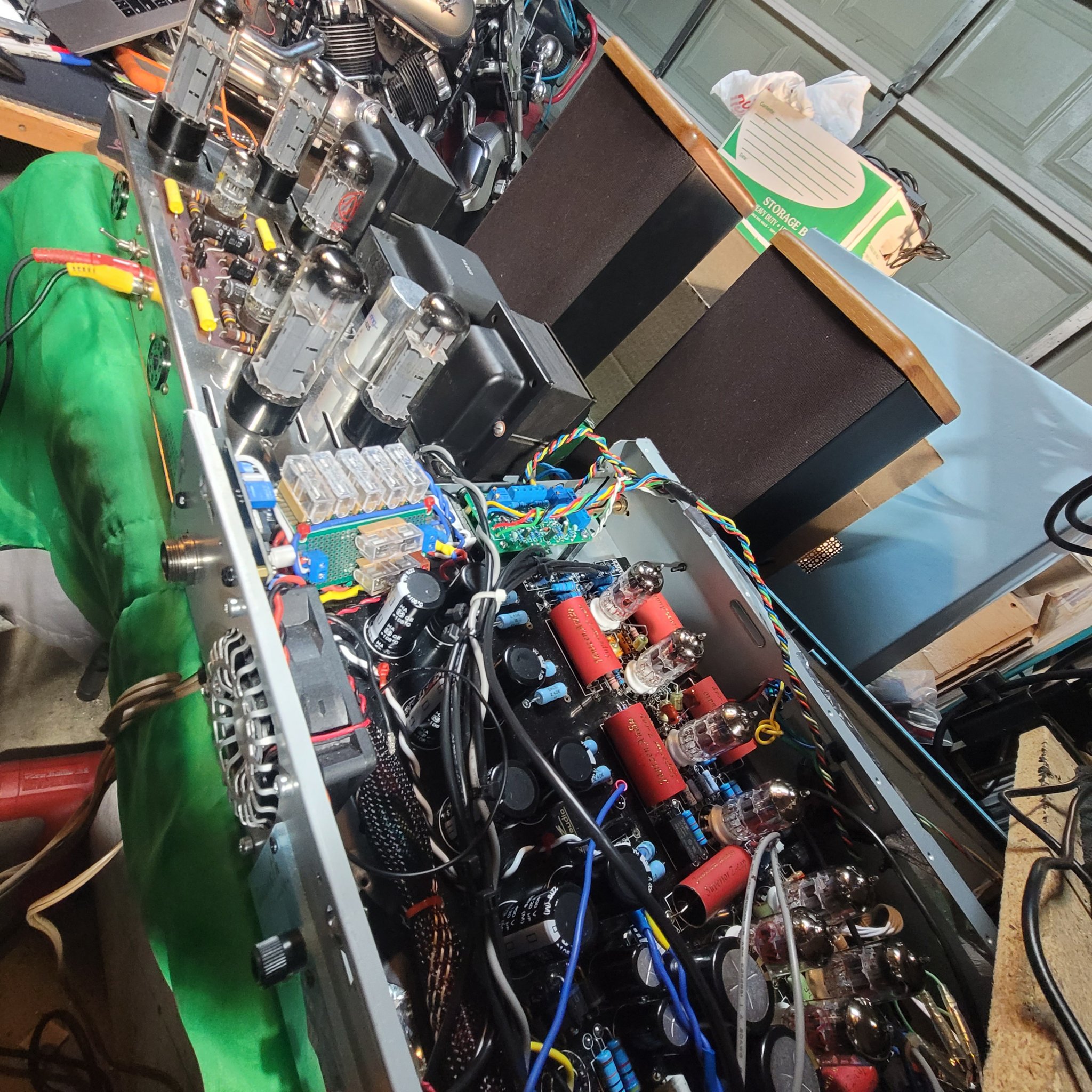

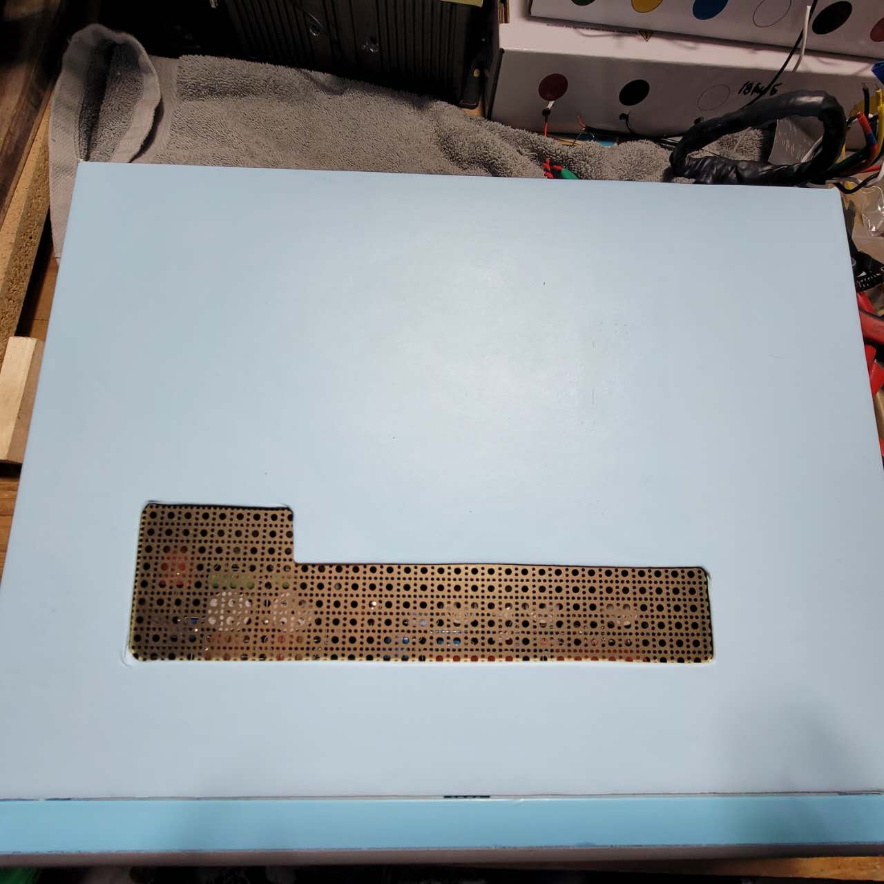

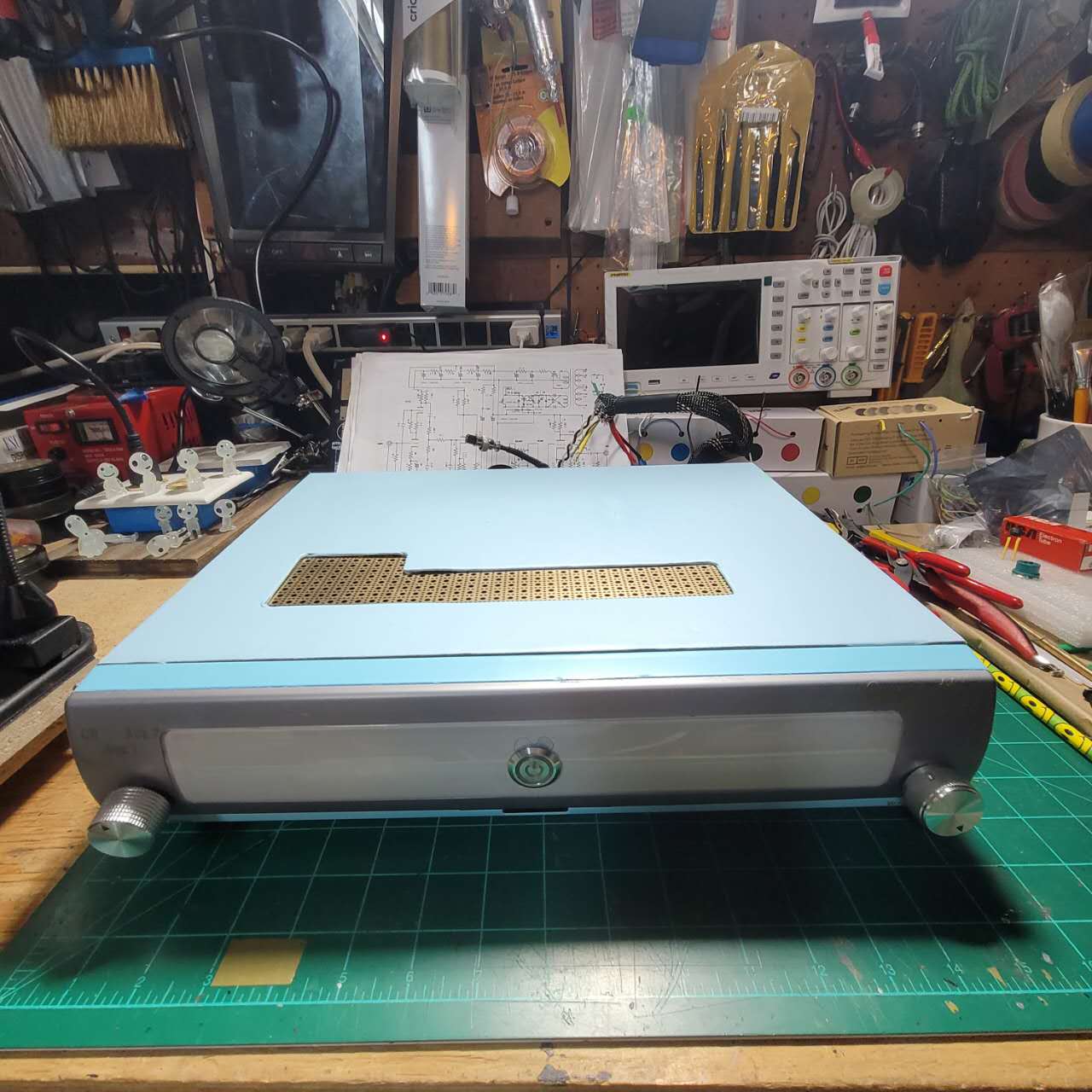

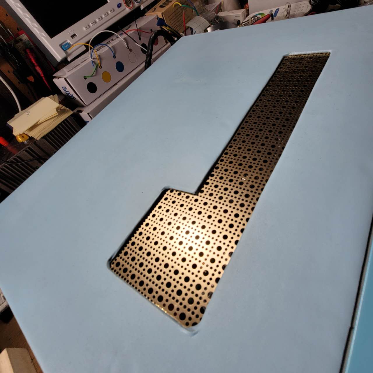

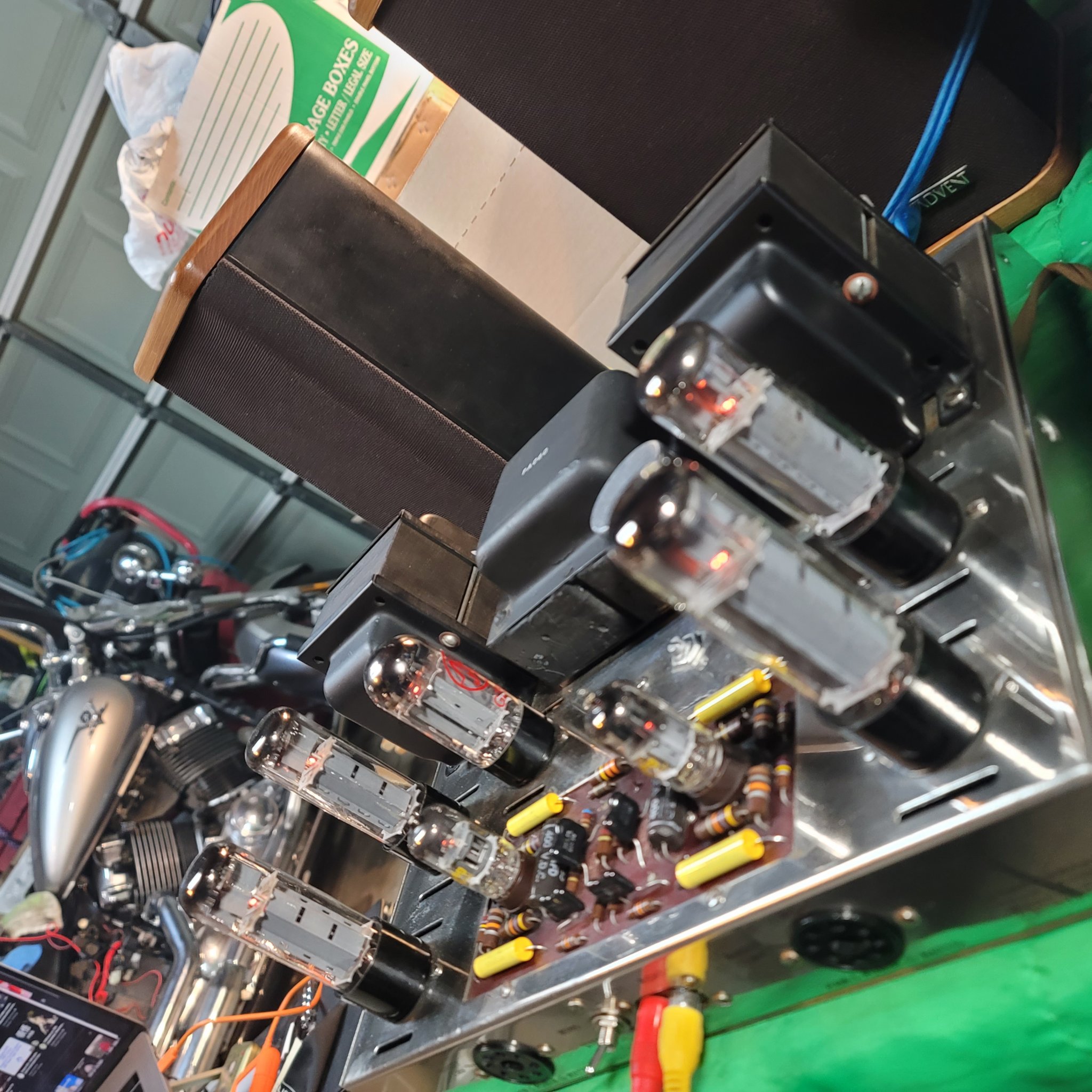

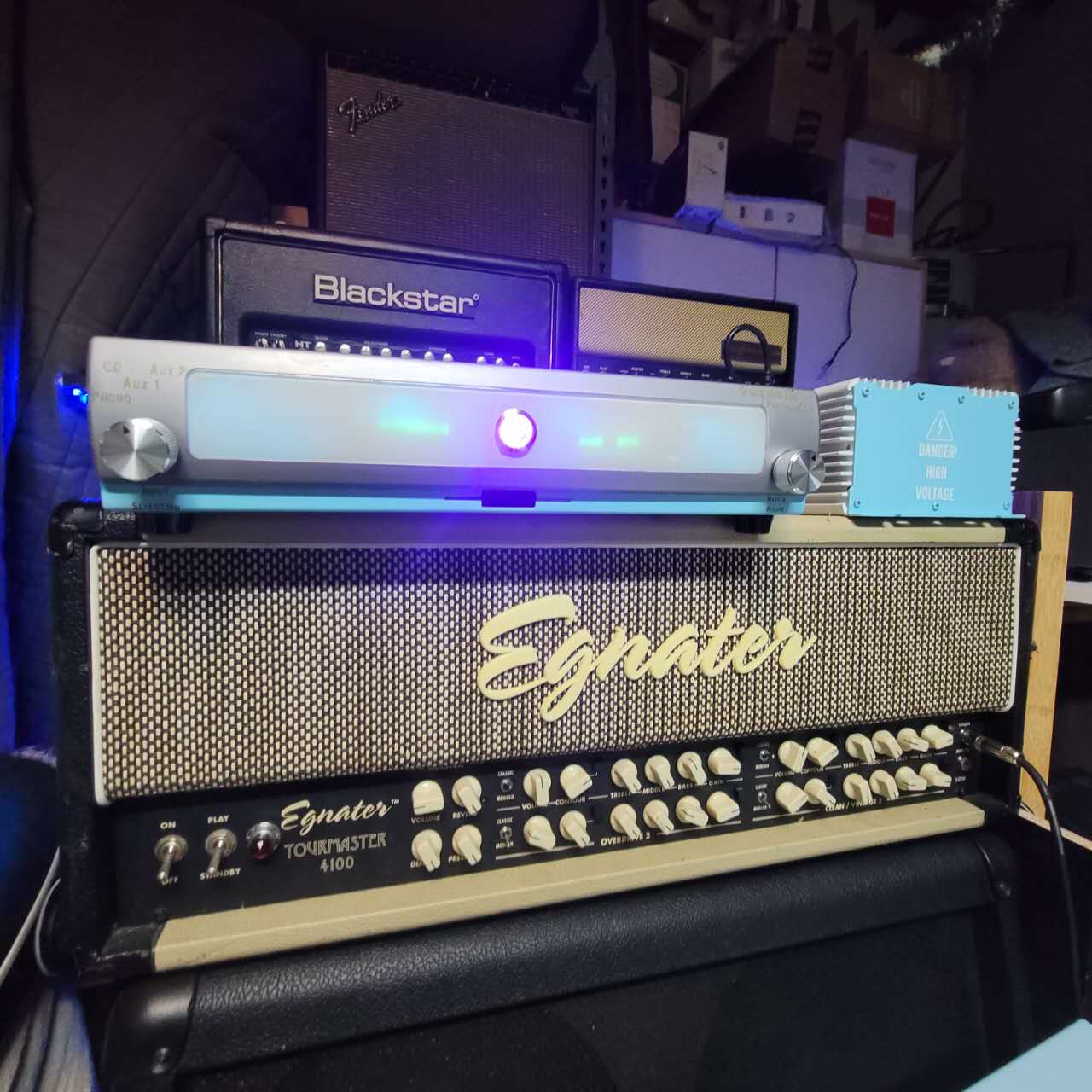

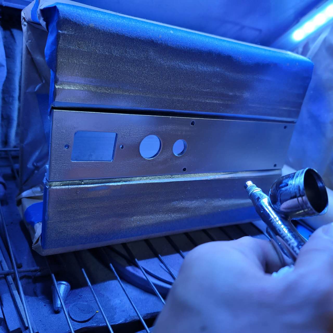

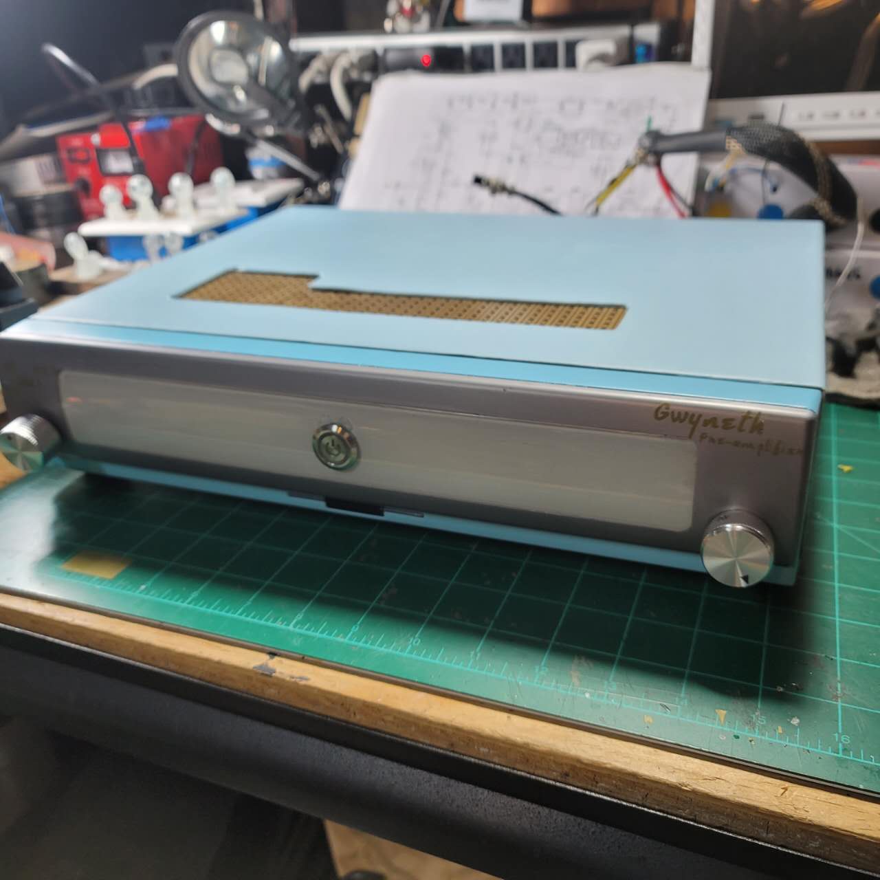

First off, wanted to thank everyone for their contribution to this build. This has greatly helped me understand the schematic and topology of this design. After several months of tinkering and soldering, finally got some time last weekend to button it up together and gave it, its first listening experience. To my ears, they sound amazing! Along with all the phono component adjustments, I also went with hesener's linestage improvements, definitely more pronounced bass and treble with the mids still nice, clear and warm. Here's some images of my final build, having the transformer and choke in a separate unit definitely made it nice and quiet.

Hopefully someone could confirm, was noticing my right channel was experiencing some attenuation (slightly lower in volume compared to left). So I decided to finally gave the balance pot a go and soldered it together. Originally, I assumed this was left and right, but after hearing, noticed it a bass/treble balance. Noticed most just bridged, but maybe just me, I thought this was pretty handy to have.

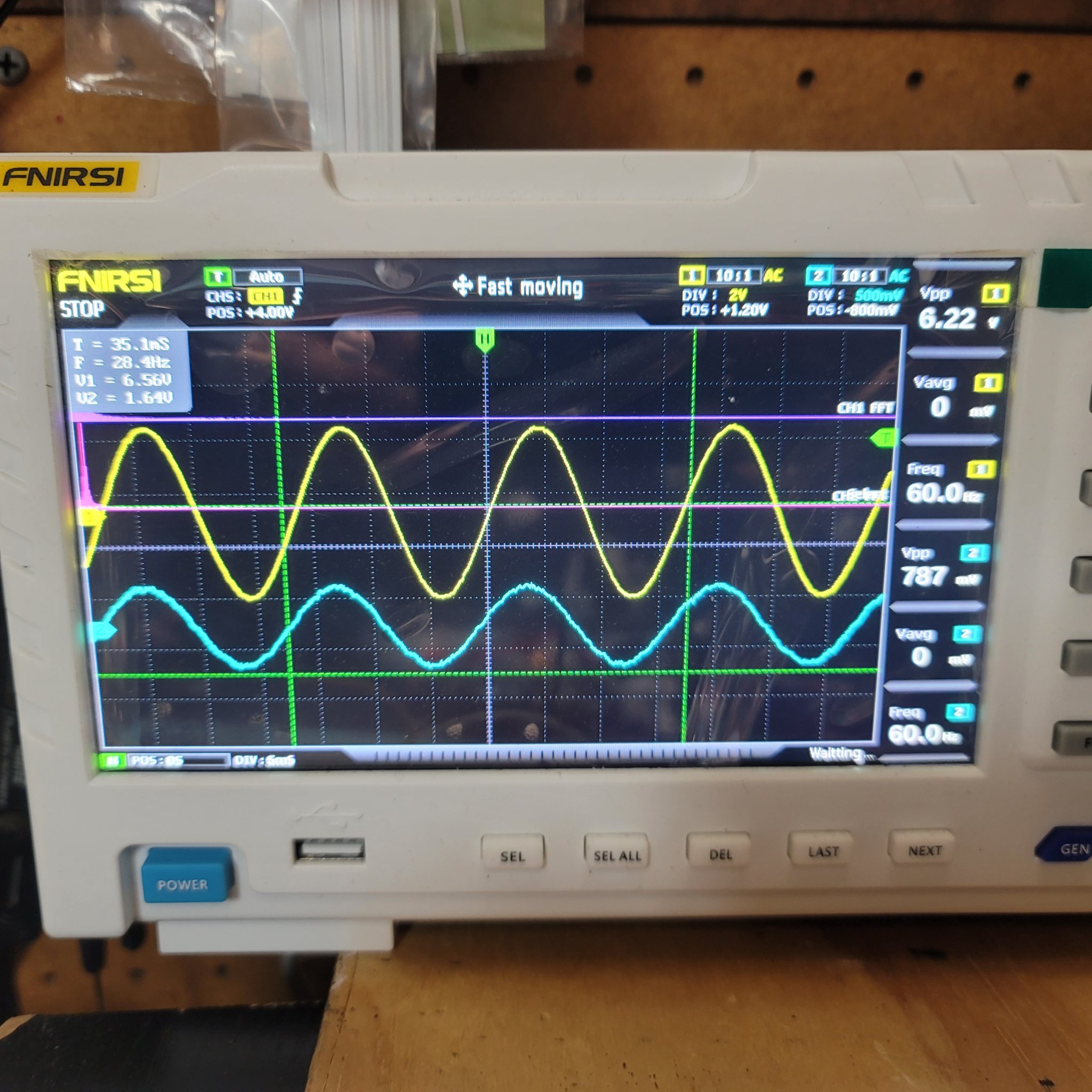

Got a chance to pull it apart this evening and ran the multimeter across the plate reading for the right channel output. Definitely on the lower side at 147v on both pin 1 & 6. The heaters a little higher than I would like at 13.59v. Well time take it apart and dig in and see what's causing the problem. Post back soon on my findings. Premature celebration......😅
Strange. Pretty sure that's not how my balance control works, but I'll check again.Originally, I assumed this was left and right, but after hearing, noticed it a bass/treble balance. Noticed most just bridged, but maybe just me, I thought this was pretty handy to have.
Could be just me, since I'm experiencing a very low volume the right channel. Still have yet to find the cause, threw on the scope just for visuals. Stump, going to call it a night and hopefully have some time this weekend to go through it again and what I've overlooked.
double checked the schematic, my mistake was not a tone control. I suspect it could possibly be my attenuated right channel messing with my ears.Strange. Pretty sure that's not how my balance control works, but I'll check again.
This wonderful rainy morning, finally got the chance to get Dynaco ST70 paired up with the unit for some listening experience. Amazed each time, definitely gave the ST70 more a noticeable low end with the linestage suggestion from hesener. As a complete amateur, my childish description of this would be, "I'm partying with a live band by myself!". It's sounds much more full and with some thump now, something I always felt my ST70 was missing. Although, I have not resolved my channel imbalance, it's not as noticeable when paired with a pa.

When you had a chance to do a proper listening, how was the midrange? At least in my build thats a real highlight!
I have low output level ob both channels. above 0.8V when on Input above 1.5V.Could be just me, since I'm experiencing a very low volume the right channel. Still have yet to find the cause, threw on the scope just for visuals. Stump, going to call it a night and hopefully have some time this weekend to go through it again and what I've overlooked.
Did you ever figure out what was causing it? I was able to resolve mines, I'm guessing a bad or loose connection. I went back in and reflowed solder and did a few stuff and when I powered it back on, both channels seem pretty well balanced now. It wasn't noticeable when I ran it through my push-pull. Now that everything is working, the mids are much more presence with hesner's recommendation. I gave it a listening paired with my Dynaco st-70, with original values components and hesner's for the linestage. To my ears the mid sounds clearer and more noticeable, it also added noticeable lows (that my st-70 was missing). I'm really enjoying it, I have friends over and they are amazed at the new clarity and were expecting that I'd spent another $2k on Hifi equipment. lol
Did you also went the route of 14v diode paired together with a Darlington transistor? I was at the same path, being not so savvy at this. I just went ahead and took measurements of the whole circuit, starting with AC input, then measured each tube pins, then sweared a few times. My problem was on the linestage, I had different reading from left vs right. everything before linestage were pretty spot-on.
hesner's power section of the mod would definitely help with stabilizing heater supply, perhaps check the heaters first? I hope you get it working, I'm really enjoying the new listening experience, even as a stand-alone unit without the PA, it still sounds great!
