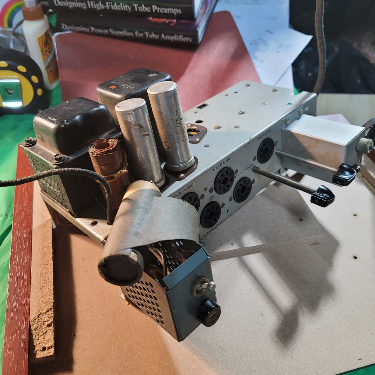

None of my amplifiers use PCBs.
The KT77 amplifier I built was on a chassis that I use to try out various amplifier circuits.
I built many stereo SE on that chassis with various DHT, and a pentode.
Now I only build mono-block push pull amps on that chassis.
pentode and beam power. I have used in beam power mode, Ultra Linear mode, and Triode Wired mode.
And my latest amplifier circuit is on another chassis, it is a balanced/differential push pull mono-block.
My only differential signal source is a Marantz CD player with XLR outputs.

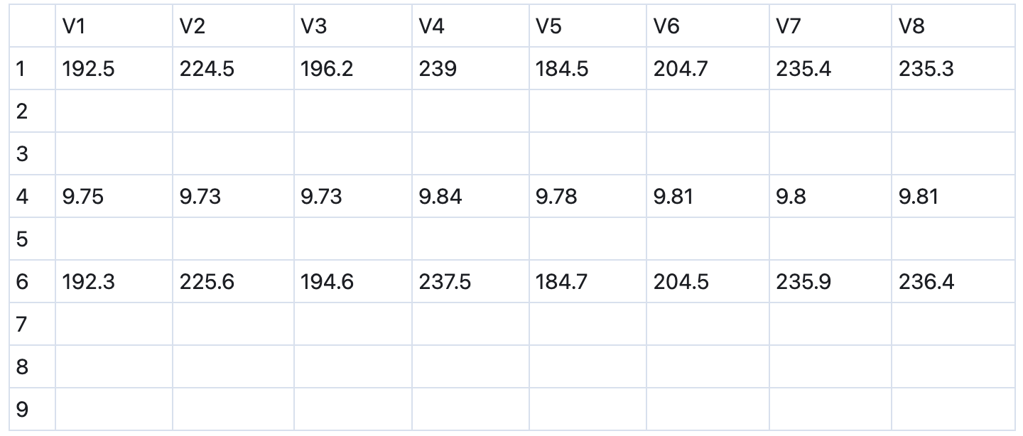

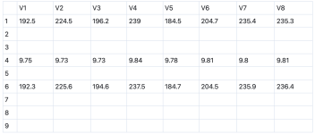

So, in my case the supply voltages are 192V ... 197V, and the Anode voltage of,the phono stage is 144V, the anode voltages of the following stages are 112V. Hope that helps!

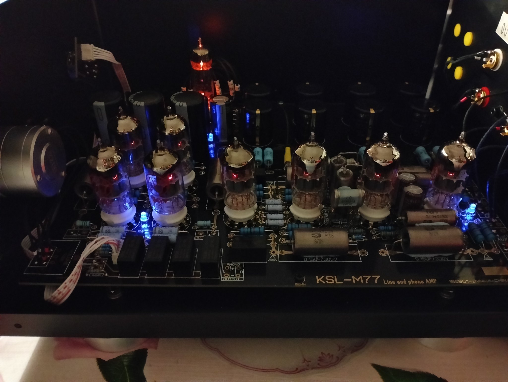

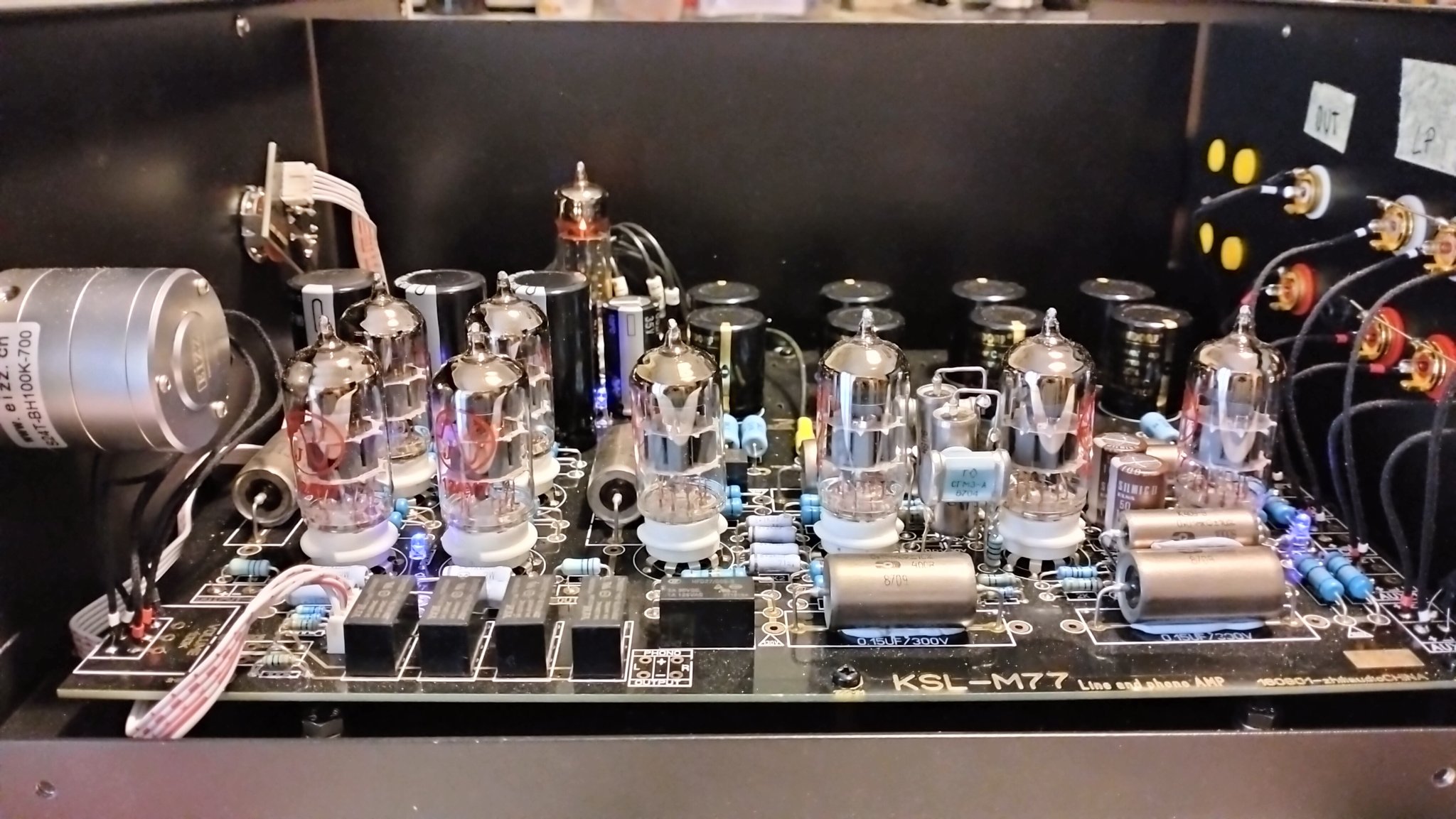

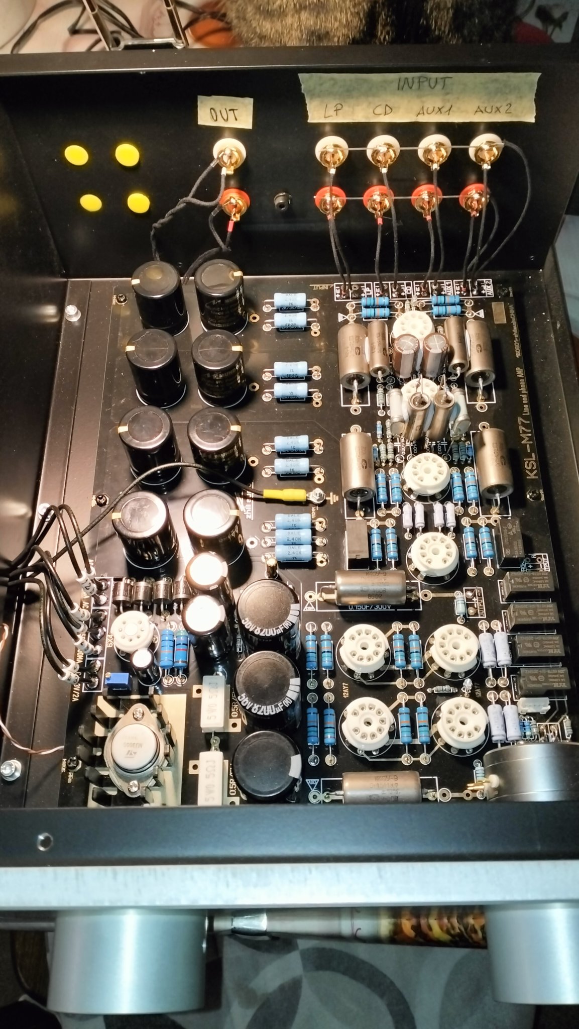

Hi all, I finished my pre too.
I made the measurements at the 12.6v test point on the board and it gives me 11v.
I tried to adjust with the trimmer but nothing happens.

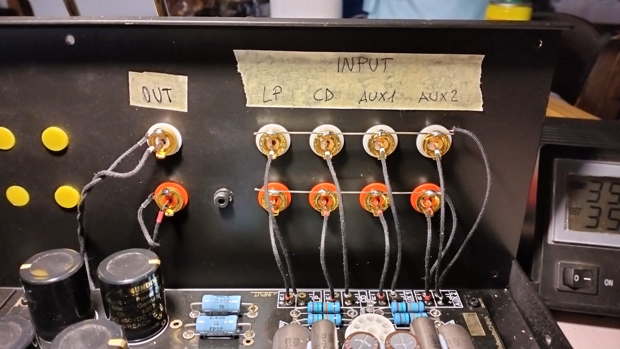

Hi Derek, I checked the RCA inputs with the tester, it gives me continuity on the connectors except phono, why?
from your picture, it doesnt seem the grounds are connected.... some of them are but some do not look like. Only "AUX 2" seems to be connected correctly. Please confirm you have mounted the RCA sockets isolated from the back panel, with the plastic washers.
All RCA grounds need to be connected, ideally from the socket to the PCB signal ground with a good connection. Otherwise the input signal cannot flow...
So the other sockets should all measure "open".
OK, checked another picture, seems you have connected with a wire at socket level. I would still recommend for the LP sockets to connect the ground directly to the PCB, since the current setup is creating a big ground loop, with possible crosscoupling of signals from the other sources.
Still not clear what is causing your measurement results. Did you insert the relays correctly?
