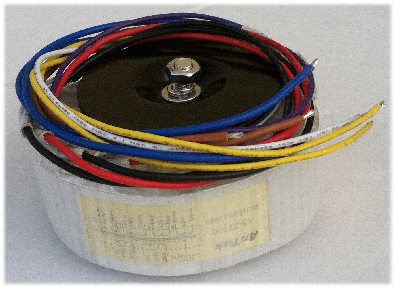

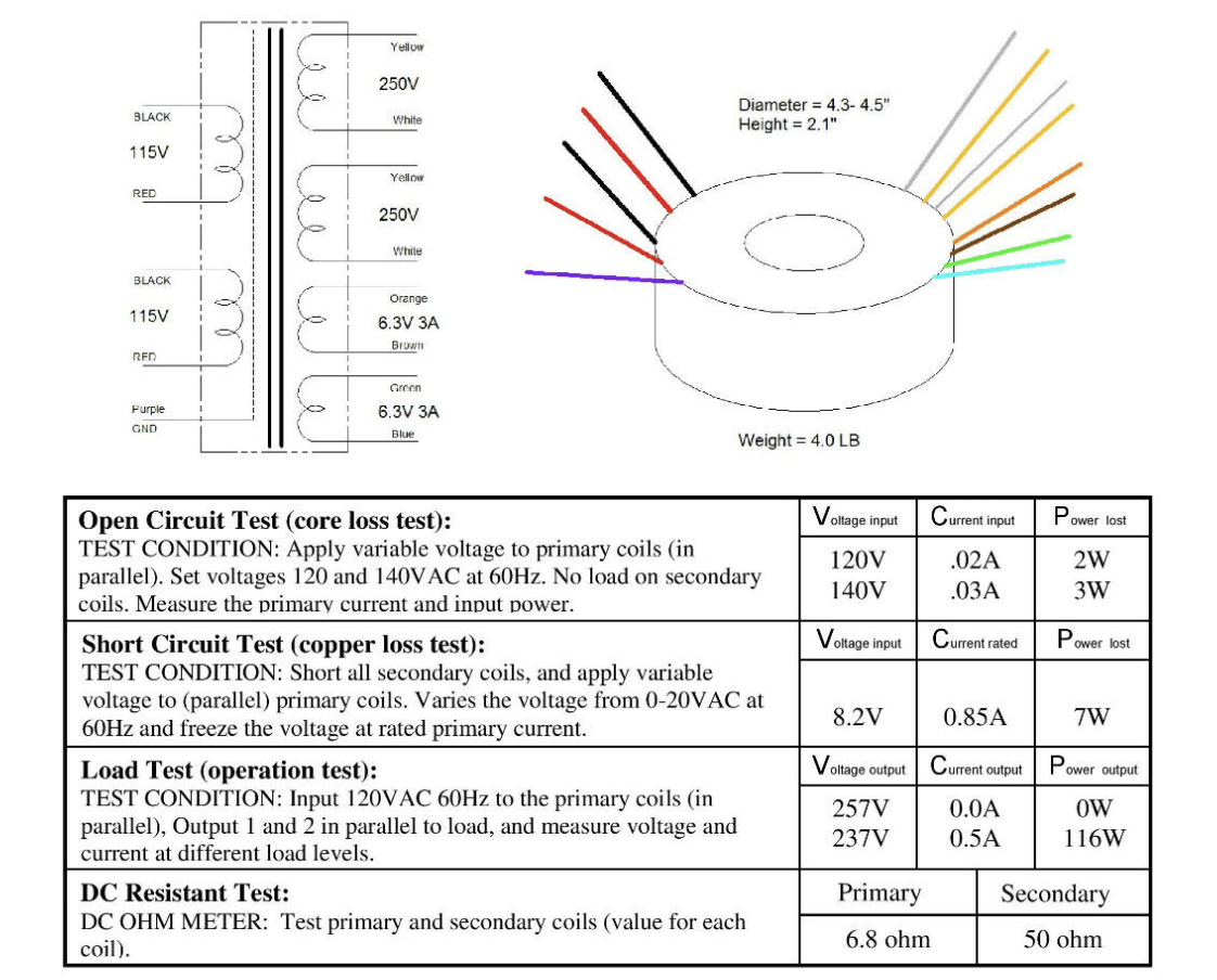

Seeking advice from the pro and vet builders on PT. Technically, could I make this work? Since it provides 2 x 6.3, I could combine for a 12.6 voltage, for the heaters? This was slightly cheaper and quicker shipping. Apologize for the bombardment of questions. Thanks in advance.
is it not 6.3AC? It is a toroidal transformer. Maybe I need more reading......I don't think it will work because the rectifier tube needs 6.3 AC.
Joined 2009
This issue to be careful of is the heater on the recitifer may not be happy sharing the heater supply with the other tubes where the heater supplies should be elevated to around +70V to +80V to suit the circuit. Most rectifiers have heaters that need to be elevated to B+ and those that have data sheets saying they can be run without elevation may not tell you how long the tubes will last when you don't, due to the voltage stress across the heater insulation and heat-cooling cycles over long-term use.
So if you plan to combine the two 6.3Vac windings for 12.6Vac you'll need to be careful about the rectifier specifications. Also, a rectifier failure can result in a short to the heater so that now all your heaters, if on a common supply, are sitting at high AC voltage from the B+ transformer winding which will not be at all good for the rest of the tubes. If you can keep a dedicated winding just for the rectifier, that is usually preferred.
Anyhow, the 6X4 and it's brothers (e.g. EZ90) are specified to be suitable to not elevating the heater voltage, it's an indirectly heated rectifier with insulation designed to withstand more than the B+ voltage in this Kondo clone. If it's a good quality specimen, perhaps protected by series SS diodes, the rectifier may be just fine - I have no experience to draw from on that.
Personally I think it'll work fine, but I would be inclined to ditch the tube rectifier and run some diodes instead 🙂

Maybe I don't remember correctly, but I think you need both 6.3V and 12.6V?is it not 6.3AC? It is a toroidal transformer. Maybe I need more reading......
Great incite, that's something I did not consider, "the shared winding". I may just wire up an independent 12v transformer supply or go with the SS route, as suggested by a few. Any issues if I run a Dickson charge pump circuit for the other 6.3v winding, and double it up to 12.6v? Really appreciate all the knowledge everyone has shared on this, if it was not for the forum, this would have probably sat on my test bench for a very long time.This issue to be careful of is the heater on the recitifer may not be happy sharing the heater supply with the other tubes where the heater supplies should be elevated to around +70V to +80V to suit the circuit. Most rectifiers have heaters that need to be elevated to B+ and those that have data sheets saying they can be run without elevation may not tell you how long the tubes will last when you don't, due to the voltage stress across the heater insulation and heat-cooling cycles over long-term use.
Joined 2009
a voltage doubler is fine if you keep within the power rating of the winding etc. etc.
the HV rectifier tube sits at high potential compared to the rest. It will need 6.3V, supplied by an extra winding in most builds, while the audio tubes need 12.6V , sitting at a different potential. For this reason, and also to avoid noise coupling, I think its best to have 3x6.3V or 1x6.3V plus 1x12.6V windings. Or use a separate transformer (if you have the space).
