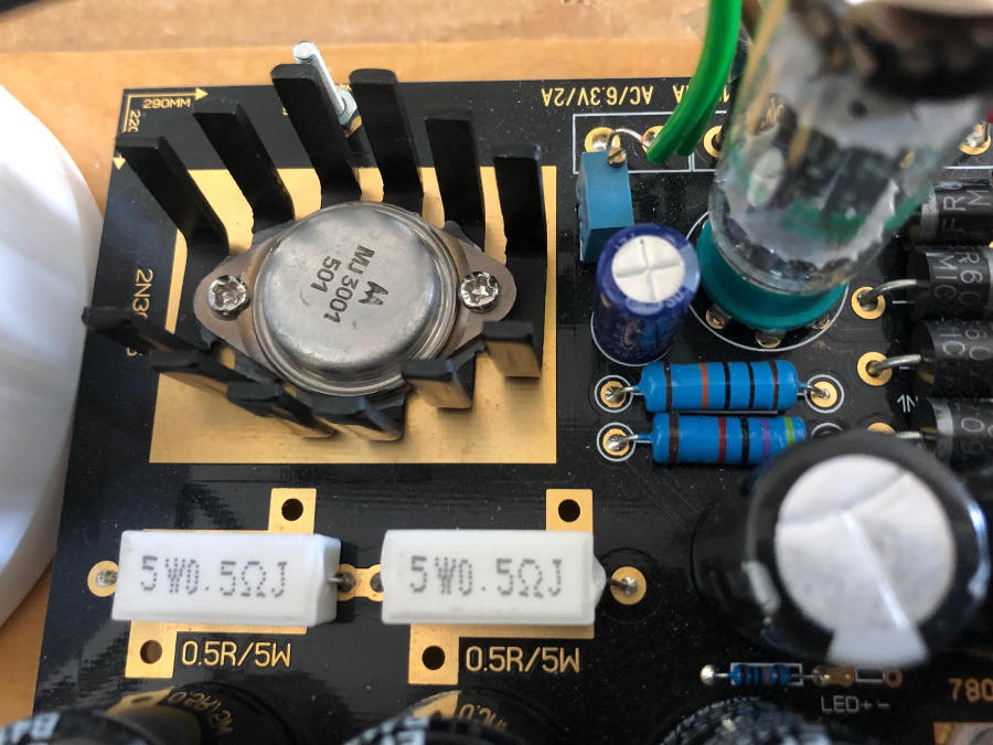

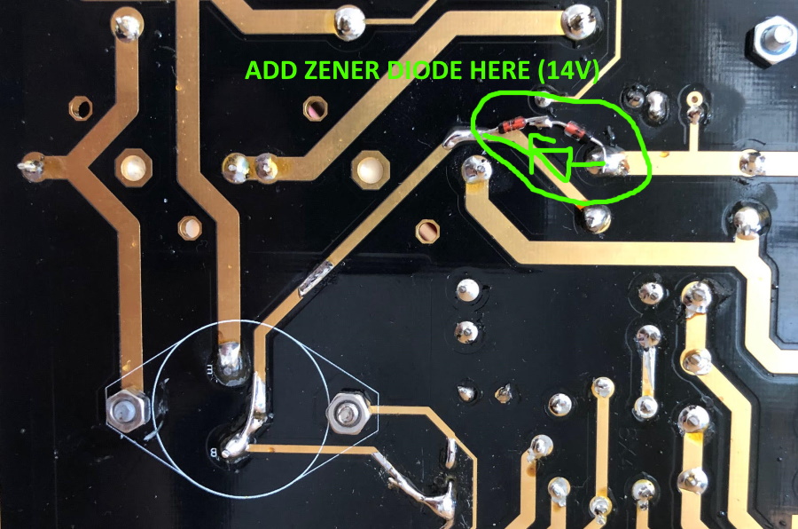

M77 heater mod simplified
Another thought this morning under the shower - what if that scrap box had an old, unused darlington transistor? So I went and checked..... And yes, there was an old, unloved MJ3001 with cables from some previous experiment...... In it went.....
Check out the pictures for the mod, essentially all you have to do is
- Replace the 2N3055 with a good, sturdy darlington (MJ3000 or MJ3001 will do fine), make sure to apply thermal grease as it will get a little hotter than before
- Add a 14V zener diode on the bottom side, as indicated
Tried it just now, works like a charm 😀

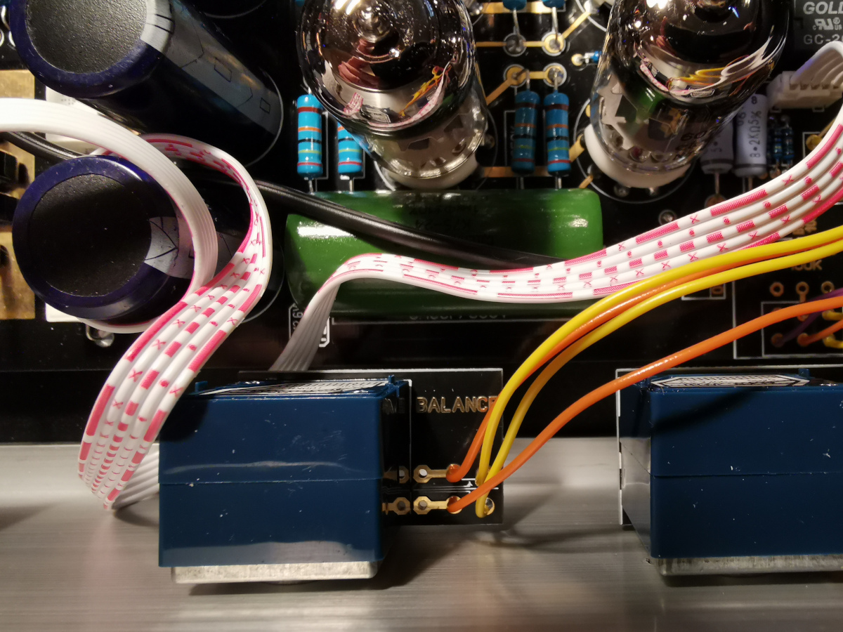

Hi everyone,
I turned on the M77 for the first time today. No smoke, and it seems to work! Two problems:
Thanks,
Trond

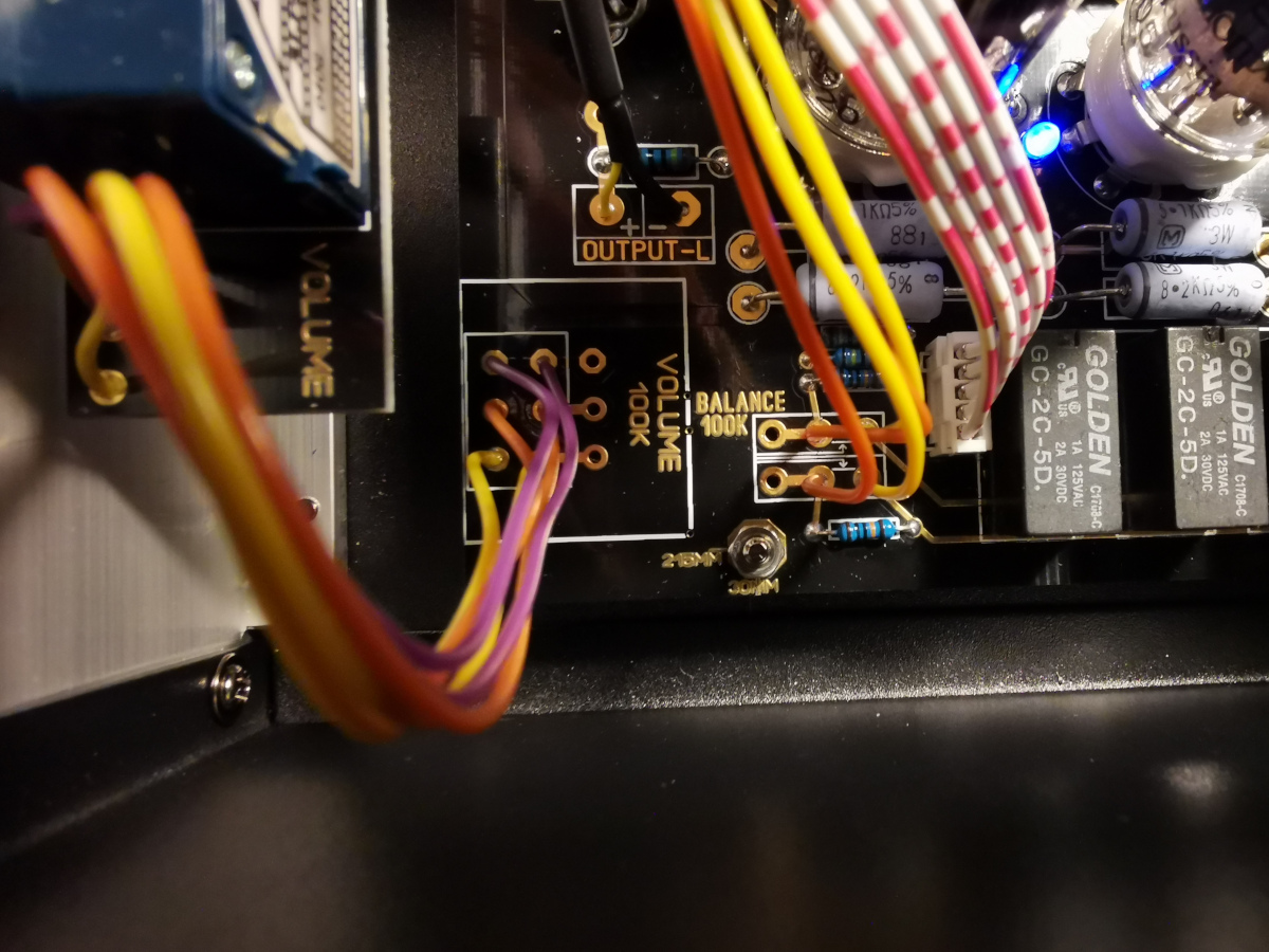

- The balance control doesn't work as expected, as nothing much happens when I turn it. I assume I have wired it wrong. See photos. I need advise about how to correctly wire this.
- The is quite a loud hiss. Ground loop perhaps?
Thanks,
Trond

Thanks! Problem 1. is just that the pcb is intended for an antilog potentiometer, I think.
Hum is probably the right word. It's silent when the volume is at the lowest, and is increasing when i turn the volume up. The hum also varies slightly when I touch the chassis and the tubes. I'll experiment a little and report back!
Antilog...... It´s called linear as in contrast to logarithmic.
Volume is (mostly) always log.
Balance is always linear.
You are of course right! Learning something new every day. I was a bit quick and thought antilog meant something else. Electronics isn't exactly my field of expertise.
But I actually have a linear pot in there now, and it doesn't work. It only changes the volume a tiny bit equally on both channels. And I don't understand how it's supposed to work the way it is wired.
I hope someone has connected a balance potentiometer to this board. Very interested in knowing what they did to make it work.
I bridged mine, sorry 😀
